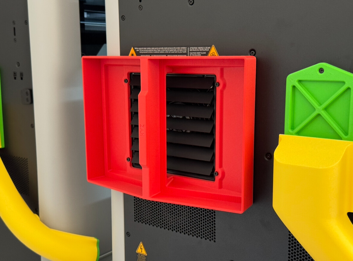

H2D Air Filtration Upgrade
Okay cool! Seems like Bambu could use a little bit of equipment communication updating lol.

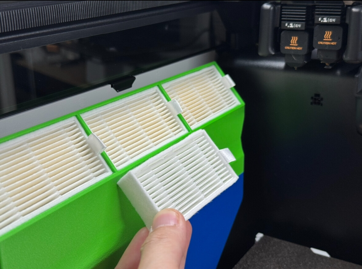

Ok here it is - a double filter version - and with NO annoying Allen key time! Filters are angled in case you push it up against the wall. Just need the filters to arrive…
This is another way to tell it’s working - look at the colour of the filters compared to a new one… gross. This is after about 1kg of abs-gf

Well, it’s definitely working! Haha. I don’t print abs, so I wonder if I’ll see anything like this from nylon. I guess we’ll find out.
I wonder how bad your oem filter is looking lol. I’m sure that one has seen much more than 1kg by now.
Haha yeah, the carbon is prob all clogged up already. Nylon apparently has some nasty stuff too, just not as smelly

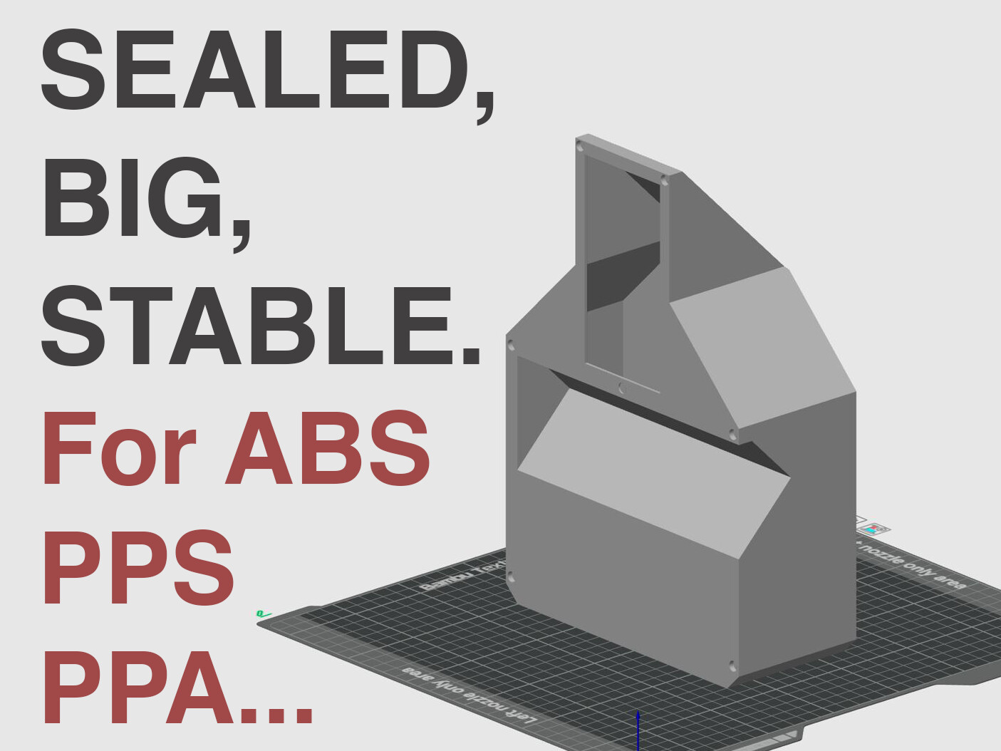

wanna try a sealed poop box? I have a design here:
I can also share the f3d file if you need to adjust it yourself. in my current design you might want to change a magnet hole into a pin by adding a part into the model (you can also do that via slicer easily though).
You might want to add a 6mmx1.5mm round pin here… to avoid adding another magnet :slight_smile:
