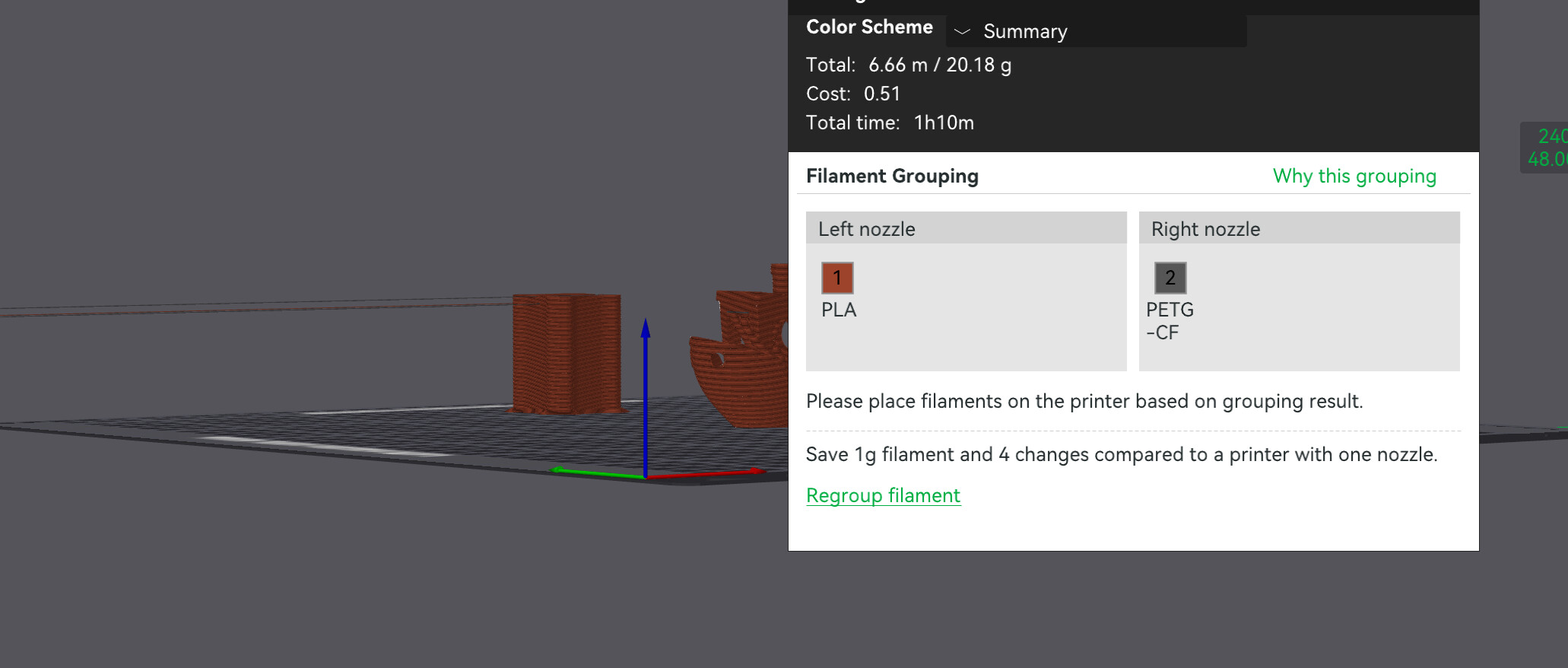

PrimeTower_Bug.3mf (9.0 MB)
The last plate has this hilarious bug
this is how to trigger this bug:
create many plates
add a benchy at the last plate
hhahahahahaha
PSA: THIS AFFECTS ALL SUPPORT INTERFACE MATERIALS ON H2D, I CAN RECREATE THE PROBLEM ON Support for PLA/PETG, ABS, PA, and even PLA+PETG
As long as you’re using H2D, with Support Interface Material, and your plate is not on the leftest plate, you would have this issue!

I just sliced it with an H2C and it really only seems to happen with an H2D. With the H2C the Slice result looks fine.
