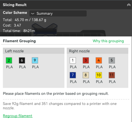

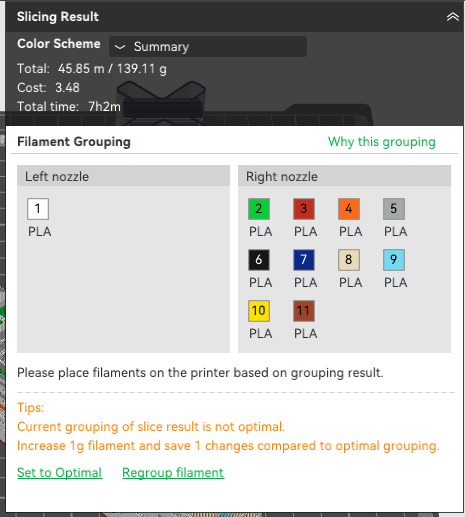

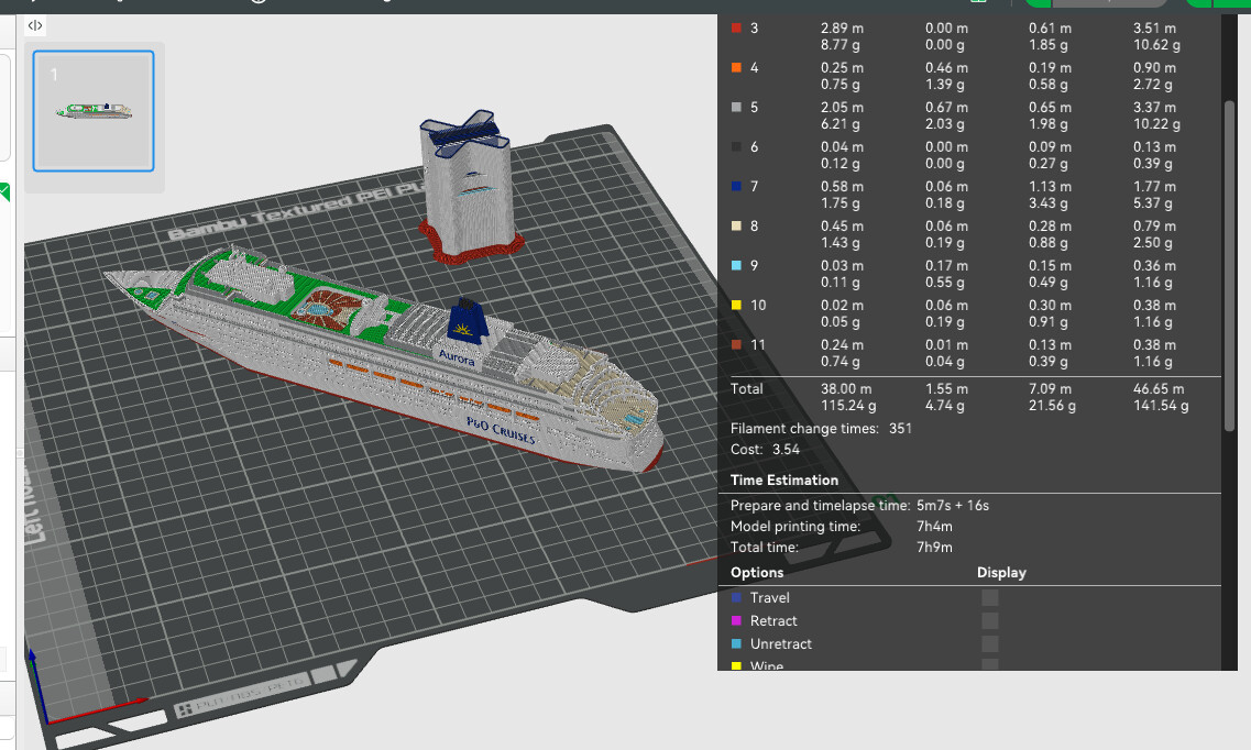

I am only a week into my H2D experience, which is mostly completely positive.
One of the few concerns I have got is about the filament placement recommendations.
I think the logic should be changed slightly to only make recommendations for moving filaments between AMS’s if it has a reasonable benefit.
My latest print for example first recommended I swap every roll between two AMS’s - so that they were exactly the same - just in opposite AMS’s.
Then later after some model refinements I was recommended to make a few filament movements - but tried to see what the impact of using connivence rather than optimal was - and it was only a saving of 0.2g of waste, no time saving and actually 1 more filament change.
So I think maybe there should be a 1 or 2g waste allowance before it recommends you swap rolls around.
Also because my Mac is in a different room to the printer it is a little bit inconvenient trying to remember quite a few AMS filament swaps - which will get worse once I add 2 more AMS’s - so a way of seeing the recommendations on the printer display would be handy too.
Also having Non BL filaments is a bit more awkward too - due to having to tell the printer what changes you have made.
Example - recommendation
Convenience - 0.2g more, with 1 less change

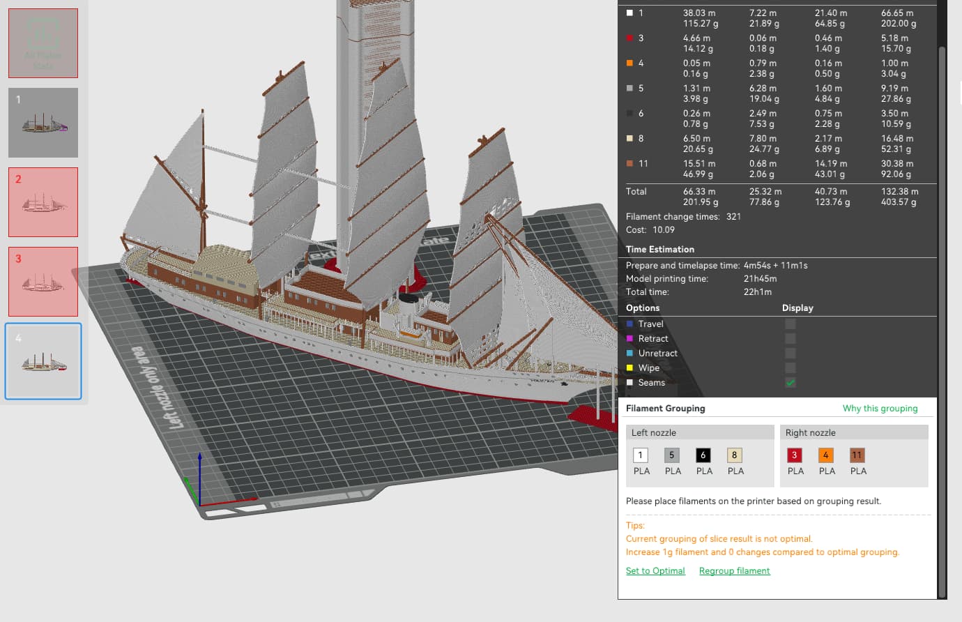

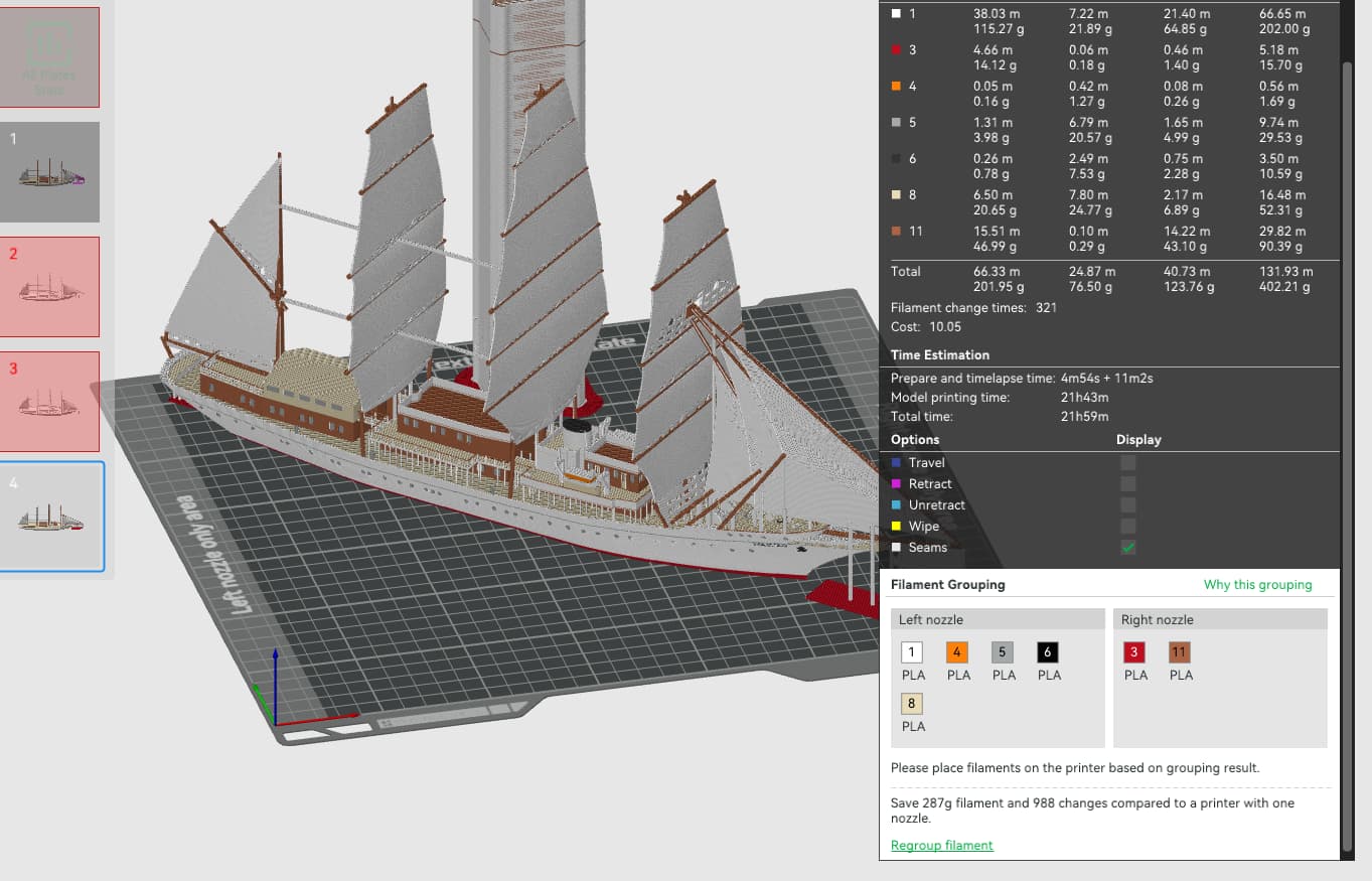

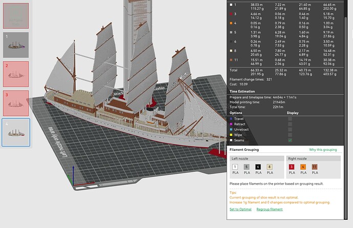

Another example of Non Optimal Optimisation on H2D - with a 7 colour print.
BS recommendation - 5 filament on one Nozzle and 2 on the other - so need to connect a 3rd AMS. 22hrs print, 402g, 321 changes.
First attempt at manual optimisation - moving orange over to 2nd AMS - reducing the need for 3 AMS’s. 1g more filament and printing about 2mins longer.
2nd attempt at manual optimisation - move black over too. No of changes saved 10, time saving 20 minutes, total filament saving about 5g. This is the one I am going to go for.

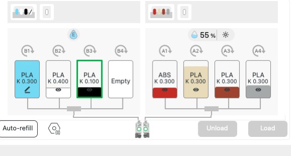

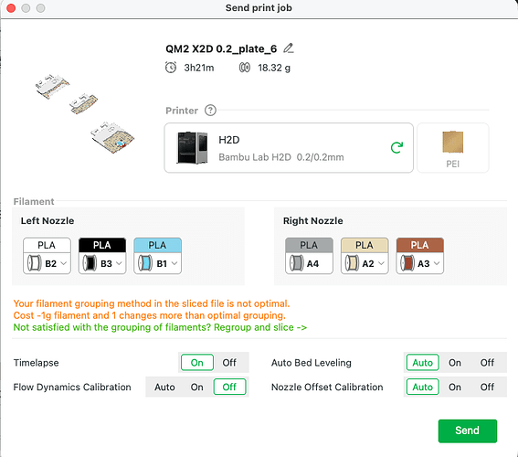

Another example of “room for improvement” with the H2D filament placement recommendations.
My printer is currently setup as follow:

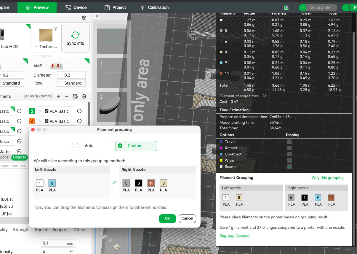

BS recommended the following placements (right hand side)
So swapping blue, black and light brown around between AMSs.
Total time 3h24m, total filament 18.91g

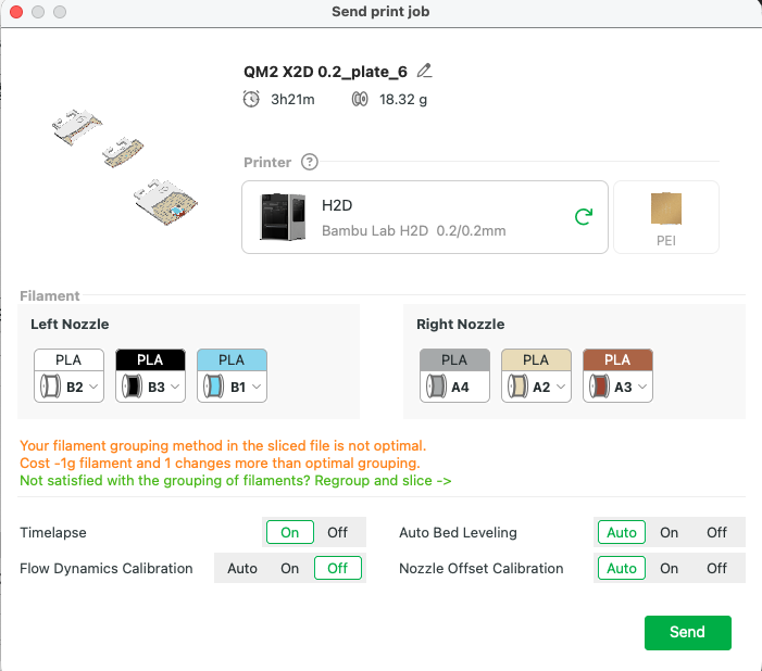

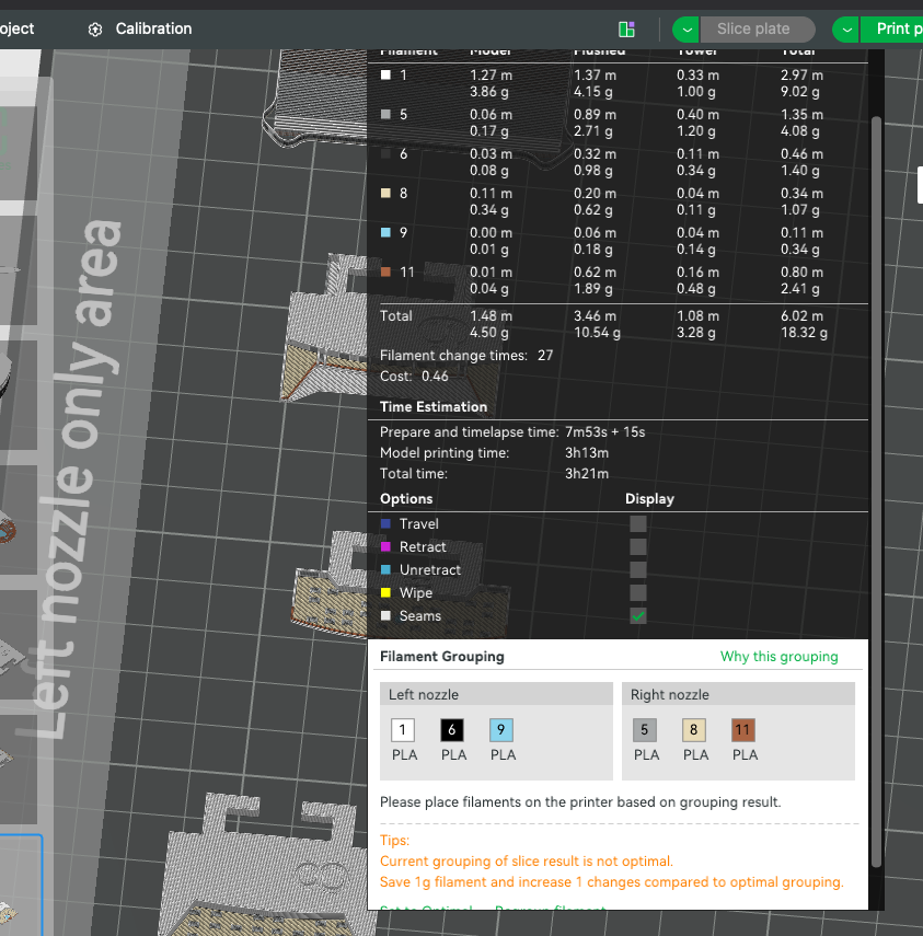

When I said no - I want to leave the filaments where they are I get this
Then this
So ignoring BS’s recommendation and just leaving filaments where they are is saving me the effort of swapping the filaments around and doing K value stuff again, plus 3 mins print time, plus about 0.5g of filament.
Interesting though the number of filament changes is one more on the quicker print.
