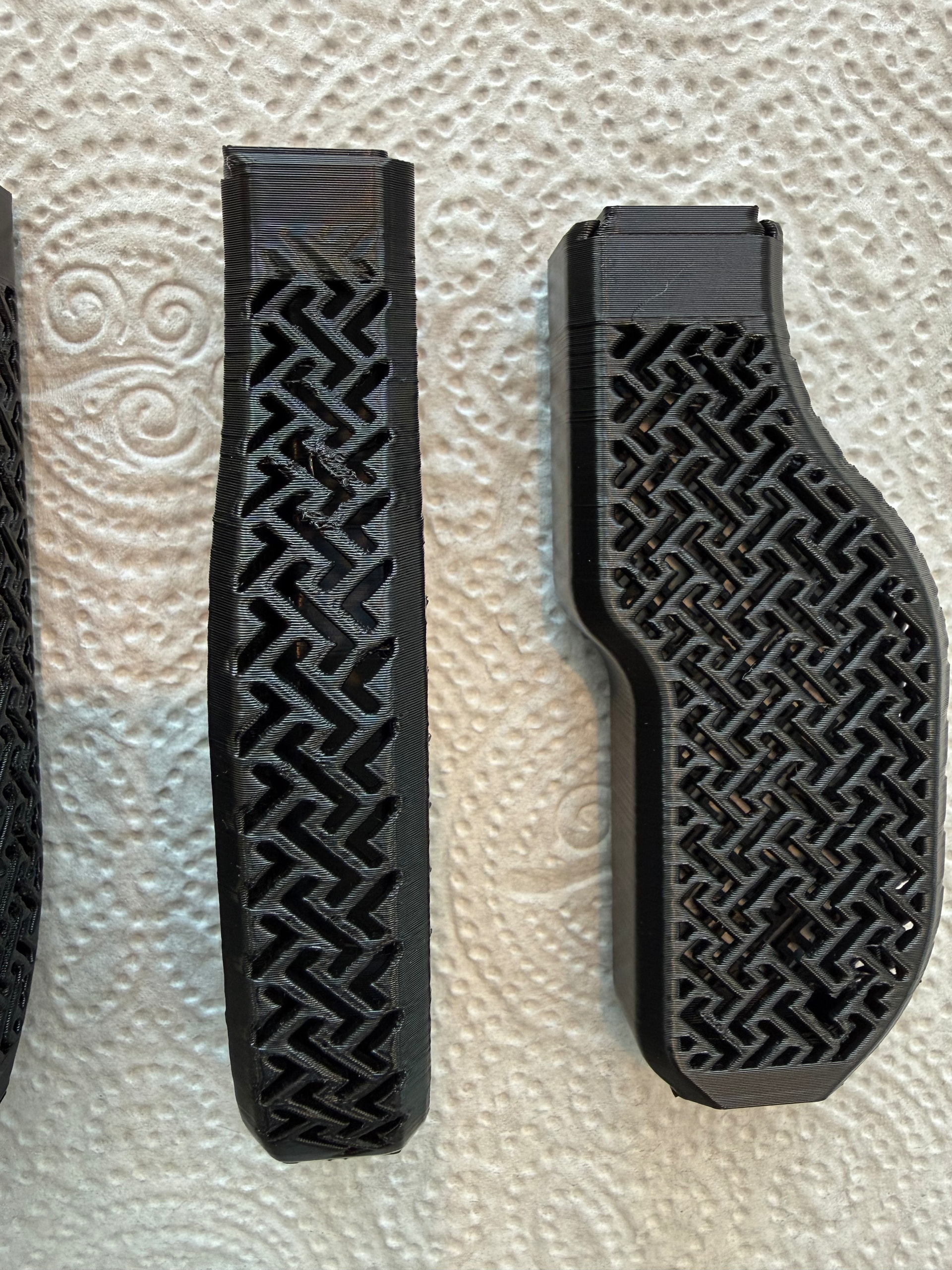

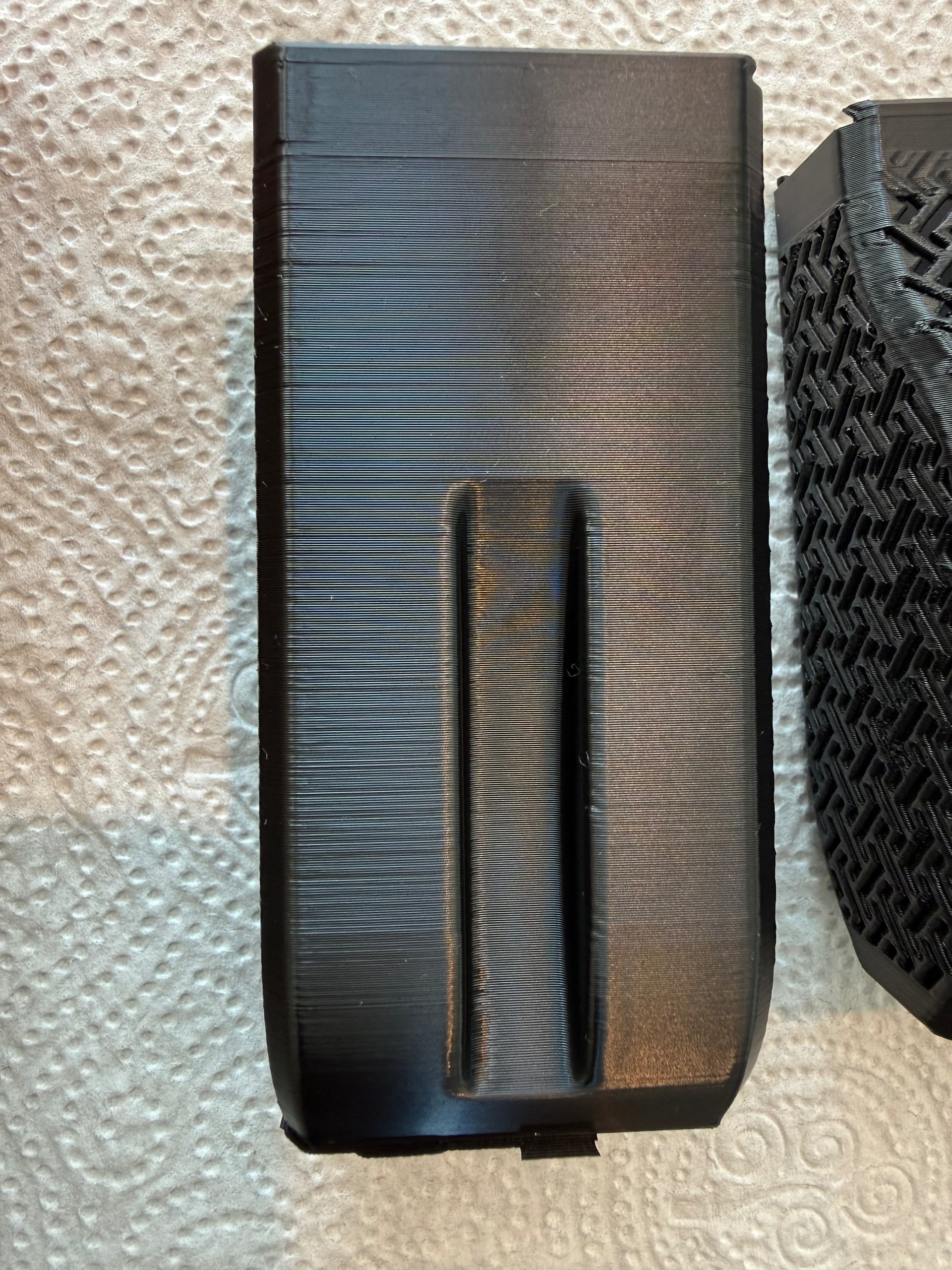

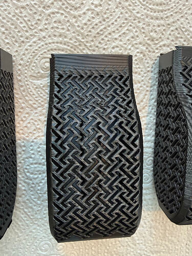

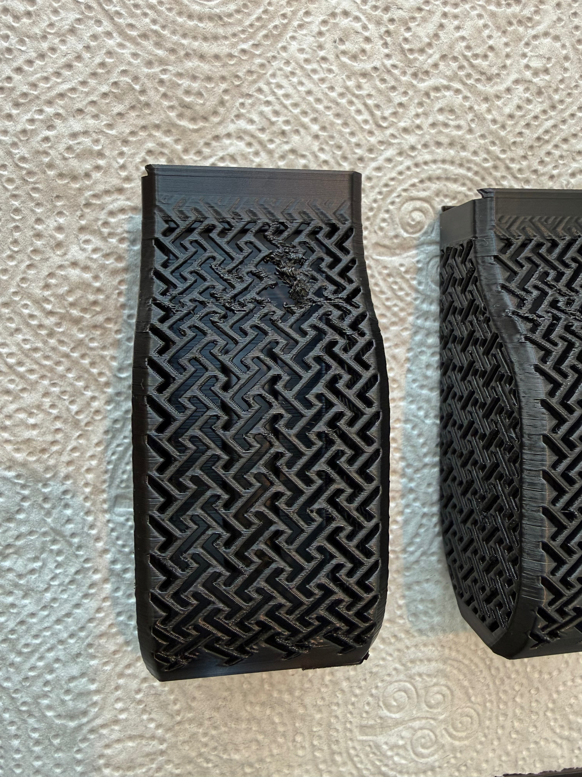

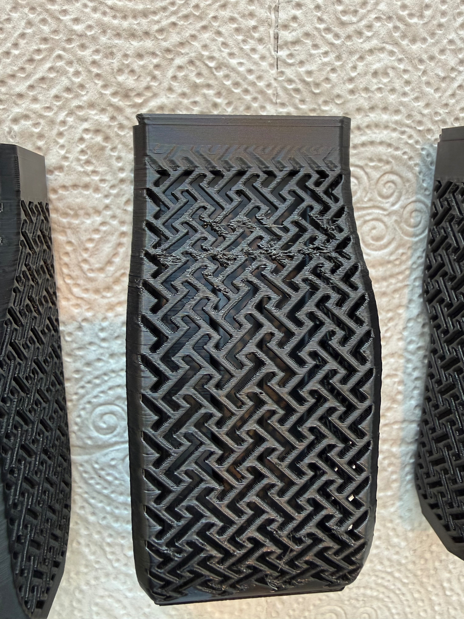

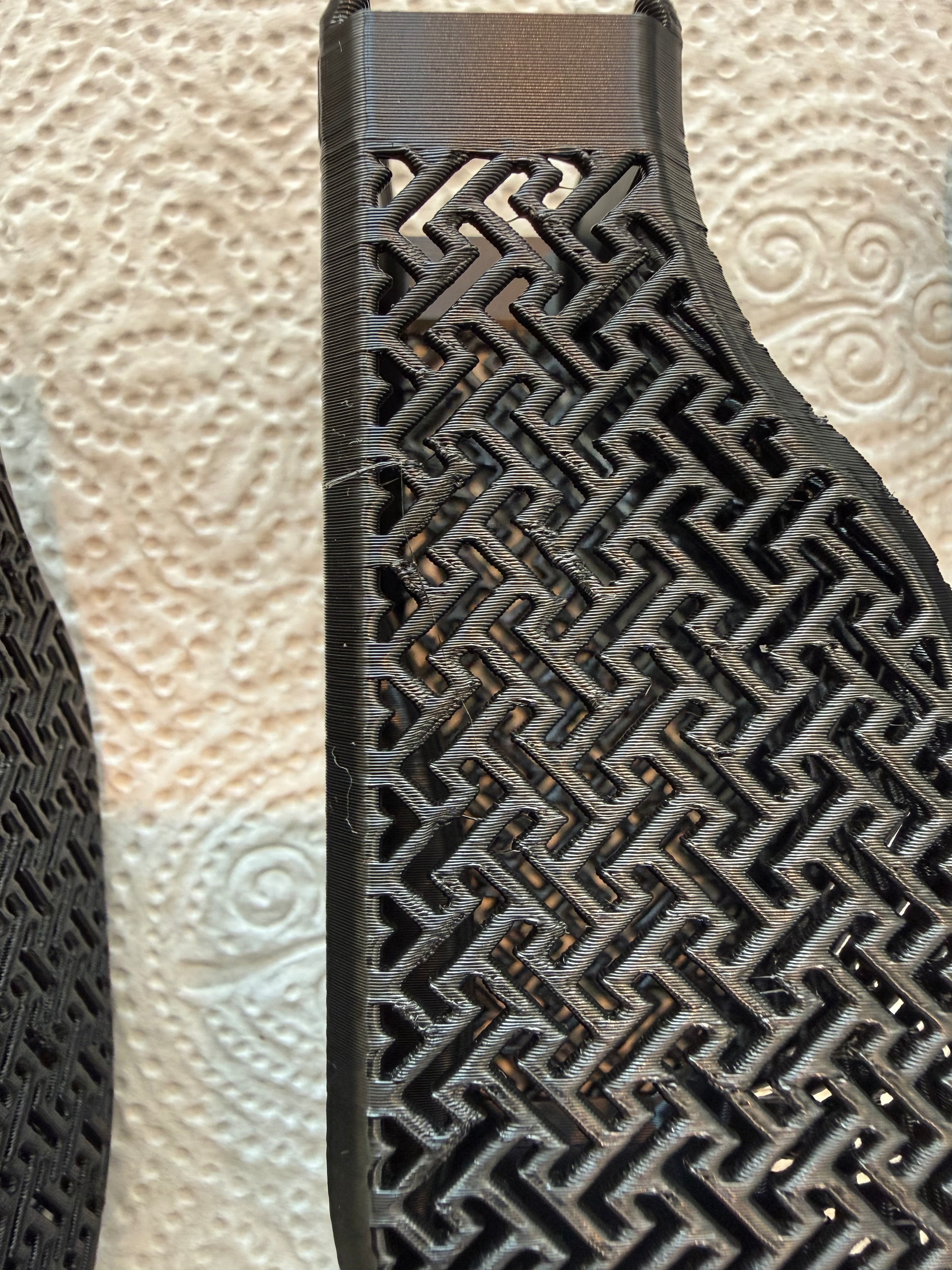

Hi, struggling with PETG Basic filament from Bambu Lab.
Using Bambu Studio, the PETG Basic profile, no changes. Everything stock.
Trying to print this model
https://makerworld.com/en/models/1902035-ams-2-pro-dry-box-high-toughness-dense-mesh#profileId-2345851

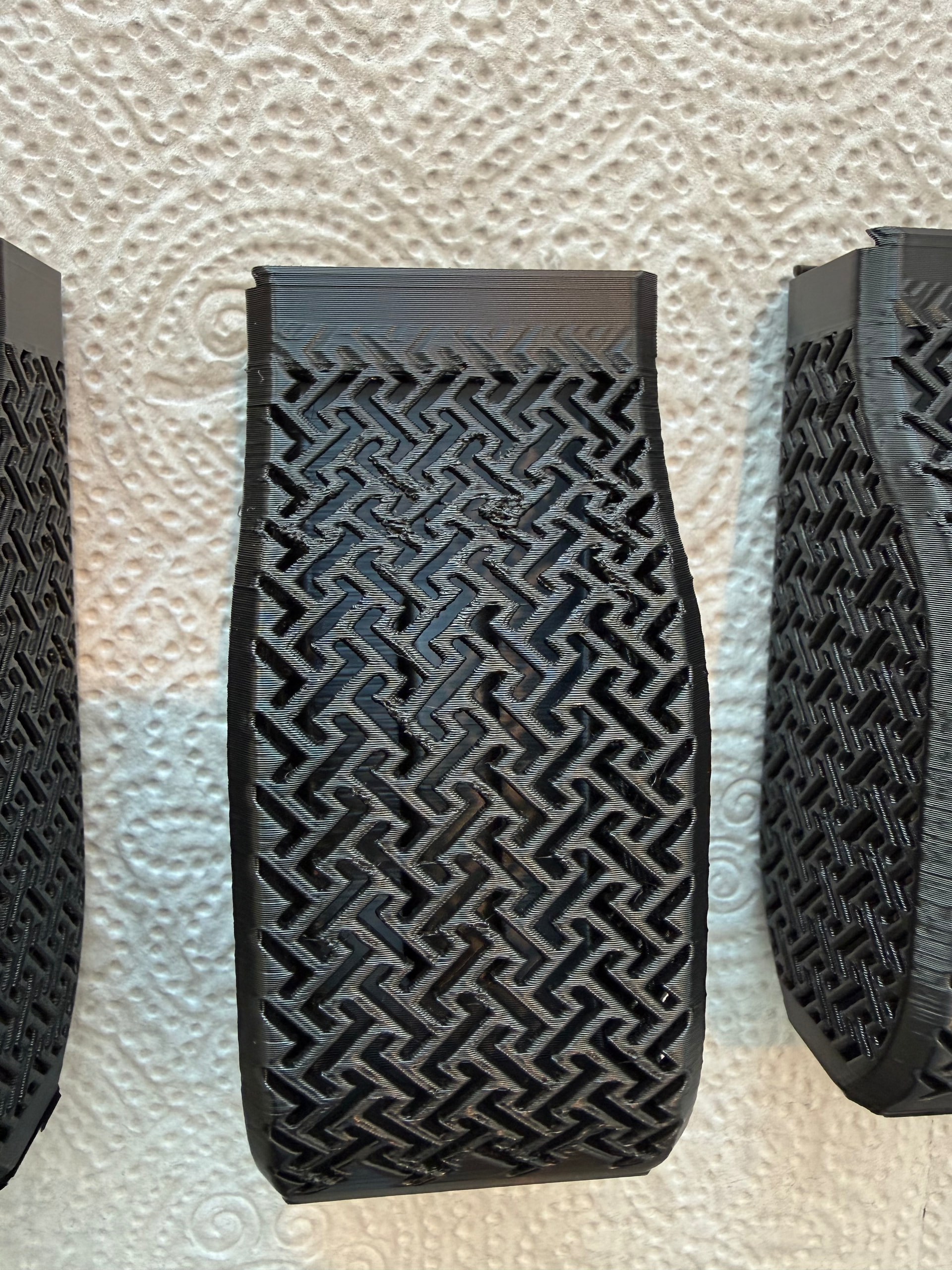

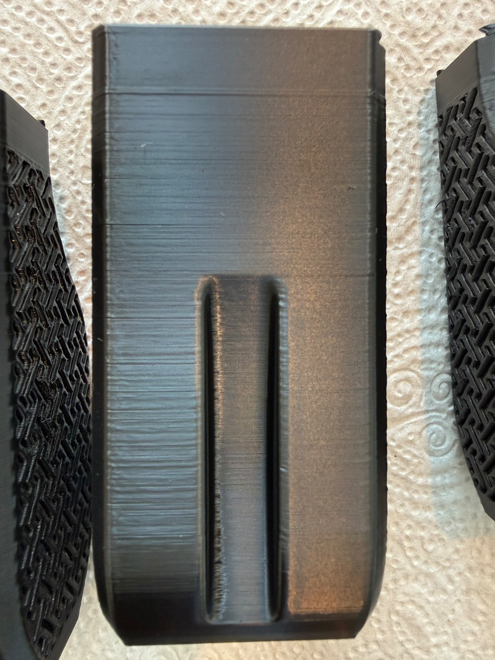

I had similar issues, but not that extreme with overhangs when printing some other items. Some places it worked perfectly, others it got messy. Not sure what is causing it or where to begin troubleshooting.
Humidity is at 23%, dried the filament before printing.
PLA Pure on the other hand prints almost perfectly every time with the PLA Pure profile.
PETG is much more temperamental than PLA.
Since you have dried it (recently), that common issue should be OK. However, PETG does reward printing slowly. Not sure about the “new” PETG Basic (yet), but for the “old” PETG Basic I slowed down all printing speeds to 80mm/s while adjusting/checking cooling settings match those for “Generic PETG”.
PETG of all kinds like a hotter nozzle temp. I prefer 265ish for basic and HF. You can tell in the flow calibration line it puts at the front of the plate whether your temp is right. Thin, wispy line? Too cold. Massive fat blob? Too high. There’s a fairly wide range of “ok” between those two extremes.
I’ll check that. I thought the flow calibration it does automatically was good enough, but I’ll keep an eye on that and adjust.
I’ll try slowing it down I thought the profiles from Bambu themselves should be “perfect”, but I’ll give it a go and appreciate the info. I’ll also check the Generic PETG profile.
Flow calibration doesn’t adjust heat. They give a heat range in the filament profile, but only use what is set as first layer and subsequent layers (each their own setting) which are both not ranges. If it is undextruding due to not being melted enough, you have to up that temp yourself.
That’s good info. I would still expect the default profile would be tuned correctly with their own filament though. Trying to dry the filament even more at the moment, some said below double digits in humidity produced much better results. Is this really needed?

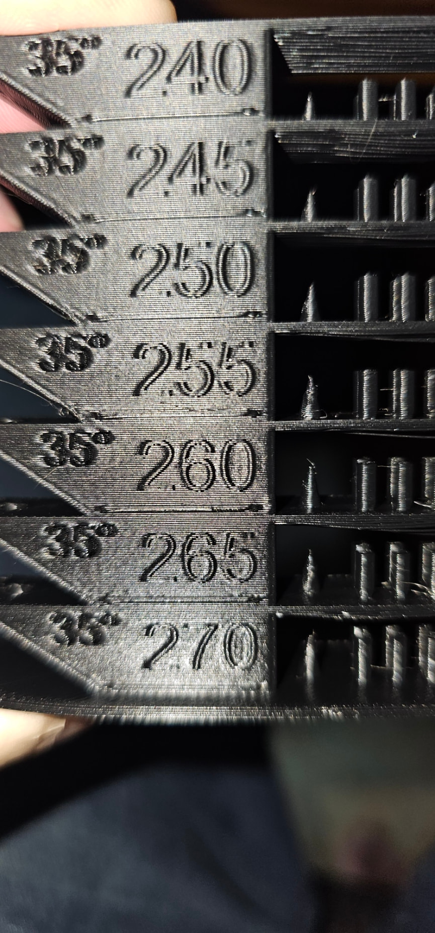

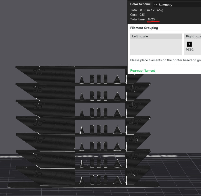

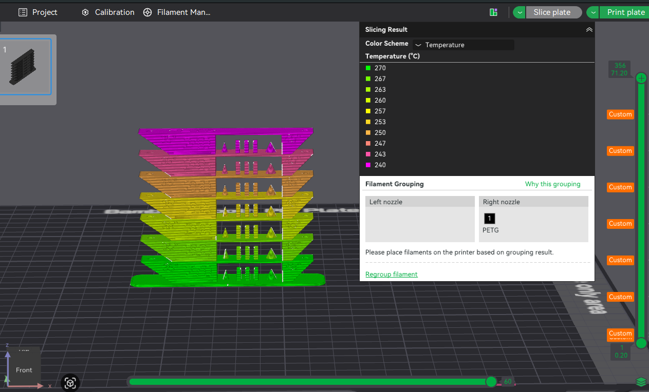

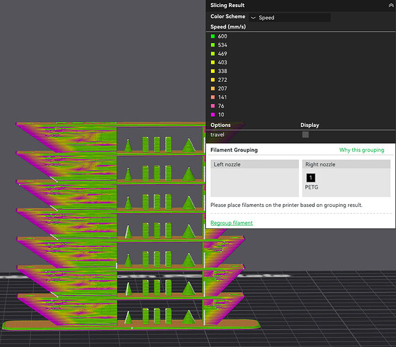

Download this and check the temps. Make sure you DL the STL file, not the 3MF, and then check to make sure the temp is changing per layer after you slice it.
Print and check the layers. You should find an ideal temp for that filament.
PETG has horrible overhang performance and that model has lots of them, one of the reasons I dont use it often. If you want heat resistance with those pods I would print them from ABS or ASA.

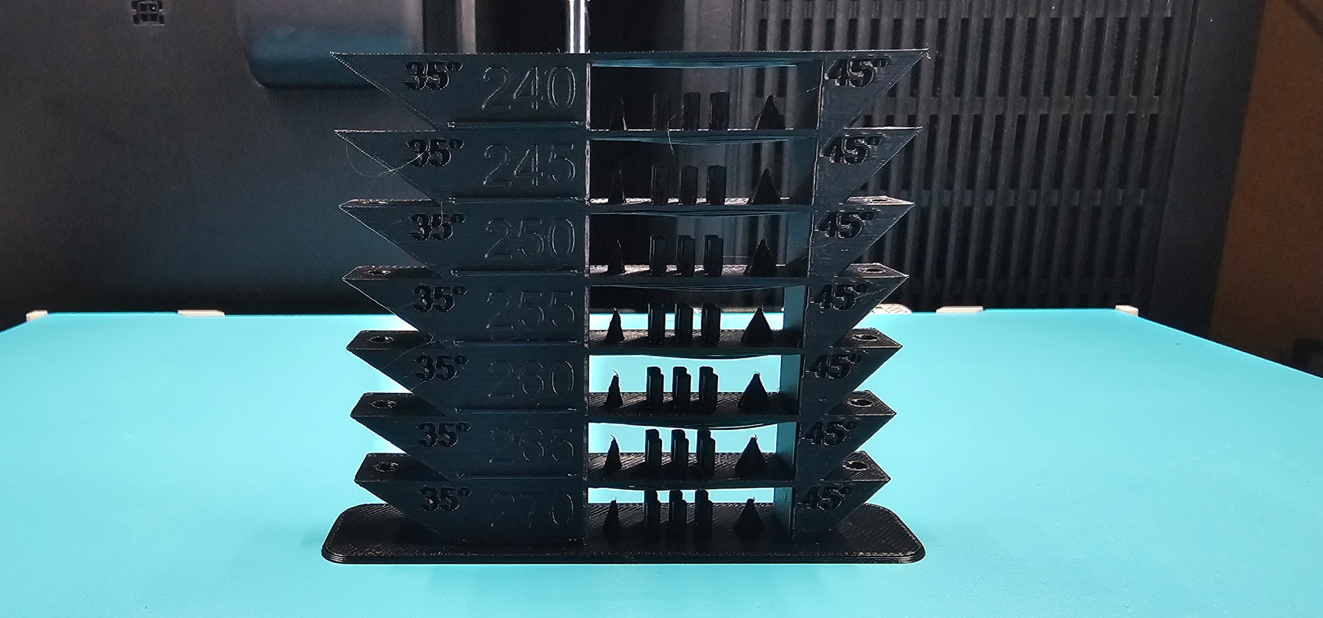

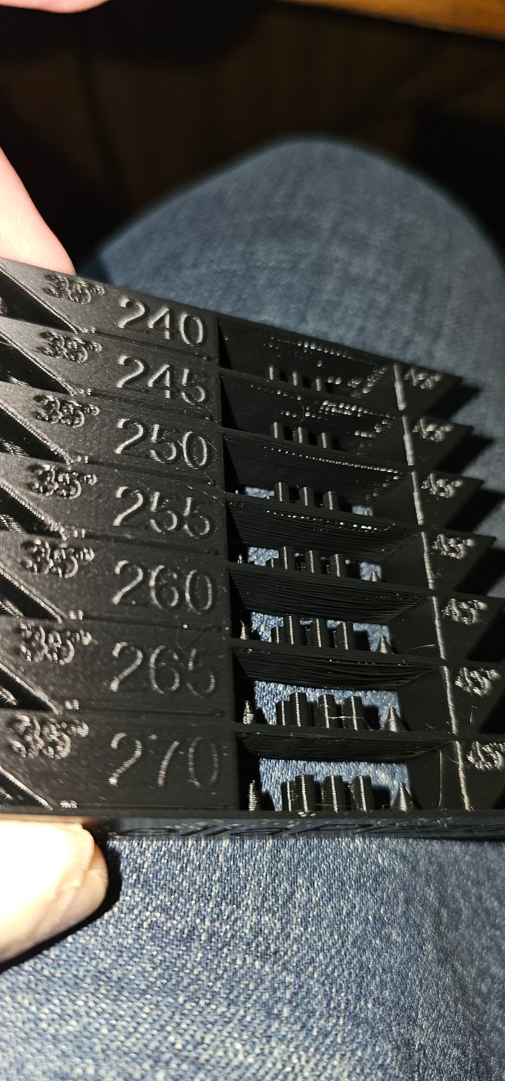

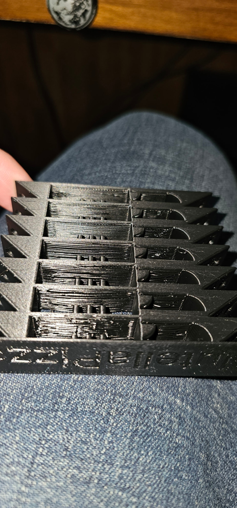

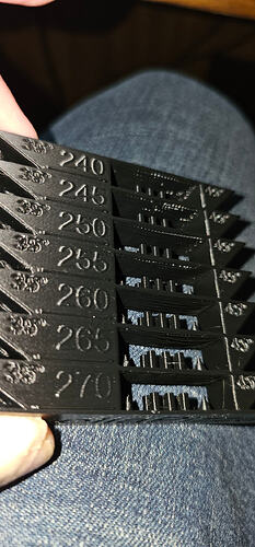

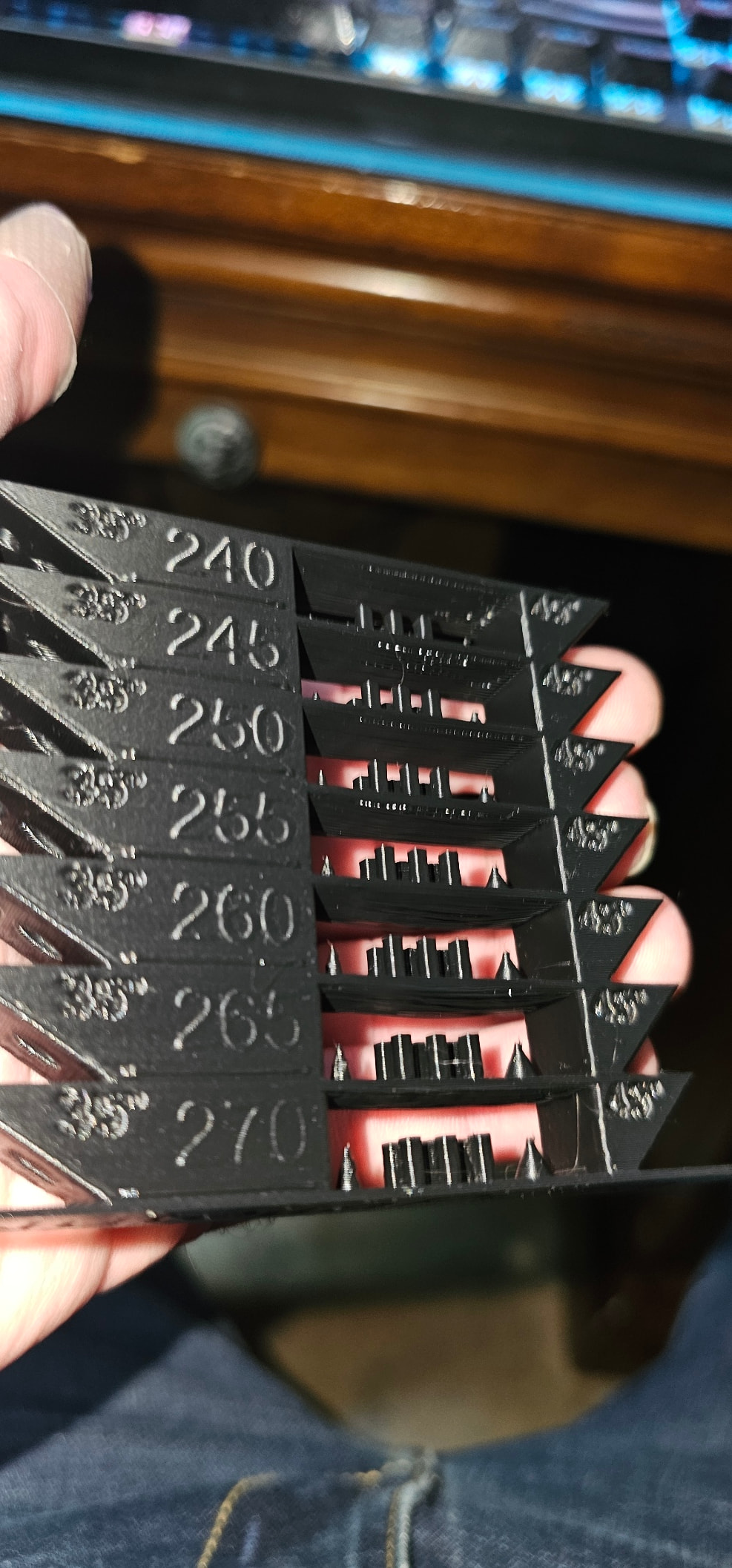

Here’s my temp tower. Default Bambu profile. Now this is PETG-HF, not basic, but still BL PETG. Printed with .4 HF E3D Obsidian nozzles. This filament was dried weeks ago, but it sits in an AMS2 with silica.
I see some not so great bridging until we hit 265c, but everything else looks fine. No stringing, good layers, good angles, etc. 265 is what my custom profiles are set to. Oh, and speed?

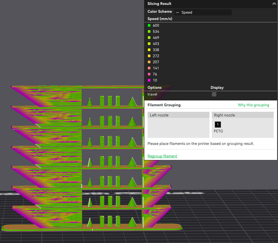

Max volumetric speed is 65mm/s.
There’s a lot of myths with PETG. “Print it slow” is one of them. Default settings this is a 2hr print. That’s 30% faster than default, and I haven’t really optimized this for speed.
