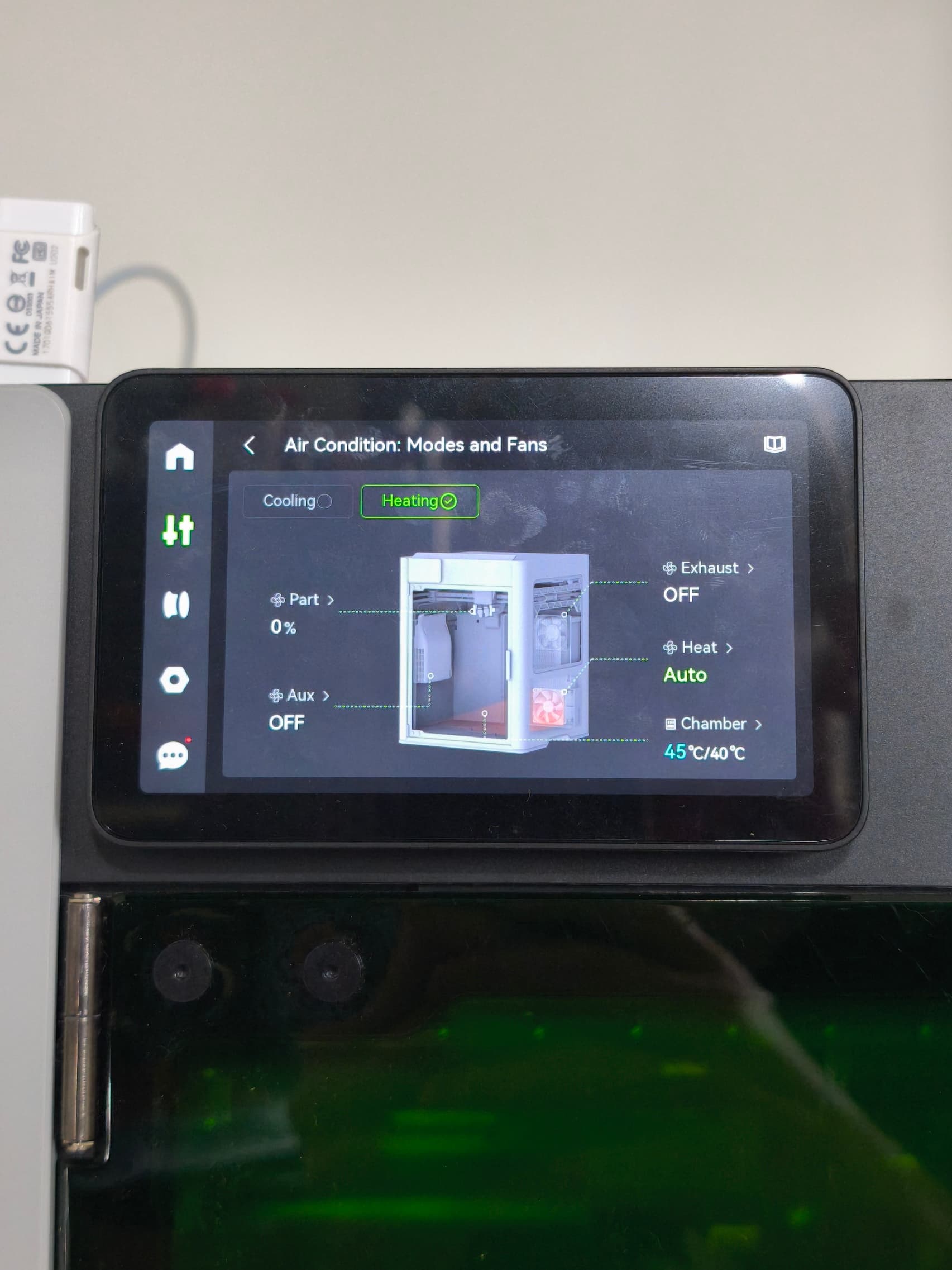

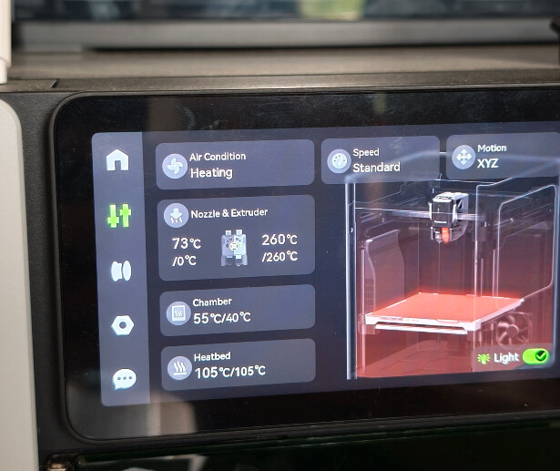

When I got my H2D I thought it would be a breeze, and mostly have been, but I started having considerably worse overhangs. When I paid attention I noticed that even though the chamber temperature was set at 45deg, during most of the print it’d slowly go up and hit even 60degC, which made most of my overhangs not good.
After some trials I noticed that it seems that chamber temperature is not maintained? It seems that temperature just slowly creeps up. To avoid extreme temperature, I’ve set a smaller initial temperature, but still get the same results… Eventually temperature rises way above the target temperature. Example:
Chamber temperature: 40degC
Chamber temperature after 2h of starting: 55degC
I already tried to turn of chamber heating at all, but temperature tends to raise even more (since printer is quite well insulated and bed is quite big, it reaches over 60degC).
Has anyone faced this problem and how did you fixed it?

You can turn off heating mode in filament settings then. In heating mode it’s never exhausting air, though the chamber heater has been turned off when it reached the target temp, the heat bed alone can raise to 55C if you’re in summer now.
Yes, it’s dumb, but it’s the best we can get for now…
However I wonder why you’re setting the chamber temp to 45C. It’s quite unusual for ASA…
The heatbed set to 105° is the culprit. That is going to continue to heat the chamber.

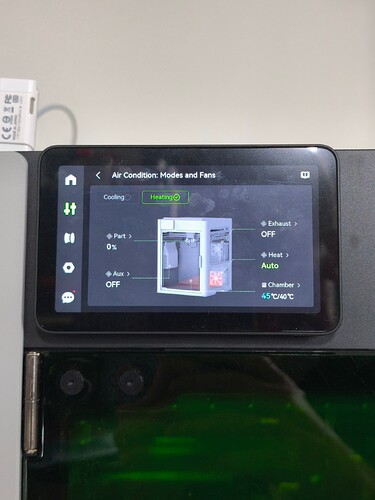

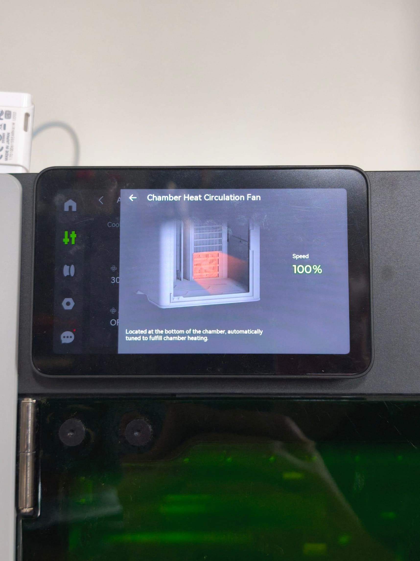

But what’s bugging me is that if I go to the menu, and select the Heating, I can see the Chamber fan is at 100%, which for me is strange. Since the current chamber temperature is higher than the set temperature, it should completely shut of the chamber heater…

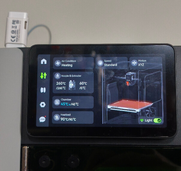

I’m now trying to lower a bit the bed temperature from 100 to 90 to avoid having it heat soak too much the chamber temperature, and needing to have less opened top to keep 45degC.
But still, all of this seems a bit sketchy for something that should be handled by the “Closed Loop Air Temperature Management”

The circulation fan running does not mean the heater is heating.
Just like the fan running on my furnace doesn’t mean the furnace is heating.

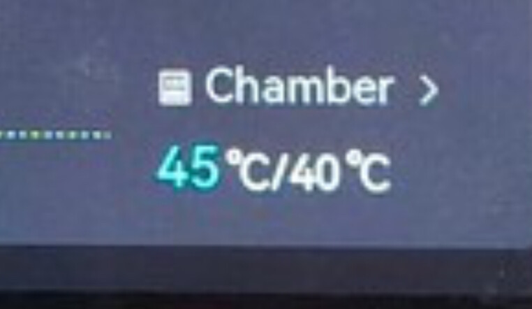

Yeah I understand what you say, but in the menu, nothing indicates if the heater element is on or off. I think this would be advantageous to have. At this moment, I cannot know if the heater element is actively heating the chamber or just circulating air.
My concern with using 0 as chamber temperature, is that as you pointed correctly the air intake will open, which will bring fresh air which can cause warping or poor layer adhesion. Honestly haven’t tried it because I dont want to risk having poor layer adhesion, but indeed, maybe playing with exhaust fan can keep the temperature stable which not affecting too much the chamber temperature.
It is indicated.
See how the number is blue?
If the heater is on it’s red. If it’s not on it’s blue.
