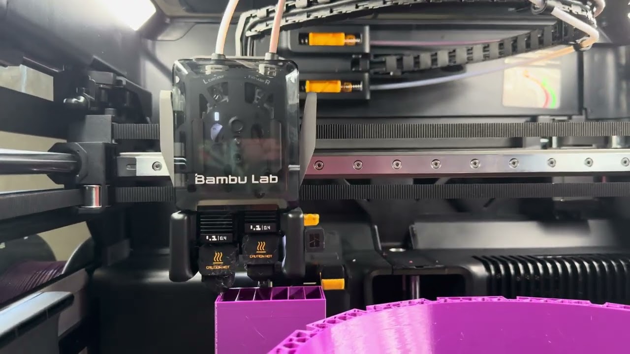

H2D clicking / rattling when the head moves back and forth
anyone else getting this? Filament cutter related perhaps…?
I haven’t heard the clicking noise—do you know if the right nozzle makes it too?
it is doing a 2-colour print now, and when it prints on the right nozzle the noise pretty much goes away. the nozzles do have different speed and accel. settings, the right actually has faster.
perhaps something to do with the extruder?
Remove the silicone sock and check if the left nozzle tip is loose. If everything looks fine, try running a small test print with retractions disabled (set to zero in the filament settings override). This will help us pinpoint the source of the noise. Keep us posted.
i’ll do that once this print ends.
recorded another video with both nozzles printing.
right nozzle infill printing starts at 1:15
It sounds like the clicking noise is coming only from the left nozzle. If the nozzle tip is firmly in place, try cleaning it with cleaning filament or doing a cold pull. Alternatively, you could test with the backup nozzle. Once done, run the test again. Keep us posted.
The nozzle is firmly in place. Tried printing with the replacement too, but the clicking is still there. Setting retraction to zero did not solve it either.
Inspect all the screws located behind the left nozzle for the heater and rail to ensure they are not loose, and verify that there is no excessive movement play in the lifting rail.

Given that it’s only when printing with the left nozzle, check the position of the flow blocker to ensure it’s snuggly on the right nozzle. Also check where the magnets are. Could it be a miniscule gap at either the nozzle or the magnet that’s causing the rattling? *someone else had the magnet cover pop off

it def has to do with speed…
when the print head is moving fast… its rattling /clicking… mostly when it moves on the x axis…
i tried to move the head while the printer was turned off… so ther was no extruding…
i some how was able to recreate the sound by moving the toolhead left and right … i can hear a clciking sound… the faster i go the more i hear it…

My printer started making this noise on i found there are 2 exposed gears on the rear of the machine. Left&right you can see them through a oval shaped cut out. I sprayed gun oil on mine and its gone. Hope this helps😁
i’ve sprayed some contact cleaner into those slots … theyre the gearings of the rear belt pulleys, and doing so fixes another noise the printers make, the sort of screeching / scraping noise. dont recall it having effect on the clicking noises on my device.

try re-running the nozzle heigh calibration. the nozzle itself may be colliding with already printed material because it is lower than the printer expects.
