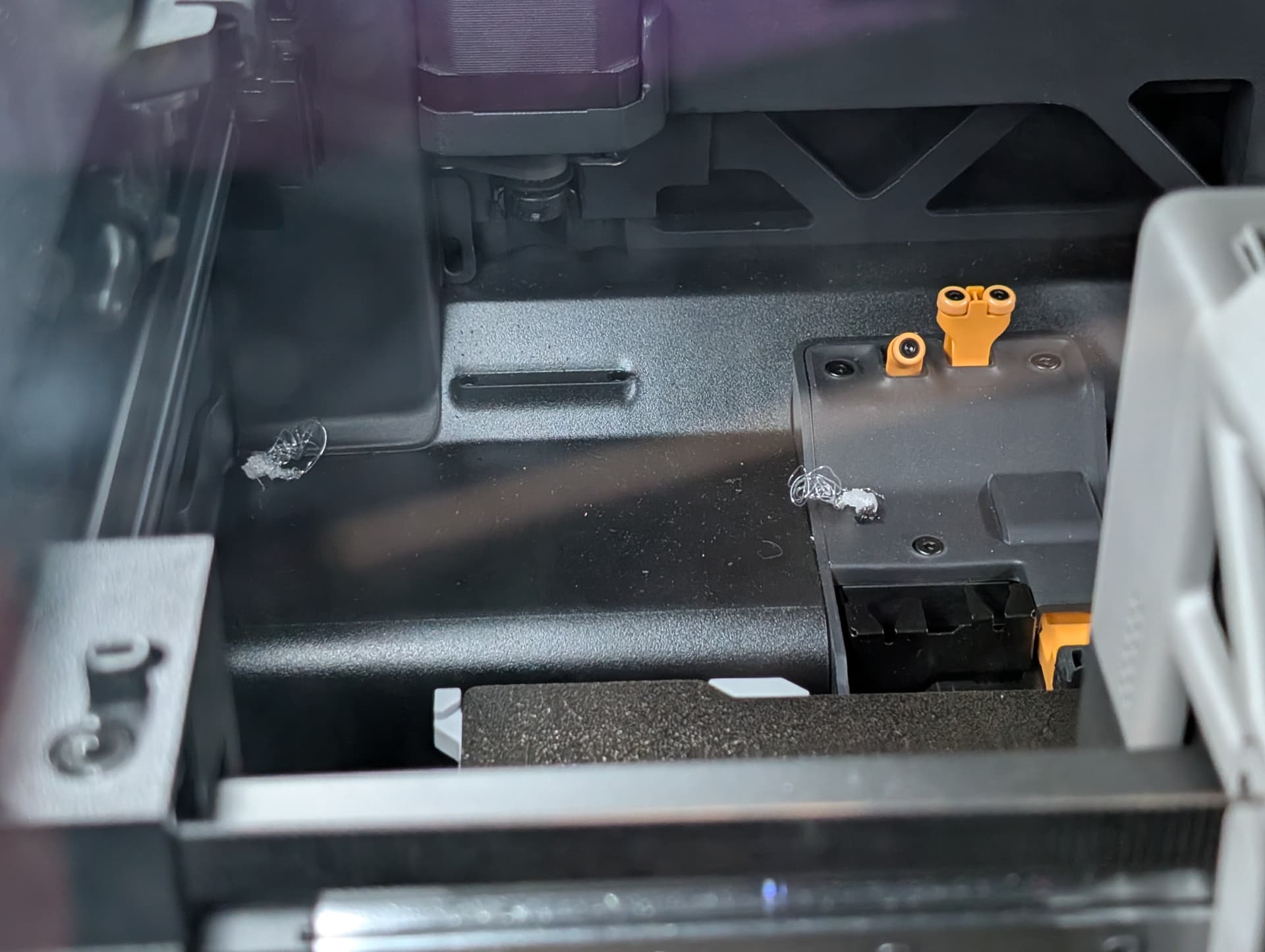

I have printed like 30+ hours so far on 1.01.03.00 and haven’t seen anything odd except the it’s still purging too much on 0.2 nozzles causing blobs to build up and throwing the purged filament onto the build plate.
I will say, quality on the 0.2 is way up though, It’s night and day compared to the original shipping firmware.

I grabbed a pic today. This doesn’t happen with 0.4 or 0.6 nozzles.
I got lucky it didn’t fling it onto the build plate like it normally does, but these globs sometimes trip the spaghetti detection.
I don’t have the beta firmware but I certainly get poops outside of the poop bin with my 0.4mm nozzle as well.
I have same poops on all nozzles and BEFORE beta for sure, so its not an beta issue
