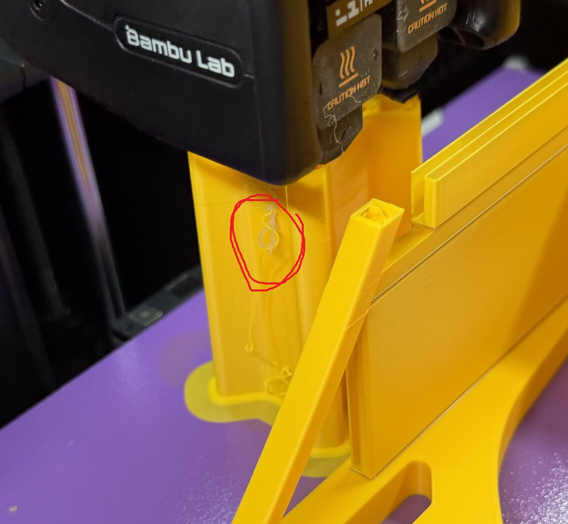

Got the Beta notification and installed, took ages to install, re-did all calibrations and the only niggle I see so far is that I get spaghetti detection errors for what I’m assuming is the strings on my prime tower as there’s nothing else on the print that could even remotely pass as spaghetti. It’s happened on two successive prints so far. I have two more similar prints and will snap an image the next time it pops up.
It happened right around this
You need to restart your printer.
But the rollout is a gradual process and not everyone receives it.
I just restarted and it’s updating mine at this moment.
Can confirm that the Spaghetti Detection is so sensitive now I’ve had to turn it off completely.
Rob
Did that. Nothin.
“Can confirm that the Spaghetti Detection is so sensitive now I’ve had to turn it off completely.“
I’m not on the beta and I had over sensitivity issues with spaghetti detection since 1.03. Sometimes I can’t even guess why it’s detecting something, so I also have it off.
I’m over a year without a false positive and have had a half dozen today. Might roll back after this project and see if that changes anything. Another thing I’m pondering is that the prime tower was very close to the print and that maybe that had something to do with it.
