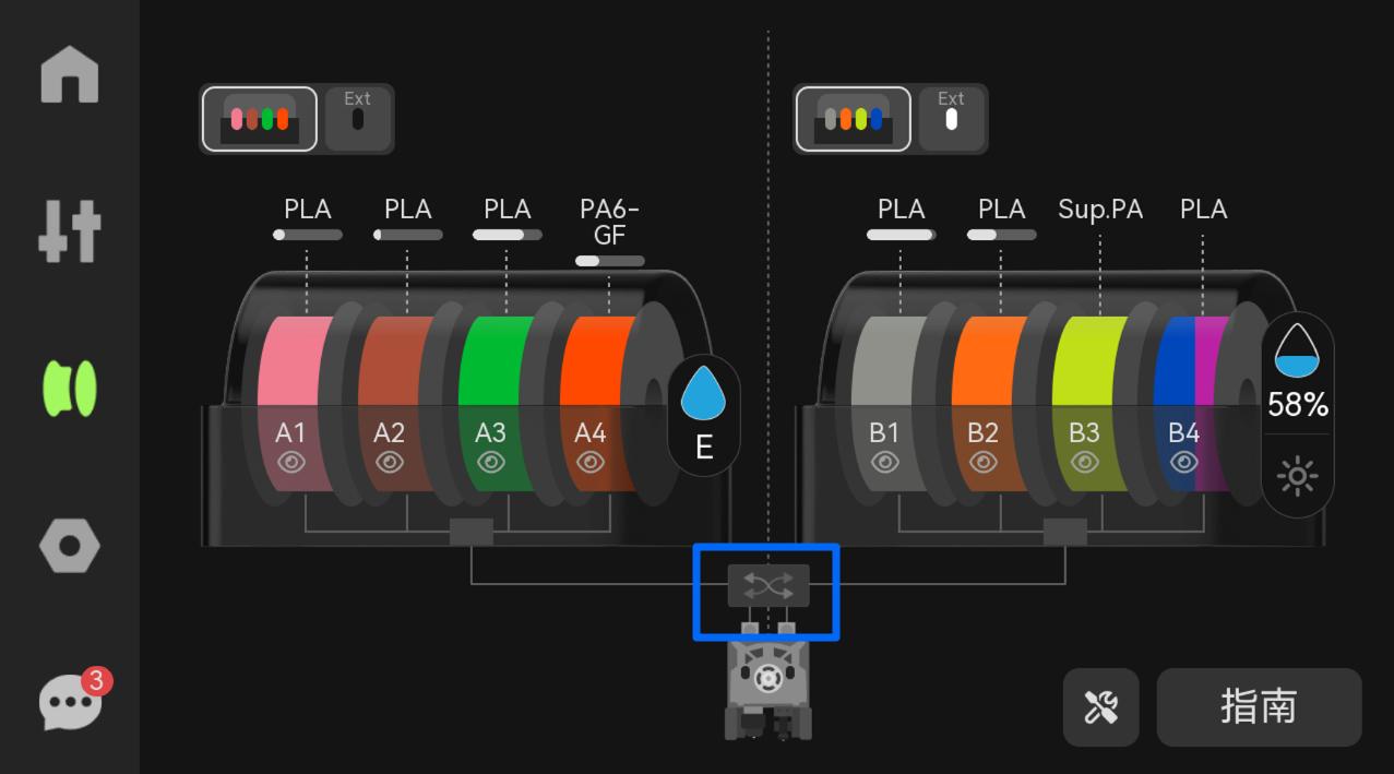

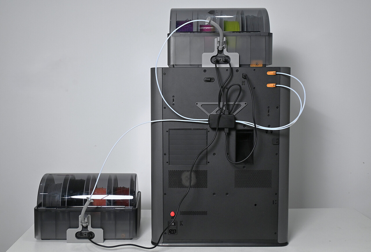

  1. Added support for the Filament Track Switch
The filament track switch is specially designed for dual-nozzle printers, equipped with 2 filament inlets and 2 filament outlets, and supports seamless mapping between AMS and dual nozzles.
For more details, please refer to the wiki: https://e.bambulab.com/t?c=XniDu1KyaRFd6fQa.
This feature requires Bambu Studio v2.5.3.60 or later / Bambu Handy V3.18.0 or later.

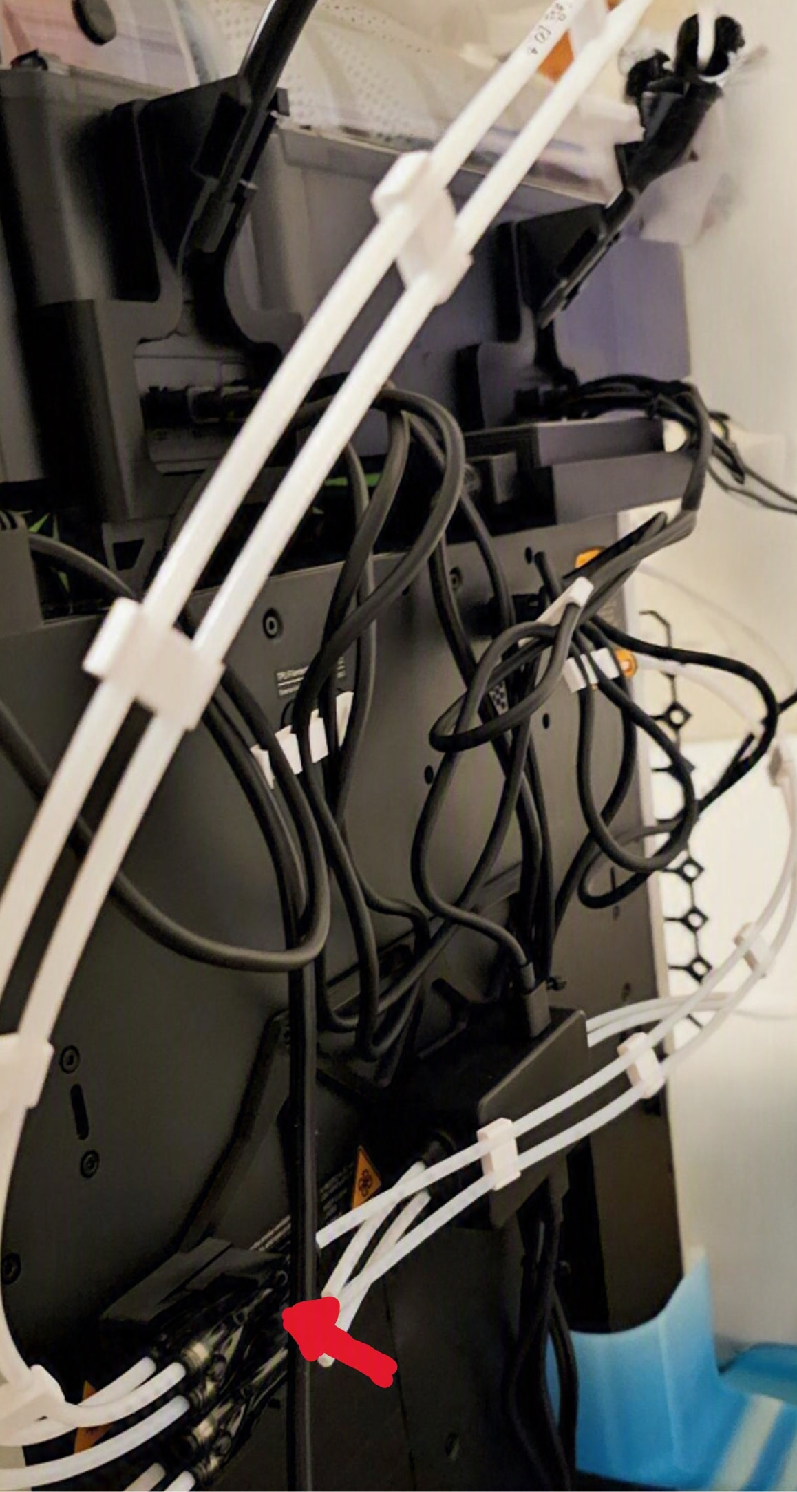

Waiting for this to be pushed out to mine; I’ve been enrolled since day 1 and have the track switch all mounted up ready to go!
