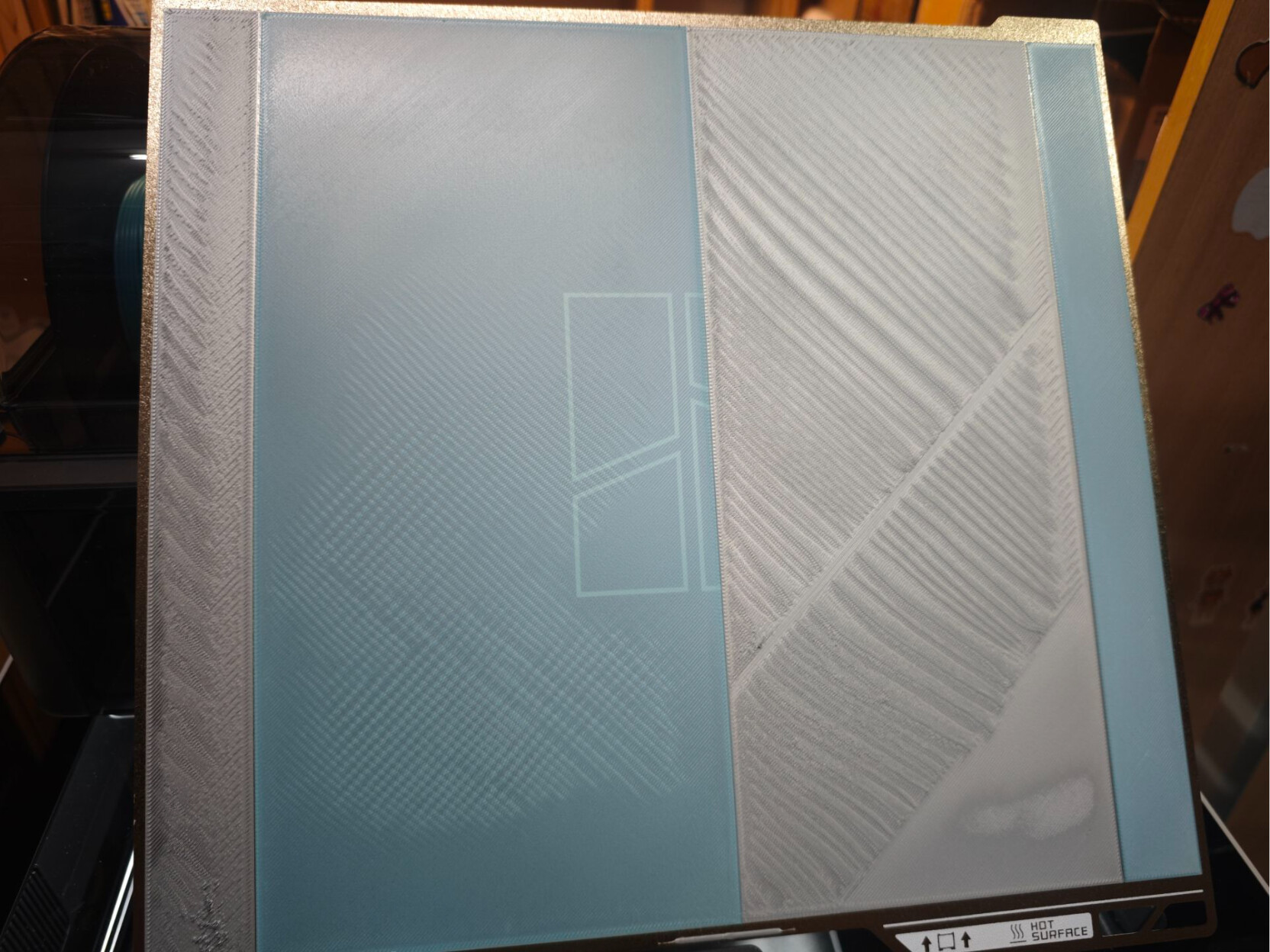

This seems to cause major print quality issues with the left nozzle; I cannot get a quality print when I use the left nozzle by itself, or when I use the left nozzle and the right nozzle at the same time. Using the same roll of filament for both the right nozzle and left nozzle, the right nozzle prints just fine but the left nozzle seems to not be working correctly. The left nozzle seems to exhibit massive over extrusion behavior with a ton of blobs. During the high precision nozzle offset calibration, the calibration seems just fine, but during a normal print, I have not successfully been able to print without major quality issues on the left nozzle. I have tried re-calibrating the printer from scratch, calibrated the filament flow ratio and pressure advance, have left the filaments to dry for their recommended times, have tried adjusting the screws for the left nozzle print head, and have replaced the left nozzle and nothing has seemed to work. I have also ensured that there was no filament on the nozzle itself, ensured to clean the calibration area using a microfiber cloth, and have also cleaned off the print head camera with a microfiber and the issues still persist. I feel like I have exhausted all potential recommended fixes and I am at a loss as to what to do. Any help would be most appreciated.”

I don’t have a good picture unfortunately, but it essentially looked like over extrusion with blobs forming literally everywhere.

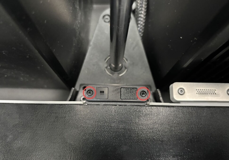

where is the nozzle offset calibration sensor?
Back of the build plate. Next to what looks like a meteal cheese grater.

Sorry, I’ve been moving and haven’t had time until today to get working on this again. I’m also reaching out to Bambu Support about this, so hopefully they send me a new sensor to see if that fixes the issue. The exact error code I’m running into is 0300-4010 071710.
There is another forum post that alludes to trying to reduce the temperature chamber so I’m going to try that and see what happens.
So replacing the nozzle offset calibration sensor allowed the calibration to go through when calibrating with both the printer and from Bambu Studio. The test print came out a bit rough though; seemed like the nozzles were too close to the bed. I’m running through a full calibration again and plan to try the test print again so we’ll see how this goes.
