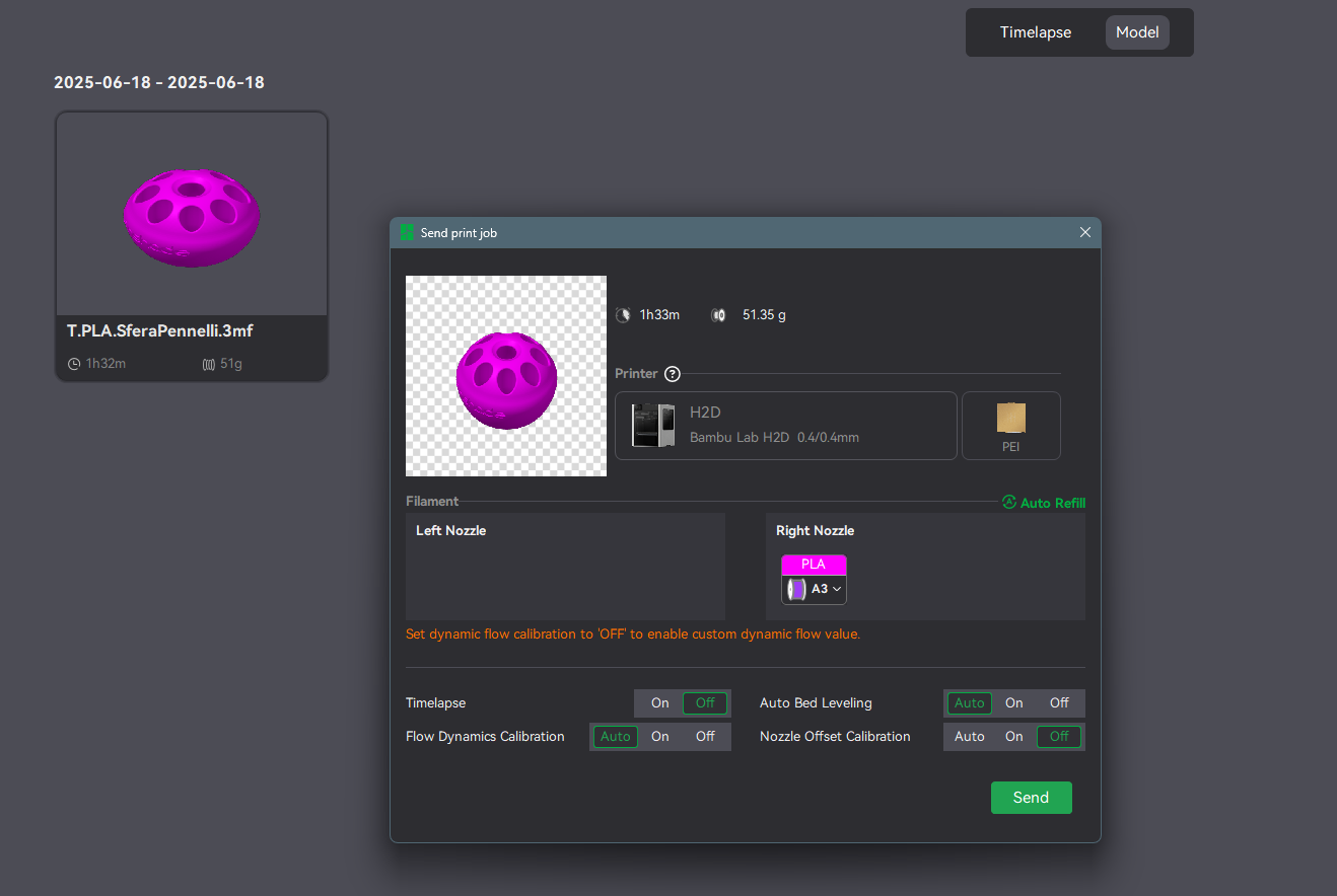

For work, I regularly print a wide range of PLA models in series. My usual workflow is to carefully slice all models in advance, upload them to the printer, and then—when I’m in the lab—simply select what I need from the printer’s display (or from Bambu Studio without re-slicing), pick the filament from the connected AMS units, start the print, and walk away. This works perfectly with my X1C machines.
With the H2D, though, this workflow is broken.
There’s no way—neither from Bambu Studio nor directly from the printer screen—to select which nozzle to use, and therefore no way to pick the AMS and filament. As far as I can tell, the machine locks the job to the nozzle used during slicing, and you can’t override it. You must print with that specific nozzle and the materials attached to it. That’s, in my opinion, both a frustrating and counterproductive limitation.
I hope this gets addressed soon, because it really affects my daily work.
Yes, I know I could physically swap AMS units between nozzles, but seriously—that’s incredibly tedious on a high-end, advanced machine that’s supposed to simplify our job, not complicate it.
Just to clarify: I’m running the latest versions – Bambu Studio 2.1.1.52, firmware 01.01.02.08 – so this is not due to outdated software.
Below is an example of how the two nozzles and their associated filaments are not handled properly when printing a model from the printer’s internal memory or from USB.

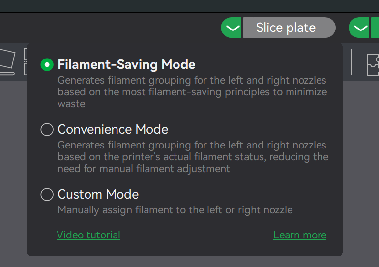

You can select the nozzle by hovering the “Slice Plate” button and selecting “custom mode”:
Once you hit “Slice Plate” afterwards, it will bring up what’s in the second screenshot. Hitting the middle “<>” button will swap the nozzle being used (or drag and drop as it says). Then you can select the filament you want in the screenshot you posted.
I do find it easier to just change whatever im printing to use the filament I want ahead of time from the filament selection on the right, that way its just tied to the ams I want anyway.

You had said it wasn’t possible from the slicer, so I showed you a way it is.
I understand that from the printer screen it is not and never claimed it to be…
