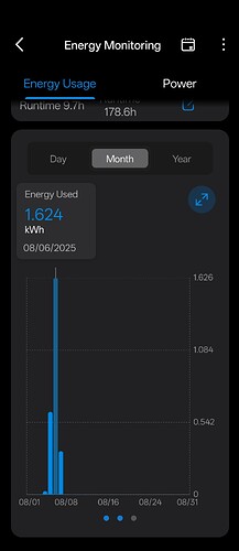

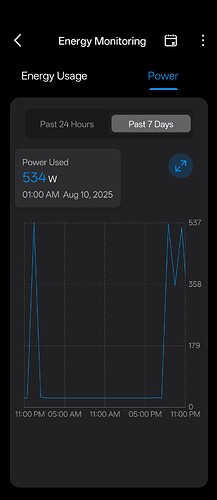

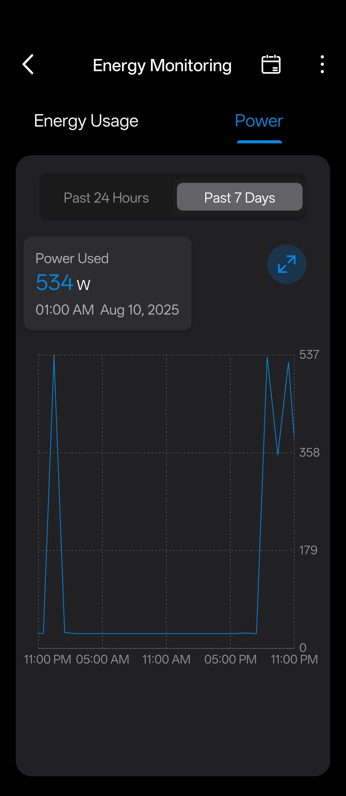

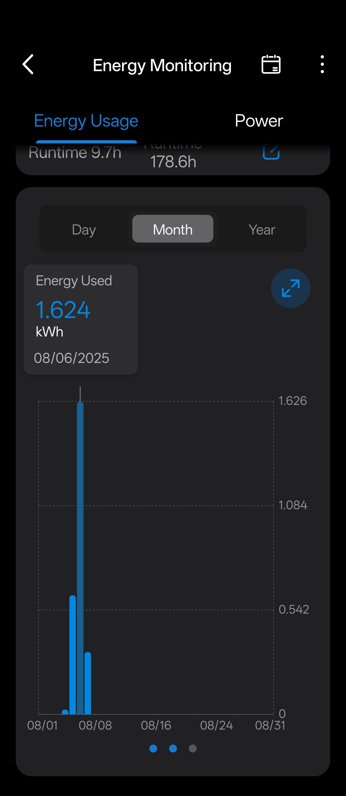

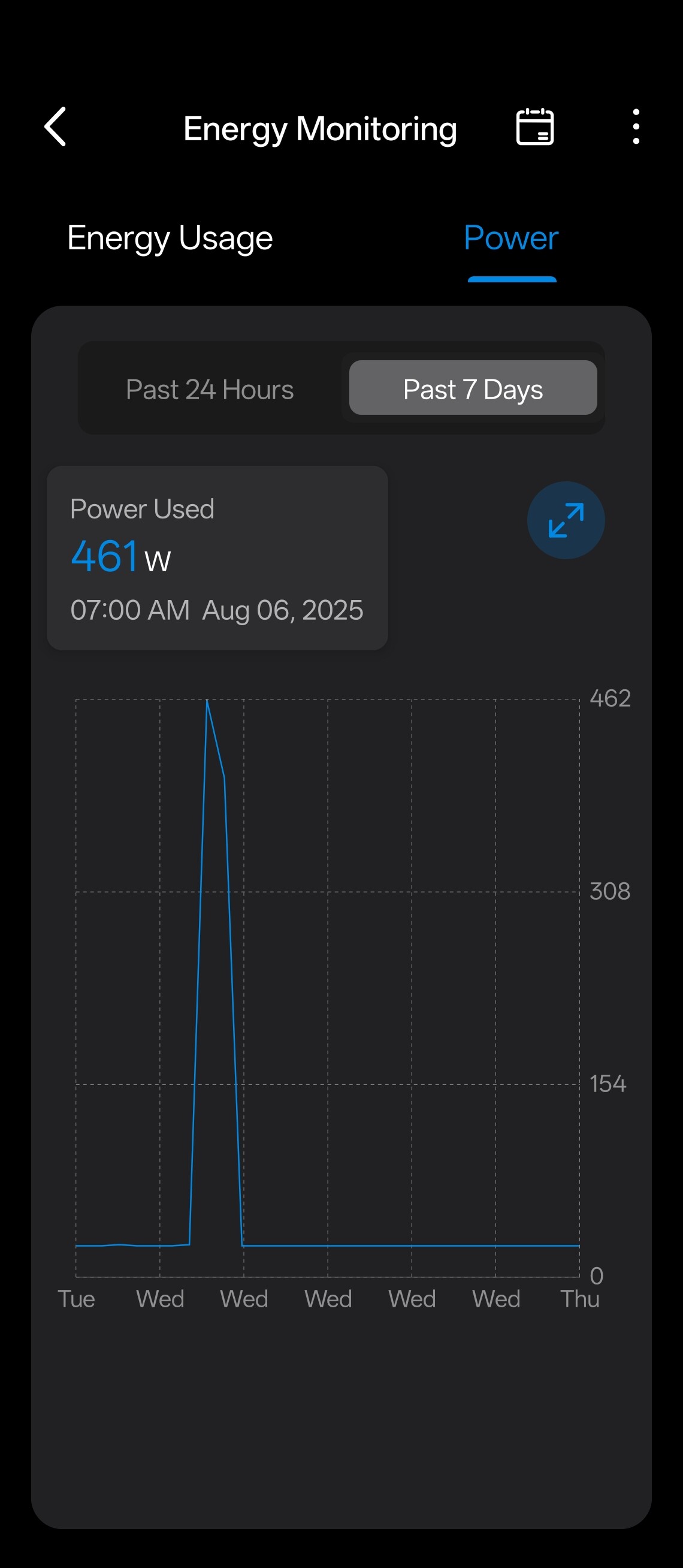

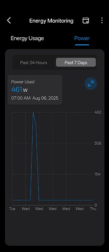

My plugs are showing max of 564(edit: 534)watts for one machine startup, and they quickly drop down after initial warm up(either). That way, I’m able to start up a 2nd print on my 2nd machine after initial warmup and actual printing starts… Typically, I just wait half an hour, and begin the printing. These are all ABS prints: 115 on the bed, 65 on the chamber and 260 on the hotend. It drops down to 461 watts, if I’m doing default Bambu profile of 90 on the bed, 65 on the chamber, and 260 on the hotend…
I am new to monitoring the electricity “game”, but it certainly “does” verify what I’ve been experiencing since having 1 H2D and 2P1S units: I can run them all day, as long as I don’t “start them all at the same time”…

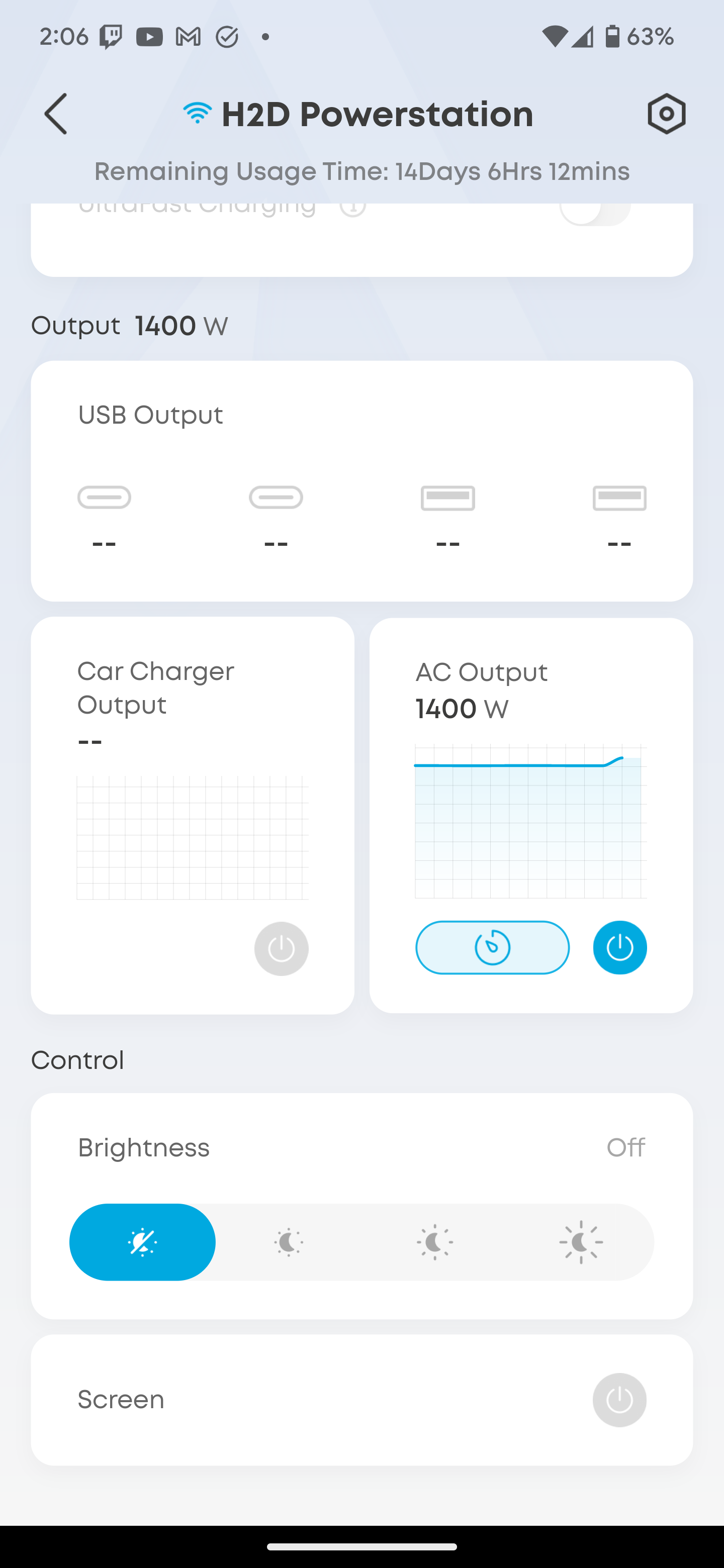

The only time you should see those numbers is during warmup. Here’s 1400W heating the bed, chamber, and one nozzle
