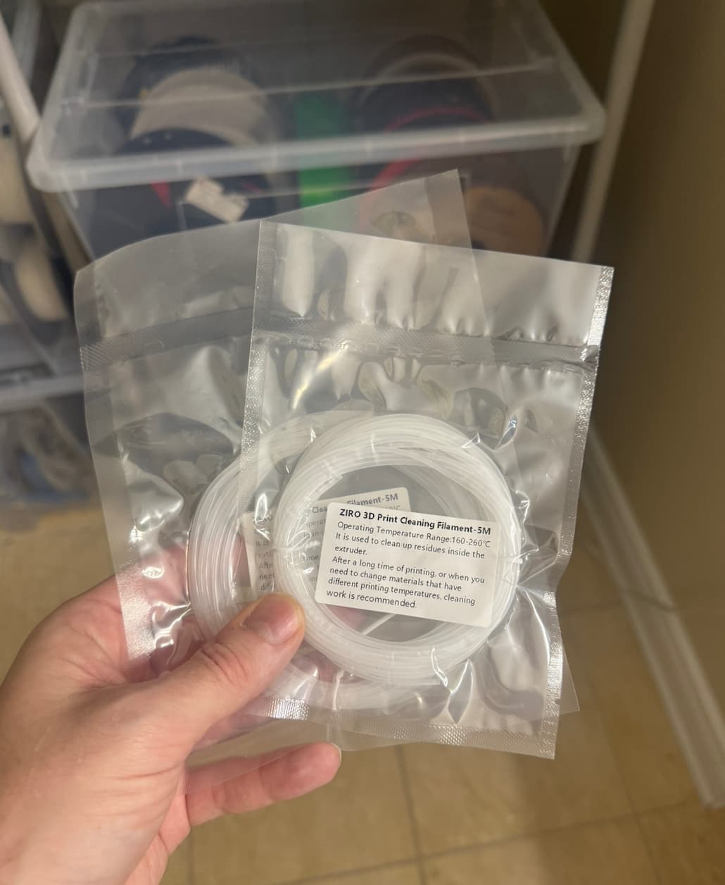

I own other dual nozzle printers and have learned that using cleaning filament is essential. Its broad temperature range helps protect the nozzle from damage when mixing different filament types, including TPU.
When loading new filament with the AMS, some old filament remains in the nozzle until the printer purges it at the beginning of the next print. If your last filament was PLA in the right nozzle and you’re now printing with a 320°C filament in the left nozzle, the right nozzle might not react well next time you go to use it.
To simplify the process, I first use the AMS to load cleaning filament, then manually set the nozzle temperature and purge it until all traces of the previous filament are cleared. For convenience, I keep the cleaning filament on a dedicated spool.

I highly doubt if a cleaning filament is really necessary. It is only needed for printers that cannot remember the last filament in nozzle. Or if you’re replacing a nozzle with PPS/PPA inside.
Are you sure this is the behavior? AFAIK the H2D remembers the last loaded filament for each nozzle. The problem should only happen with switching from higher temp to lower temp materials.

If I use same type of filament often, it’s not a problem. However, human mistakes are unavoidable, and that’s when you might find yourself dealing with a jammed $20 or $50 nozzle, or shredded TPU inside the extruder, and unexpected downtime.
Whether it happens depends on the level of risk you’re willing to take. Personally, I don’t like dealing with nozzle replacements or losing print time, so I play it safe.
If you don’t have cleaning filament, try testing with some clear filament you might be surprised by how much old residue remains in the H2D nozzle.

Cheapest way to get some cleaning/flushing filament is to buy some “Ziro” brand filament, they all come with a bag of 5M cleaning filament. Ziro is pretty good filament and has some colors no one else has like translucent fluorescent PLA etc.
Also as other have mentioned H2D remembers the last filament used and adjust the flushing temp. After I learned it does that I only use the cleaning fialment before I print TPU from external spool. Just pop out the PTFE tube from hot end and manually extrude a strand.
