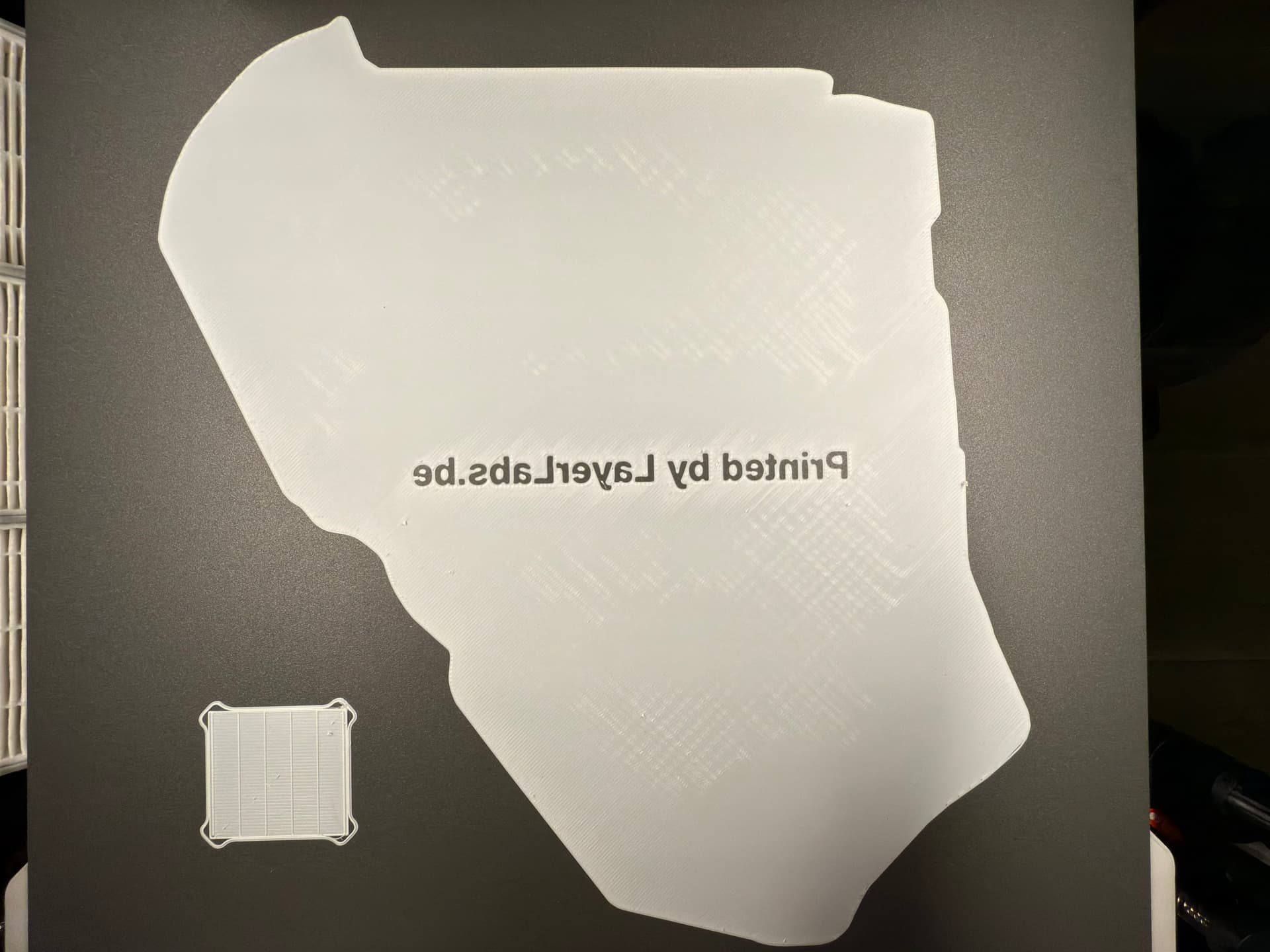

H2D Poor Print Quality
That’s really odd. Do you have a smart plug around the house? Or a safe way to check the outlet’s voltage that you are using? Just seems super odd that 2 machines, potentially made months apart have the same fault.
I’m not sure what a 5 or 6% shortage will do to the printer (if anything), but it would be good to know that the issue isn’t a local issue disguised as a printer fault.

I have used it on 2 separate outlets with the same result unfortunately. Both pulling the proper voltage.
0.28-0.33 is normal for most bambu pla on h2d 0.4 nozzles, it’s the same on hf nozzles as well.
I think you meant to tag someone else’s reply. Mine was about external factors (power/voltage).

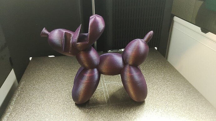

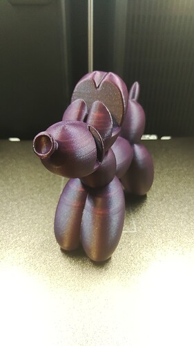

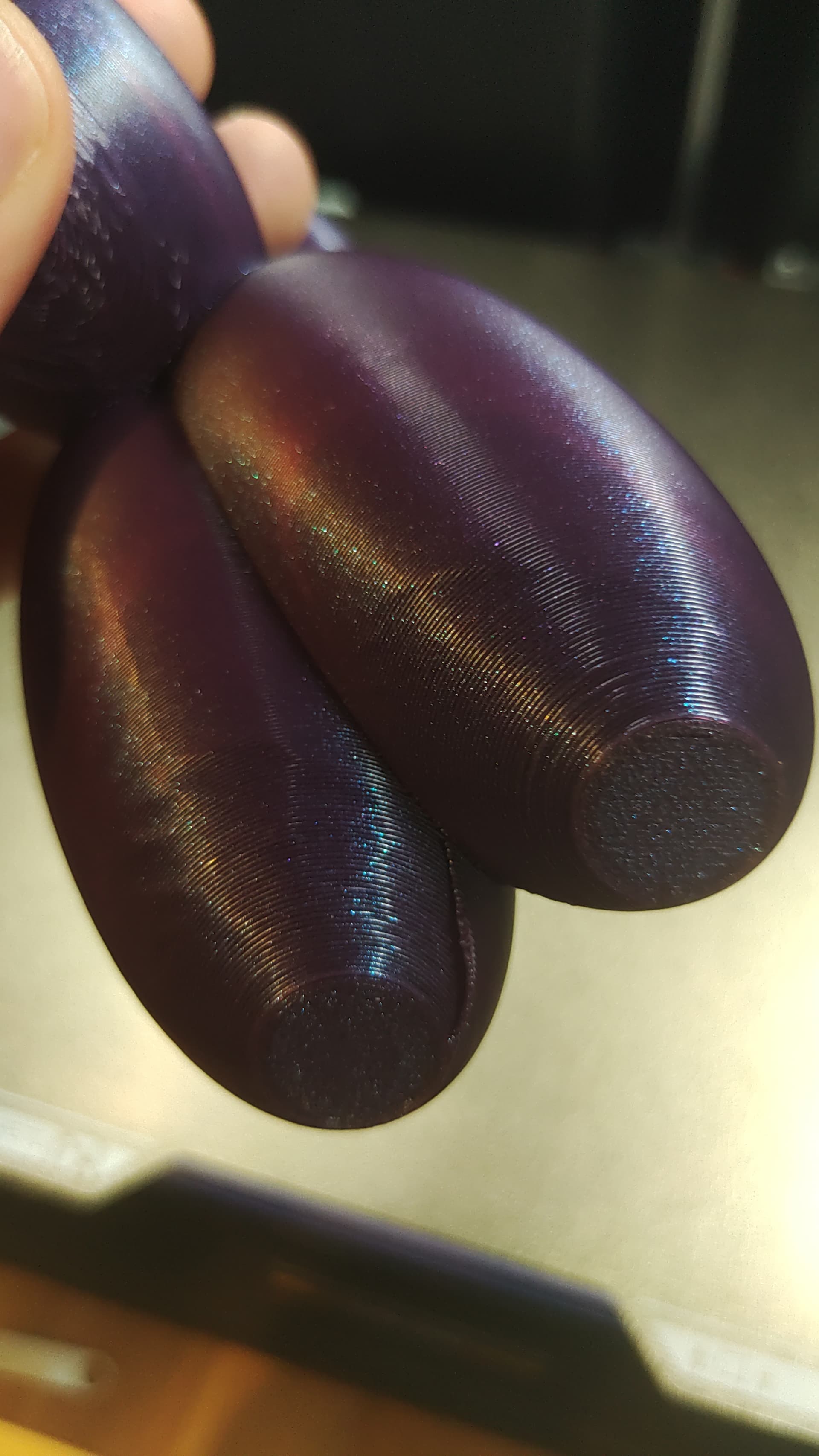

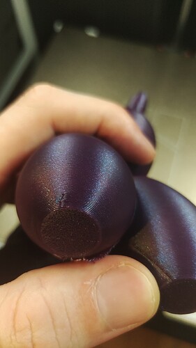

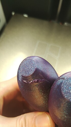

I have noticed very weir looking z-seams on mainly round objects with the H2D recently. Has somebody a clue what this could be.
The rest of the print looks quite nice.
This looks like underextrusion as many ppl already mentioned. What can cause this…
wrong extrusion mulitplier - check
wrong k-value - check
low temperature -
clogged nozzle - check
what you could try is up the temperature to 250 or so. Might be a faulty thermistor.
Not saying this is the solution, but just something else you can try.
I have seen this happen when ppl used a hardened steel nozzle with brass temp settings.
(do you have a hardened nozzle and this is set to in Studio? But i guess this is done automatically with the H2D)
