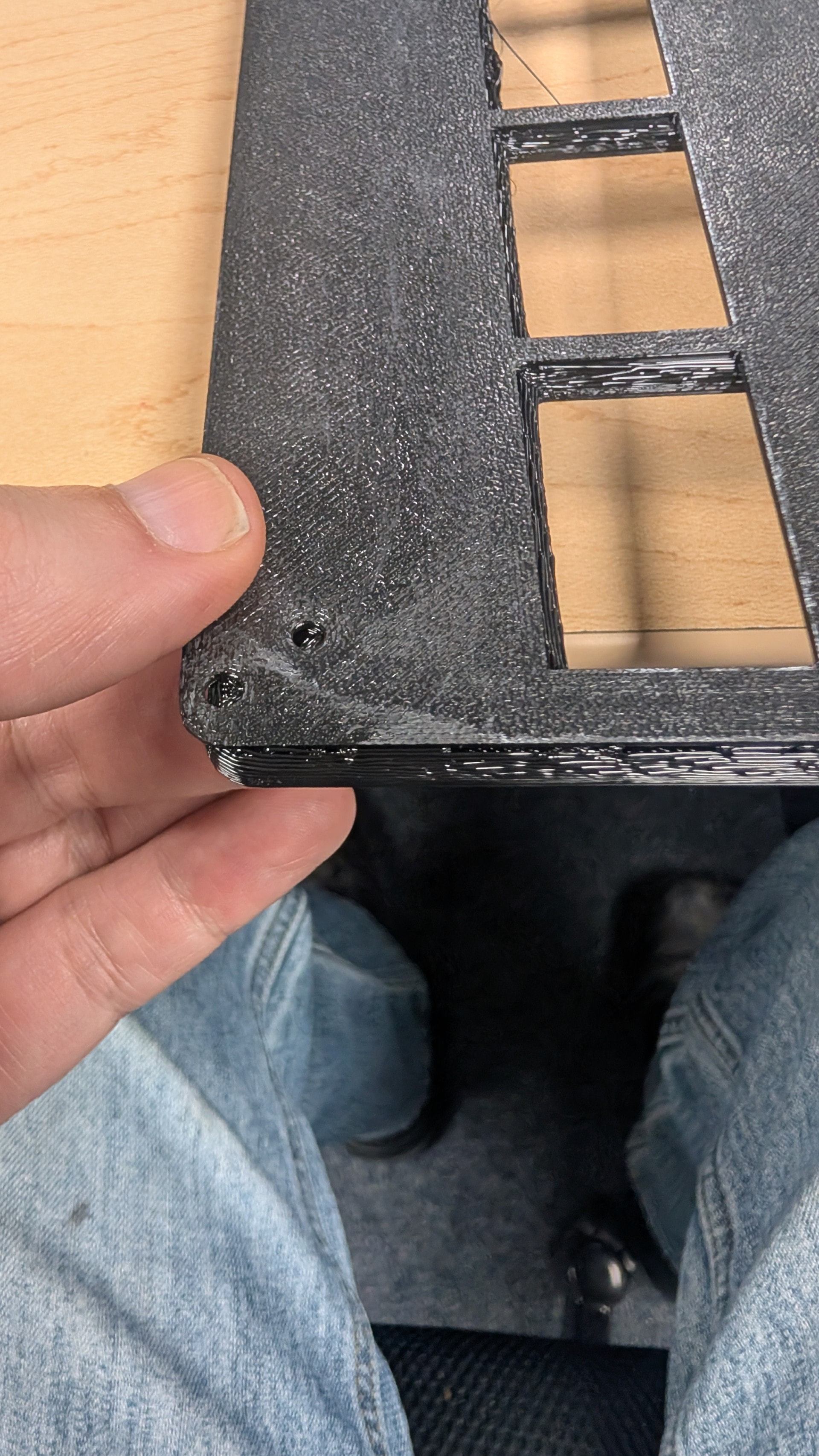

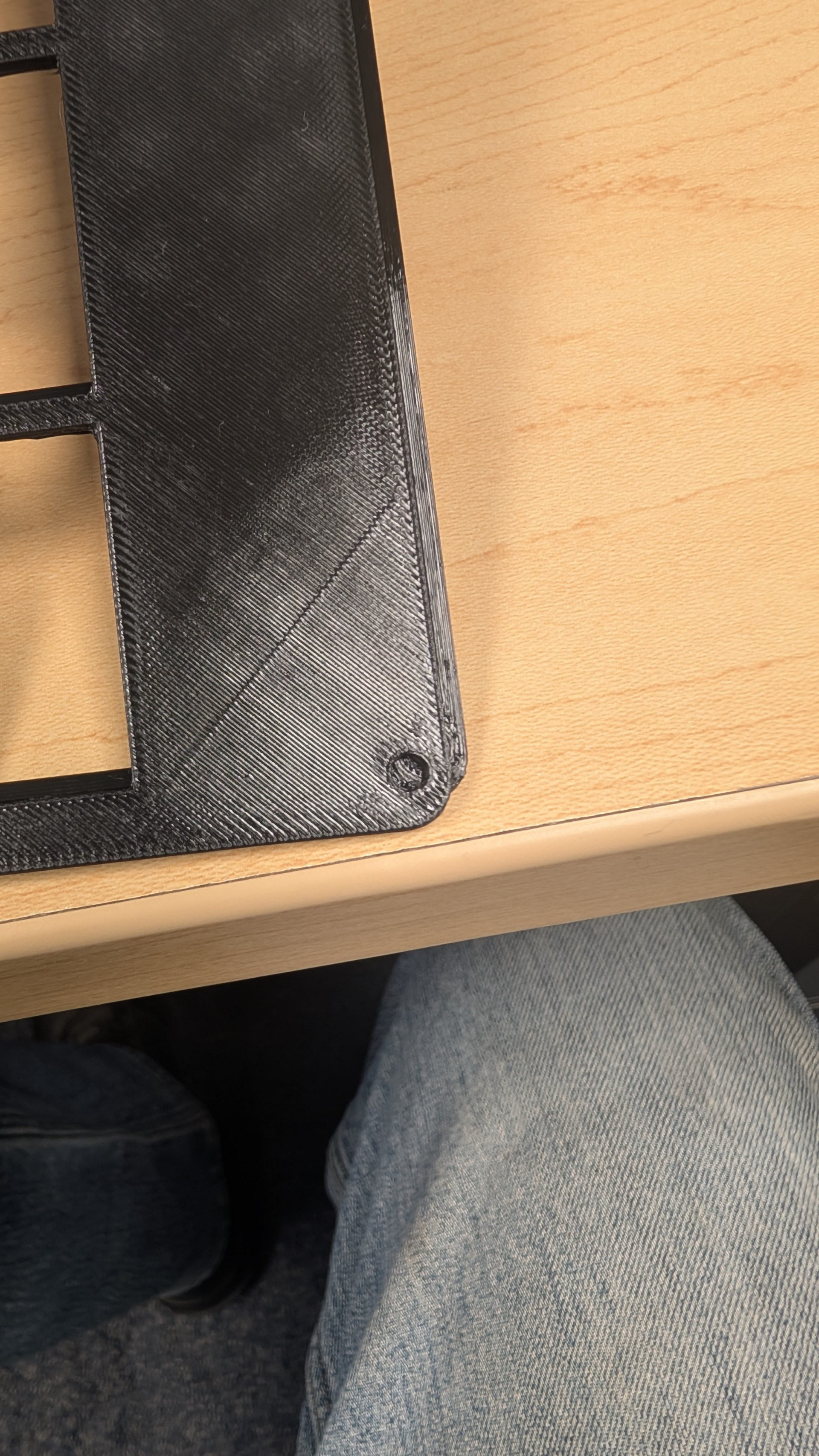

So, I designed and printed multiple copies of this same print previously out of both PLA and ABS with no issues whatsoever.

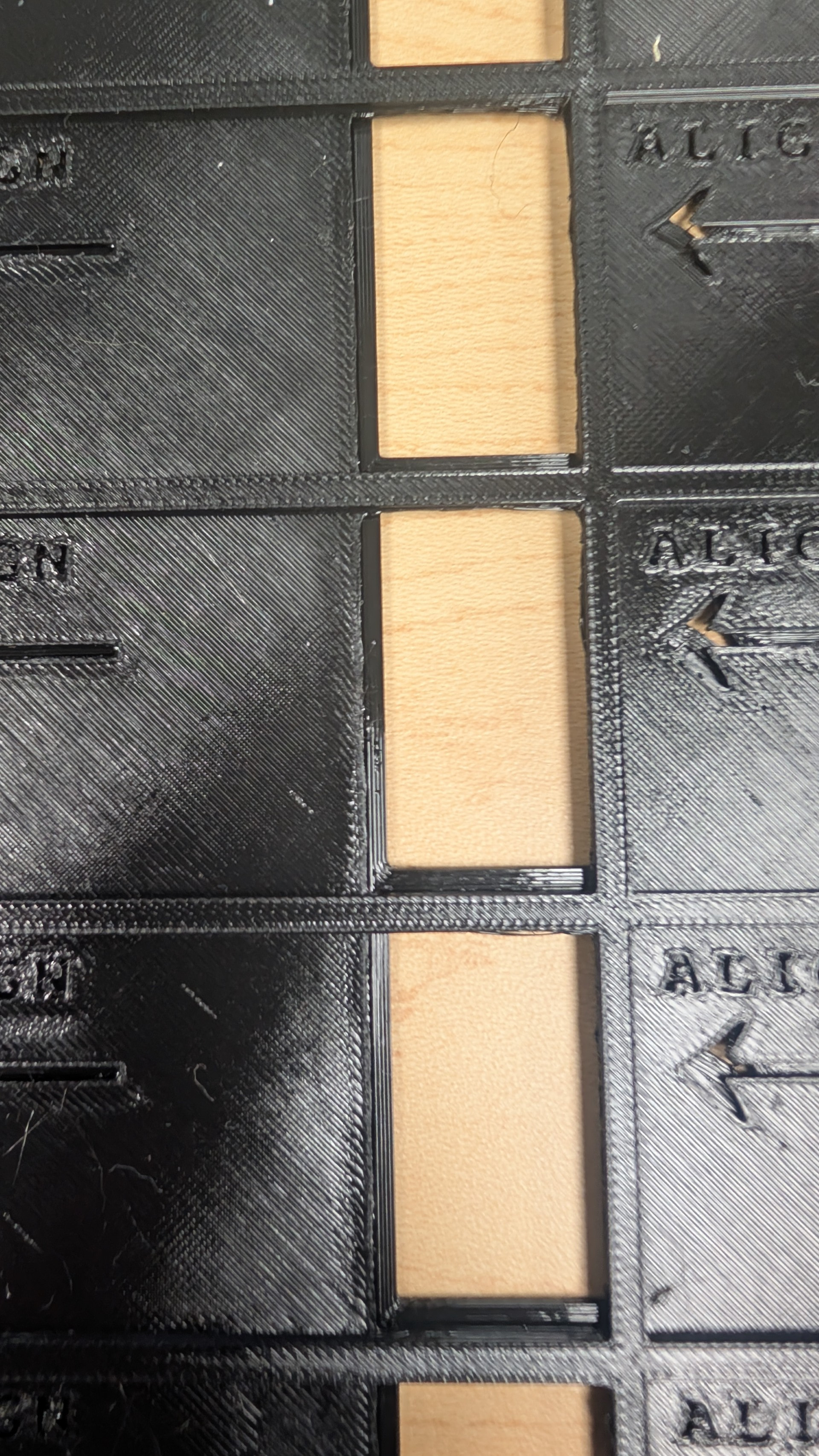

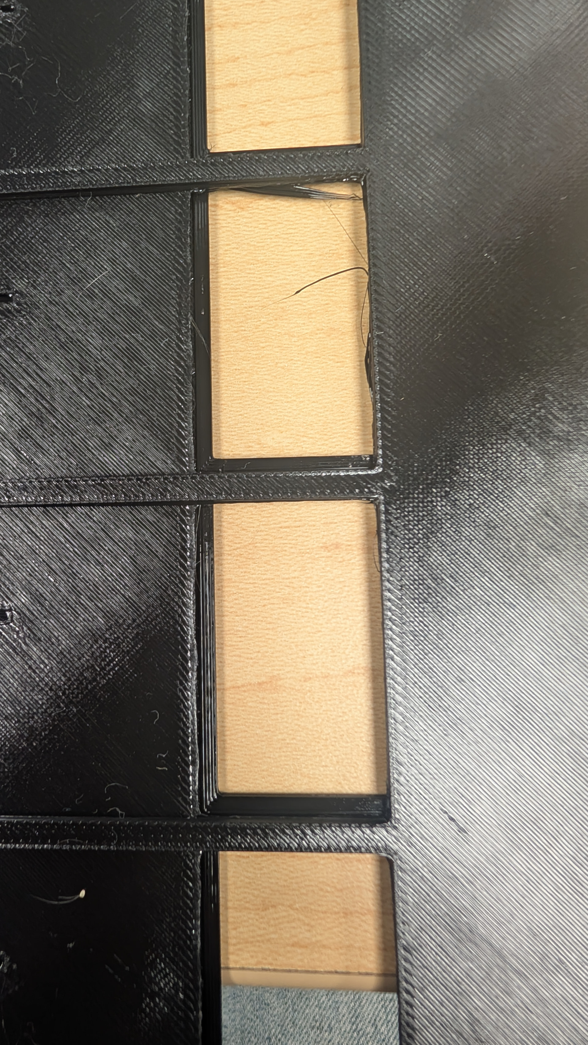

I printed a copy in PETG yesterday (filament has already been extensively dried and flow rate calibrated) and got a messier result than expected. The first few layers printed in one spot, and then the remainder of the print was offset by about 2.5-2.6mm on the X axis, and about 3.0-3.13mm on the Y axis.
The infill is fine so structurally the print is sound, but at the 1.25mm mark on the Z axis, the whole thing shifted the amounts stated above.
The printer has been maintained at the prompted intervals, and other than the occasional spaghetti issue or a nozzle needing to be cleaned, this is the first major print error that’s happened.
The print is a jig designed to hold metal tags for laser engraving, just as an FYI.
The print is using the standard 0.4mm nozzle, layer height is 0.2mm at 15% infill, and I was trying to see if I could add the .3mf so you could see it, but my work’s email system apparently believes that 3D print files are somehow going to be the cause of the undoing of the entire world and blocked it, requiring me to contact an administrator for release. Working on getting it fixed now.

Just to be clear, the print repeatable “shifts” when printing PETG or was this a one off case?
It shifted VERY slightly on the one I made yesterday morning, but it was almost unnoticeable. The one that was started after that (the one pictured) is noticeably worse with a greater amount of drift on far more layers.
EDIT for clarity: Yes, it was on the PETG prints that this issue has occurred so far, and glue stick was used to help adhere and prevent warping.
Okay, to me that would point to either the part warping and the nozzle hitting it or the nozzle is loose and moving. Is there anywhere on the print it looks like the part lifted from the bed?
A loose nozzle can do this too and I think this is where I would check first. The screws holding the print head can loosen up.
I will check the nozzle to be sure, but there didn’t appear to be any issue with it I could see. Then again, I wasn’t looking specifically for an issue, so I could’ve easily missed it.
And the part didn’t lift at all; it was securely glued with the Bambu Lab glue stick stuff. I’ll check the nozzle and let you know.

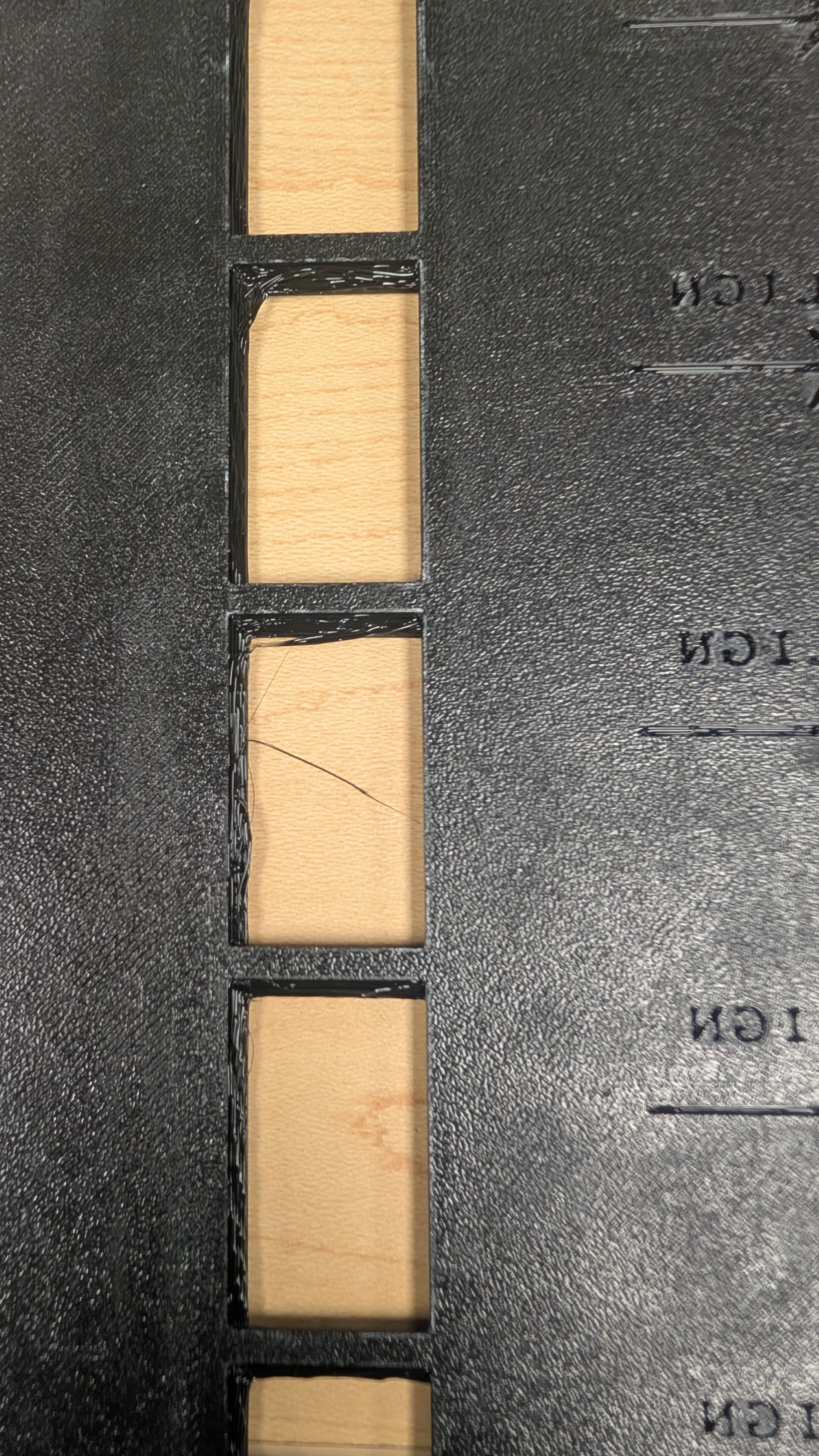

Okay, so the problem didn’t recur on the first PLA print I made. I used the exact same print file, changed nothing aside from the filament type, and it printed flawlessly. I thought maybe it was something with the PETG specifically that would be a cause (possibly?) but I had no idea what it would be aside from a defect causing a feed issue that it was trying to compensate for, and it somehow threw things off. Turns out that isn’t the case.
I did additional prints, PLA again, and the first one ran just fine but the repeat of the exact same print placed the first layer at the correct spot and then offset the rest of the print by around that same 3mm+/- offset again. Every bit of it aside from the first layer was offset up and to the left.
I’m beginning to wonder if there’s not an issue with the servo(s) that’s causing slippage under load at high move speeds or something, or possibly a belt skipping on the gear(s) during fast movements.
I’m going to run through every conceivable calibration and setup I possibly can on this thing and see if it makes a difference, because at this point it’s looking like a mechanical issue and nothing to do with any specific filament type or profile.

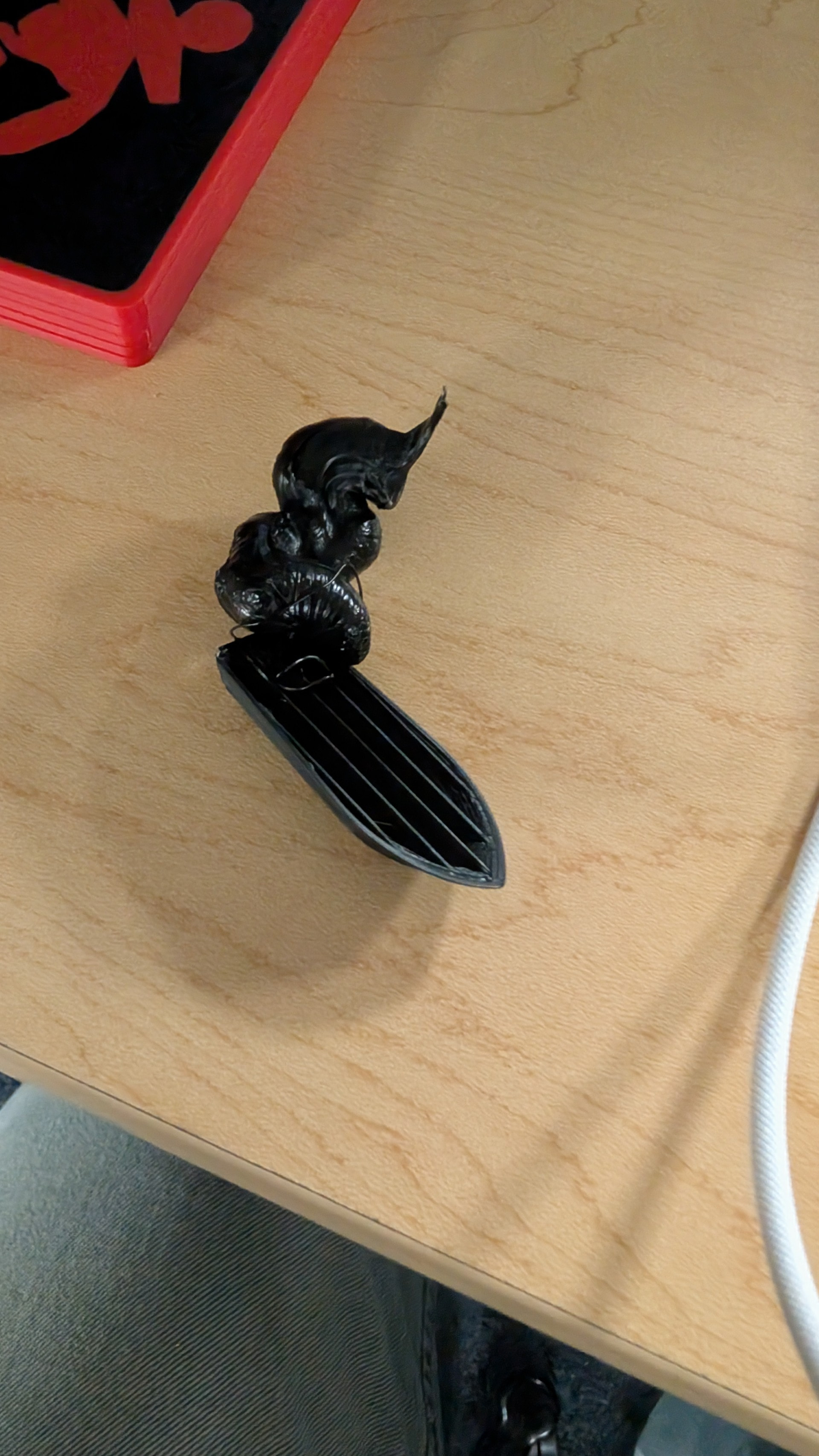

I just started a PLA benchy to see if there’s any issues with the layers. I’ll have results in about a half hour.
Well…that’s certainly different…never seen it dook out a whole glob like that before
