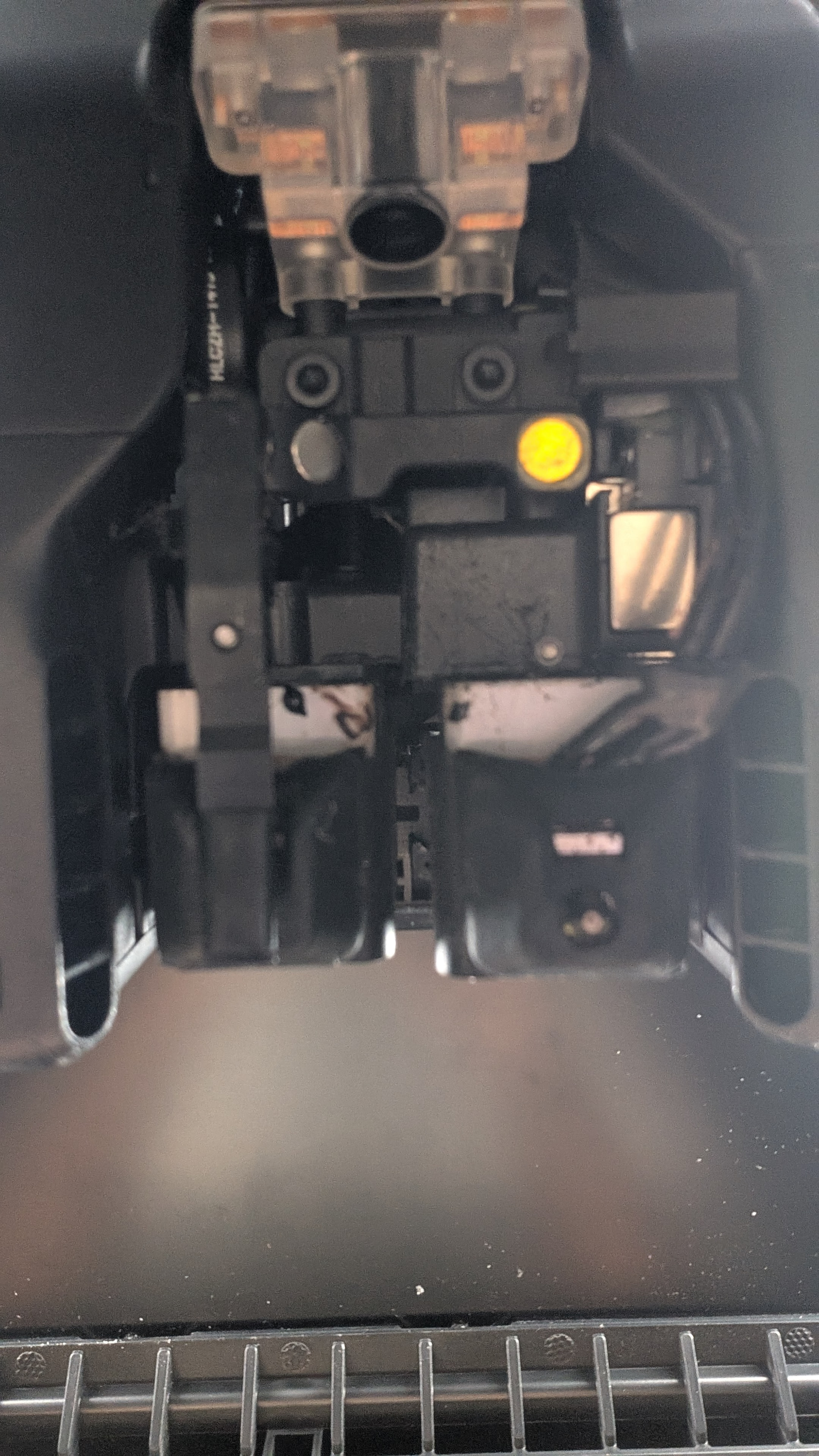

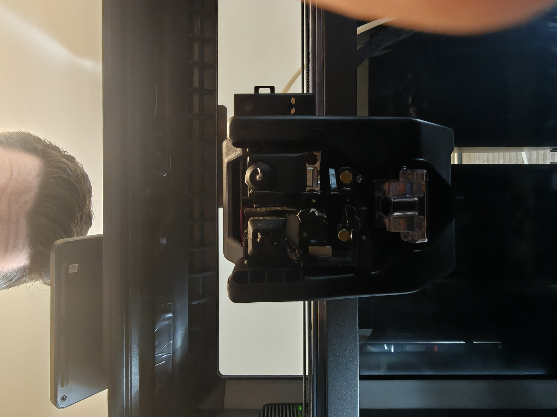

However, I checked out the nozzle offset sensor in the back and found a little bit of debris around the sensor and the small holes to the left of the sensor itself. I cleaned it off, ran a nozzle offset cal, and it worked fine.
Then I tried the 2-color Benchy again…and it messed up on the very first color change. However, I did notice that when it went from the primary color to the secondary and moved to the purge spot, it was NOT in the correct purge spot, and the purging filament was partially landing on the housing instead of going into the hole.
And it looked like it was off by about the same distance as the bad print offset.
Photos attached.

Do the 2 orange levers on the rear of the purge station move freely?
Maybe there is debris stuck somewhere.
Yeah, they moved freely without any hitching or weirdness.

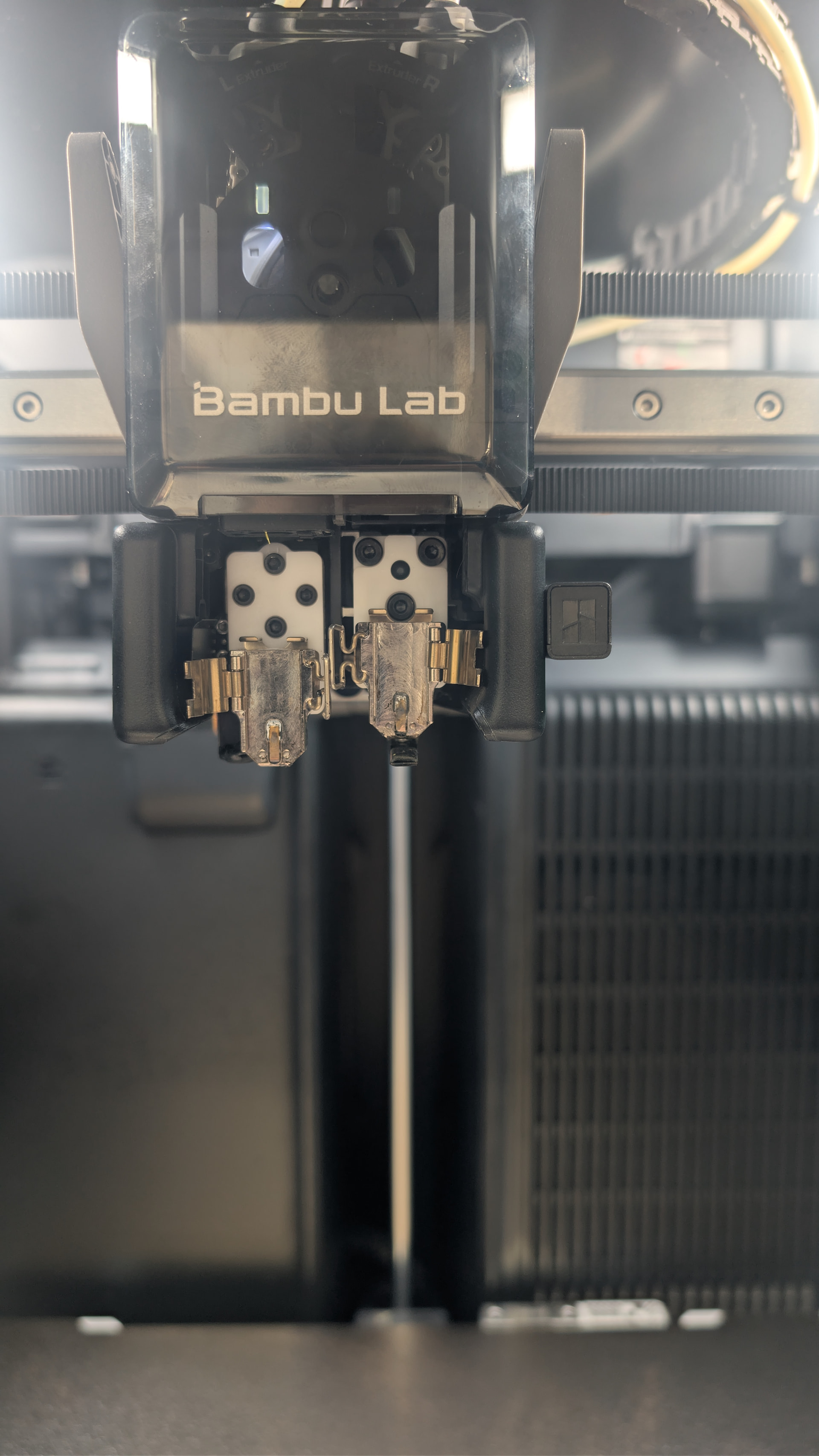

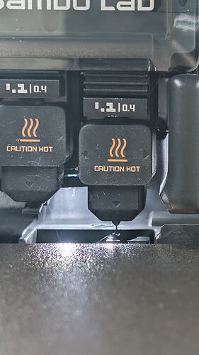

Can you take a picture of the two nozzles from below - so your phone is looking up at them?
Once it finishes the calibration setup then yeah. It’s doing the 45 minutes or so of setup calibration after a reset at the moment

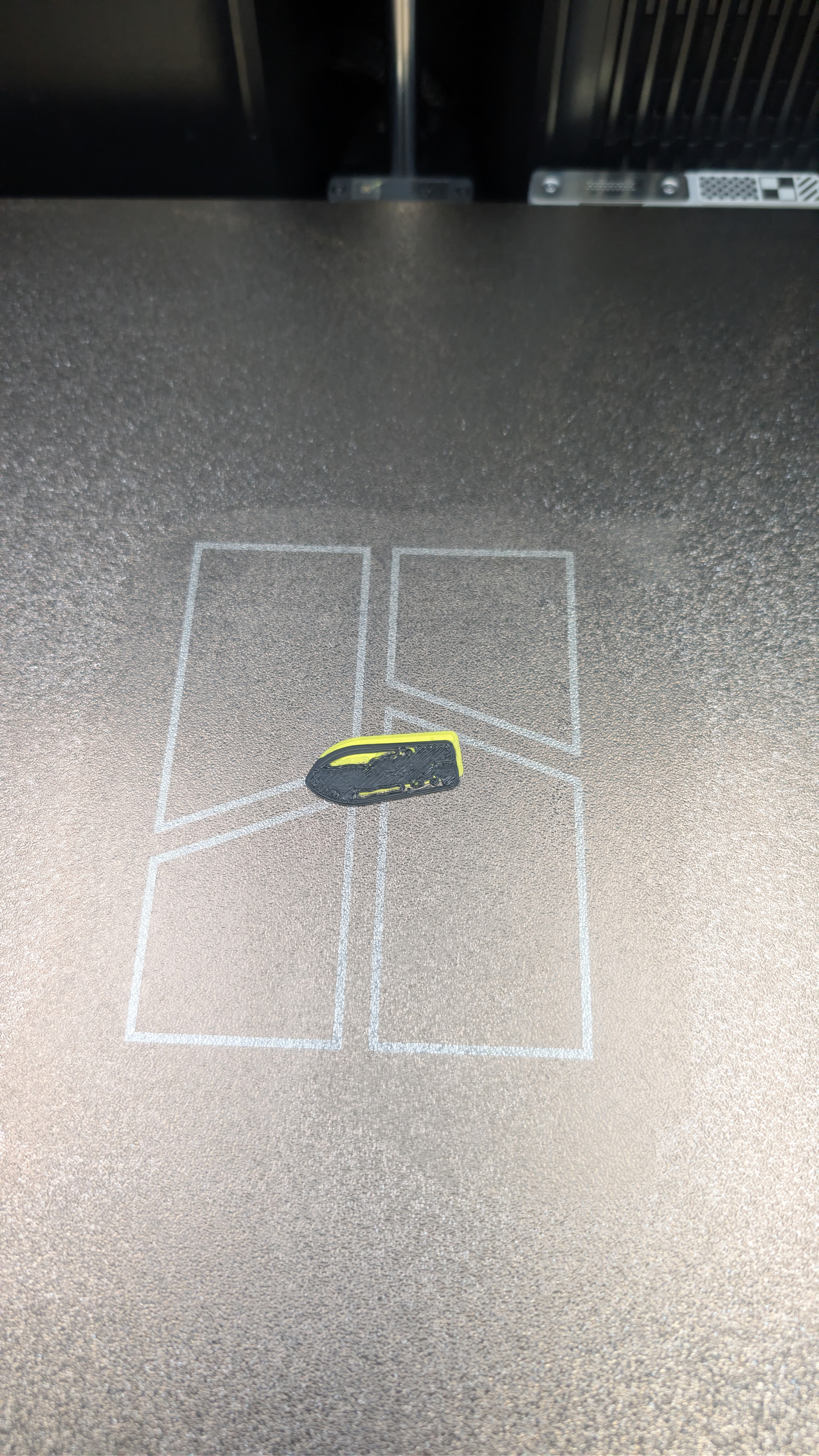

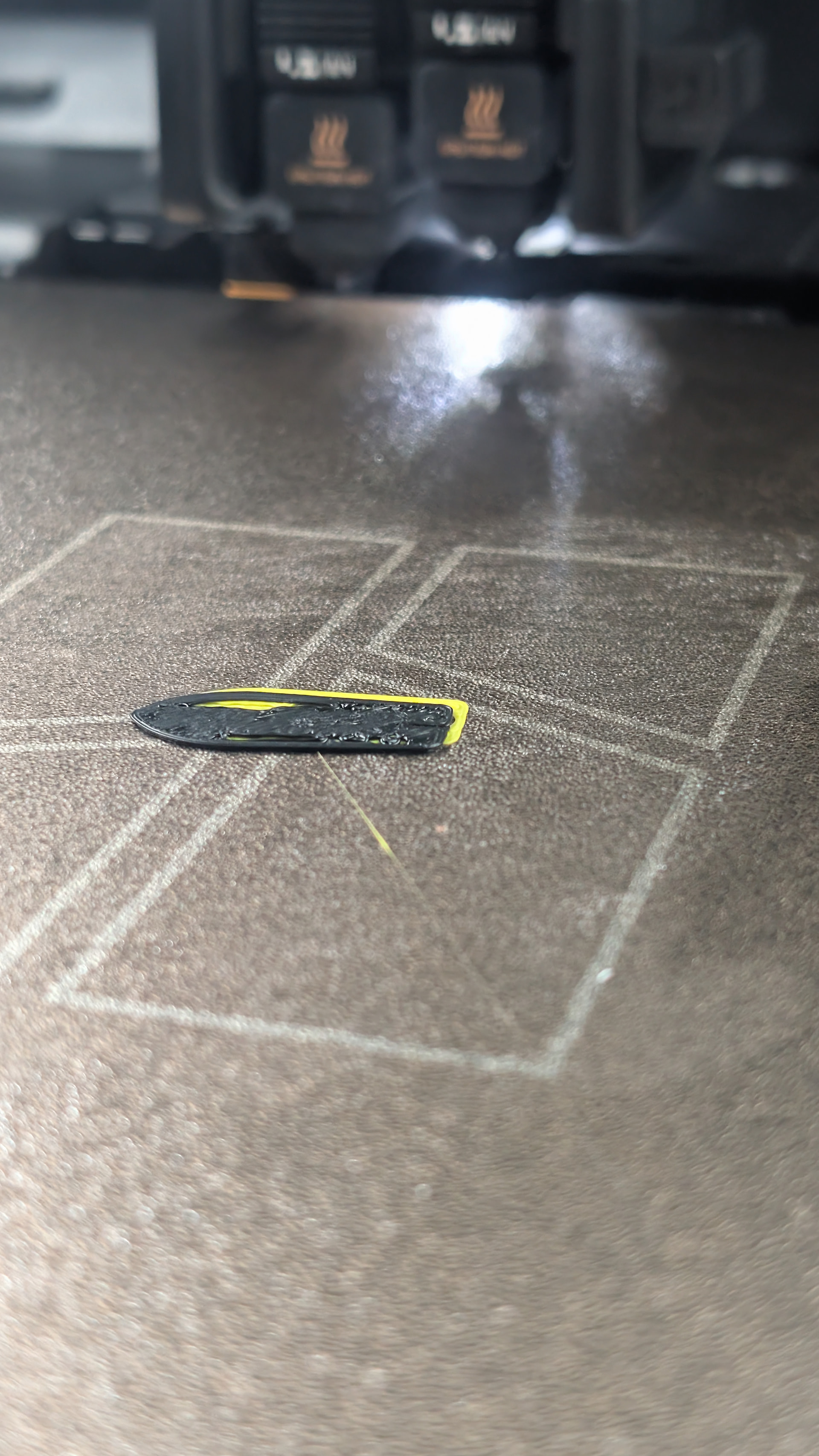

Full factory reset, recalibrated as if it were brand new, same issue. Photos attached of the underside of the nozzles as well as of the first 2 layers where the issue is occurring.

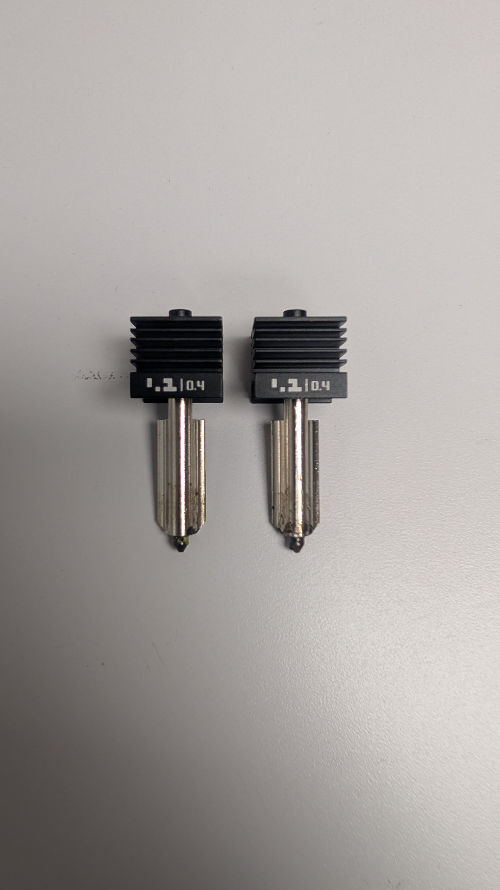

Can you take both hotends off and take a picture of them side by side? And take a picture of the nozzle attachment points?

EDIT: Also, just for giggles at this point, I swapped the nozzles with each other to see if the problem follows the nozzle. I don’t think it’s necessarily a nozzle specific problem, but I’m running out of things to try.

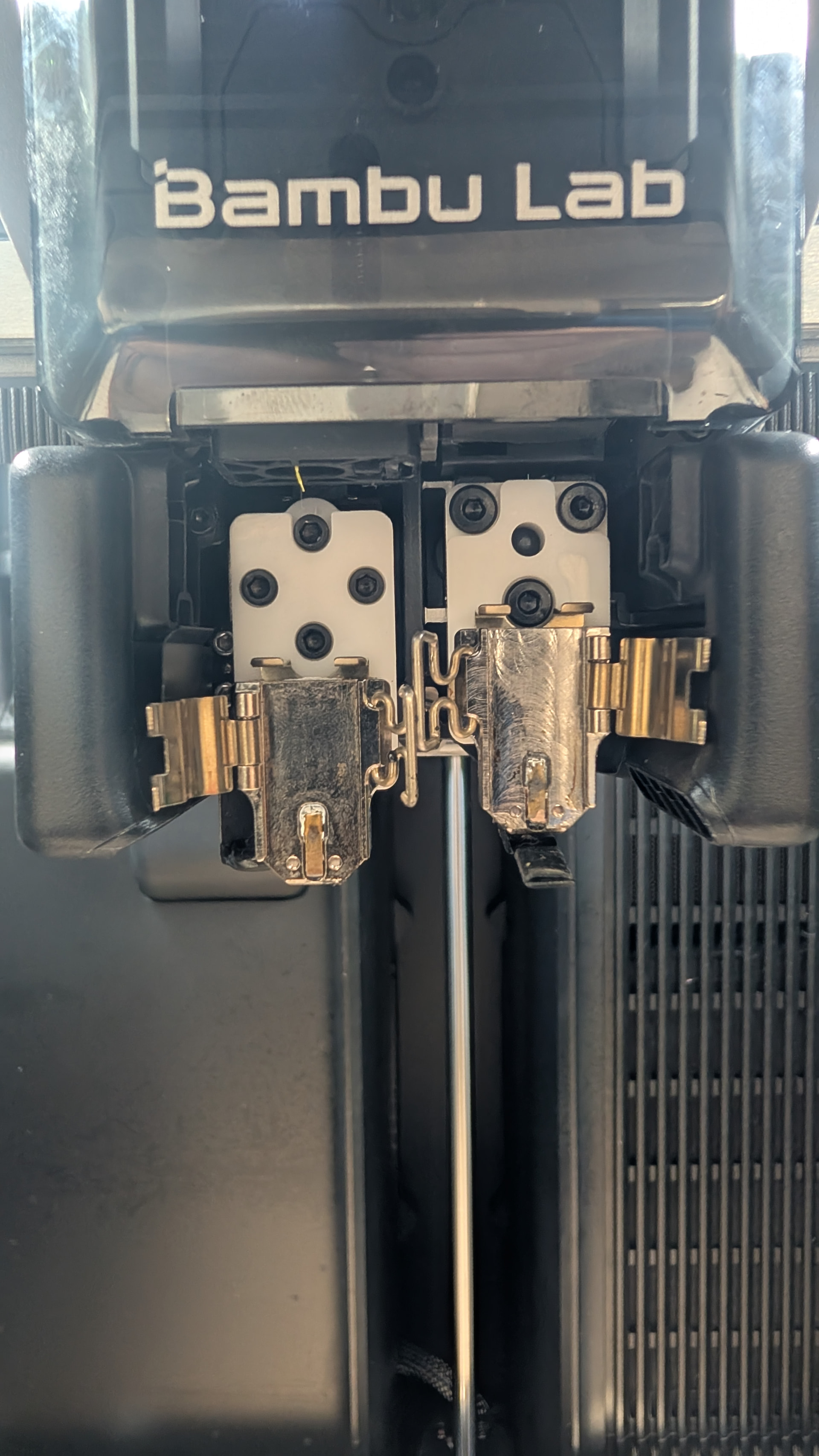

Can I get a side profile shot of the hotends? And the same underneath shot now that they’re removed?
Also - I don’t have an H2D but on my H2C the two nozzle tips are aligned on the same Y plane. I don’t know what the H2D should be like, but yours are really offset a lot.
I suspect either that’s abnormal, or the offset is normal but the printer has an internal offset value and yours is wrong.
Perhaps someone else could get a similar shot of their H2D?
It’s going to have to be Thursday but yes I can get those pictures. About to be leaving for the day and I’m working offsite tomorrow. Really appreciate the assistance in trying to figure this all out.
One last thing for the day…after swapping the nozzles with each other I tried another 2-color Benchy…and the offset on the Y axis stayed the same, but the X axis offset went to the right instead of the left. So same as the photo before, but the black part is offset in the opposite direction.
Starting to think I have a physical problem with the nozzle.
