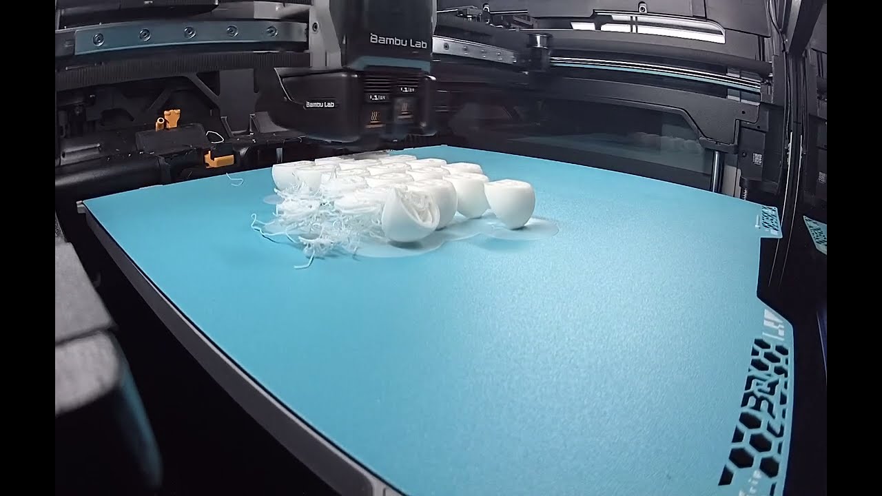

H2D, Prints keep getting knocked off the plate by the printer head?

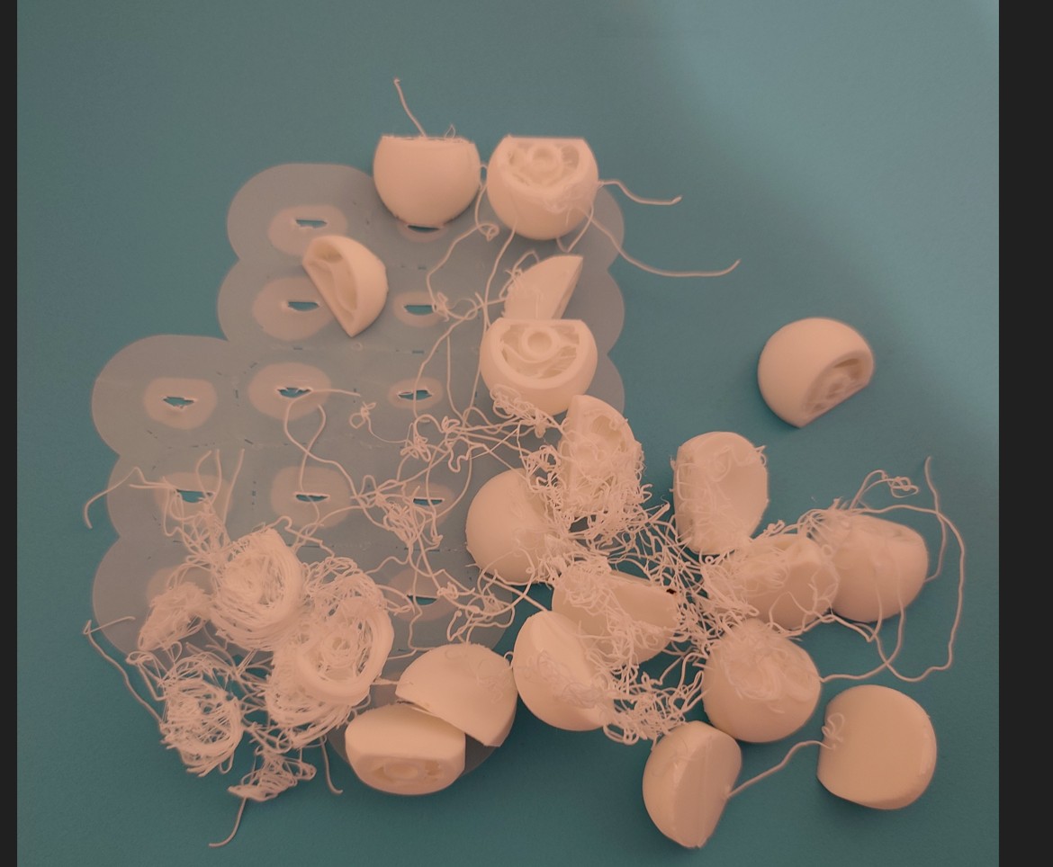

Tried cleaning plate, different plates, (pictured is glacier, has good adhesion and 2 brand new .4 hardened steal nozzles) but still, the printer keeps knocking off the print half or 3/4 way though on most prints. Here we have Bambu white PLA. Pretty standard stuff.
In general, I can’t ever print anything vertical, horizontal usually survives ok.
Any suggestions on things I could check? Possible over extrusion causing the top of the print to be bumpy so the nozzle bumps it or something? Any hints appreciated. Will try to upload image and time-laps. Most settings are default.
As you can see in the image, the pieces have been ripped from the brim that is still on the plate. They are not just falling off the bed or something. The head is hitting the top of the print wrong for some reason.
Timelaps only shows that it failed suddenly and leaves spaghetti when a piece gets knocked off. This print I turned off the a.i. detection and let it continue to knock the rest the pieces off (I was hoping some would make it at least… )

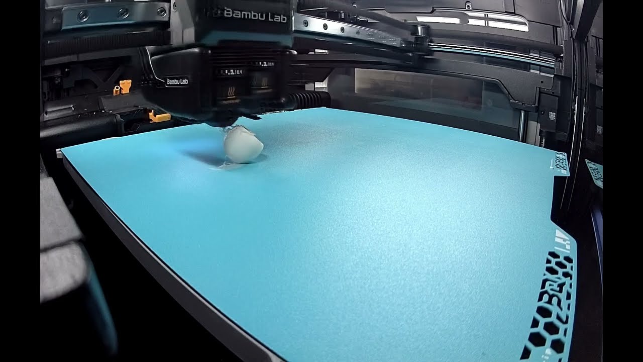

Found the video it records and exact first fail-
@20 seconds- watch the left most eye part and you can see the combo of the head moving and the bed going up and down causing it to hit the peice and it gets pushed.
Then the next time it comes around at 1:36 it tries to add a new layer and topples it.

Thats definitely an issue with slicing. not a bug, just settings. your point of contact with the bed is way small. Essentially the pressure from nozzle + material are moving the center of weight out of the actual center of model, making it wobble. Around the 15 second mark you can see the piece far left, 3rd row that has a lifted side, which later colides, and thats the result.
try to add a small ring of supports (preferably tree ones) at least for the first 3-4 mm of height, around the objects, so that it “sits” in a nest" . this will provide better stability than any brim

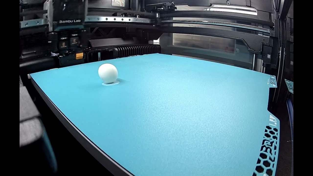

Ok, I have it down to a single test case, which it fails consistently at, about 30 min in, from the ipcam folder - seems like right when the bed bounces up/down a little.
doesnt look like any bouncing to me, just over extrusion caused seam blob bumped the nozzle I think
Over extrusion was my thoughts also- though I’m not sure how to adjust that on the H2D. But I think it was the Variable Height Feature I had on that was getting me! I Turn that off and she prints.
Turning off VLH (Variable Layer Height) fixed the issue.

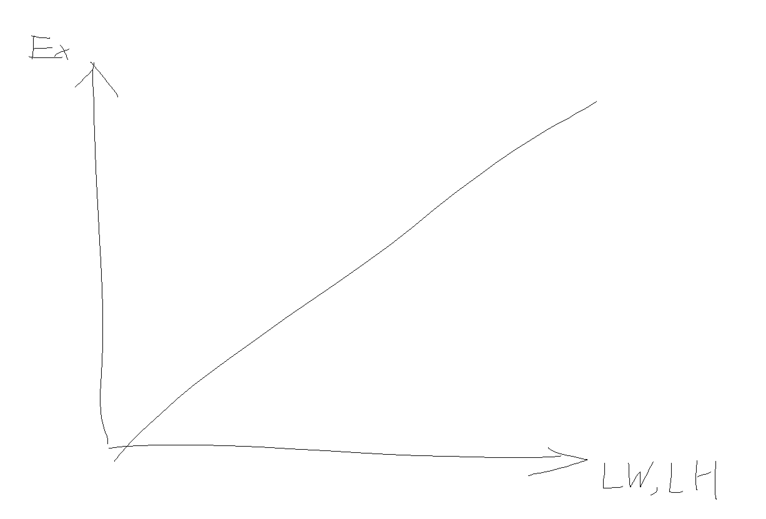

vlh doesn’t work well with some filaments especially not perfectly calibrated
Check my post here
Ah, so your saying I need to modify the extrusion when adjusting the layer height- is there a way on the H2D to adjust the extrusion?

Regarding to extrusion rate adjustment for VLH, unfortunately no there is currently no way to adjust the flow rate for different layer heights dynamicly. It’s using only one parameter (the overall flow rate) and scale using its internal model. Which, gets worse when the layer height gets too thin or too thick.
