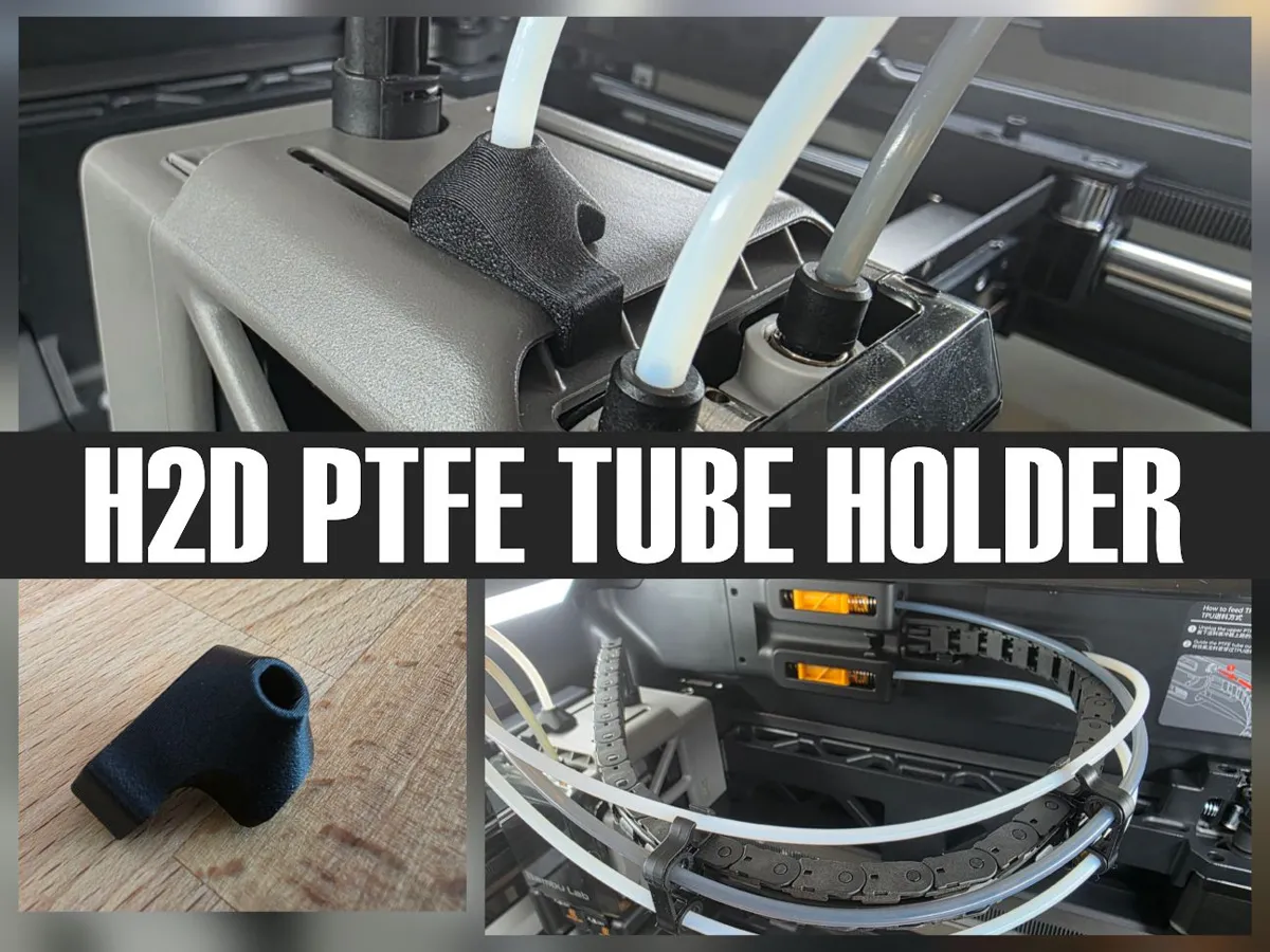

In my setup, I have the PTFE tube that runs to the print head through the rubber grommet, and directly on the outside of the printer I have a 4-in-1 PTFE adapter mounted. Then, at the print head (to avoid disconnecting the PTFE for left/right switching), I’ve printed a small PTFE holder that attaches to the print head.
Use one of the many PTFE holders like this one:
That is, if you choose not to install a splitter on the inside. This way, you can have everything mounted at all times. However, I’ve chosen to manually switch at the print head, since I sometimes use the left extruder for more brittle filaments and the right for TPU/PEBA, etc.
