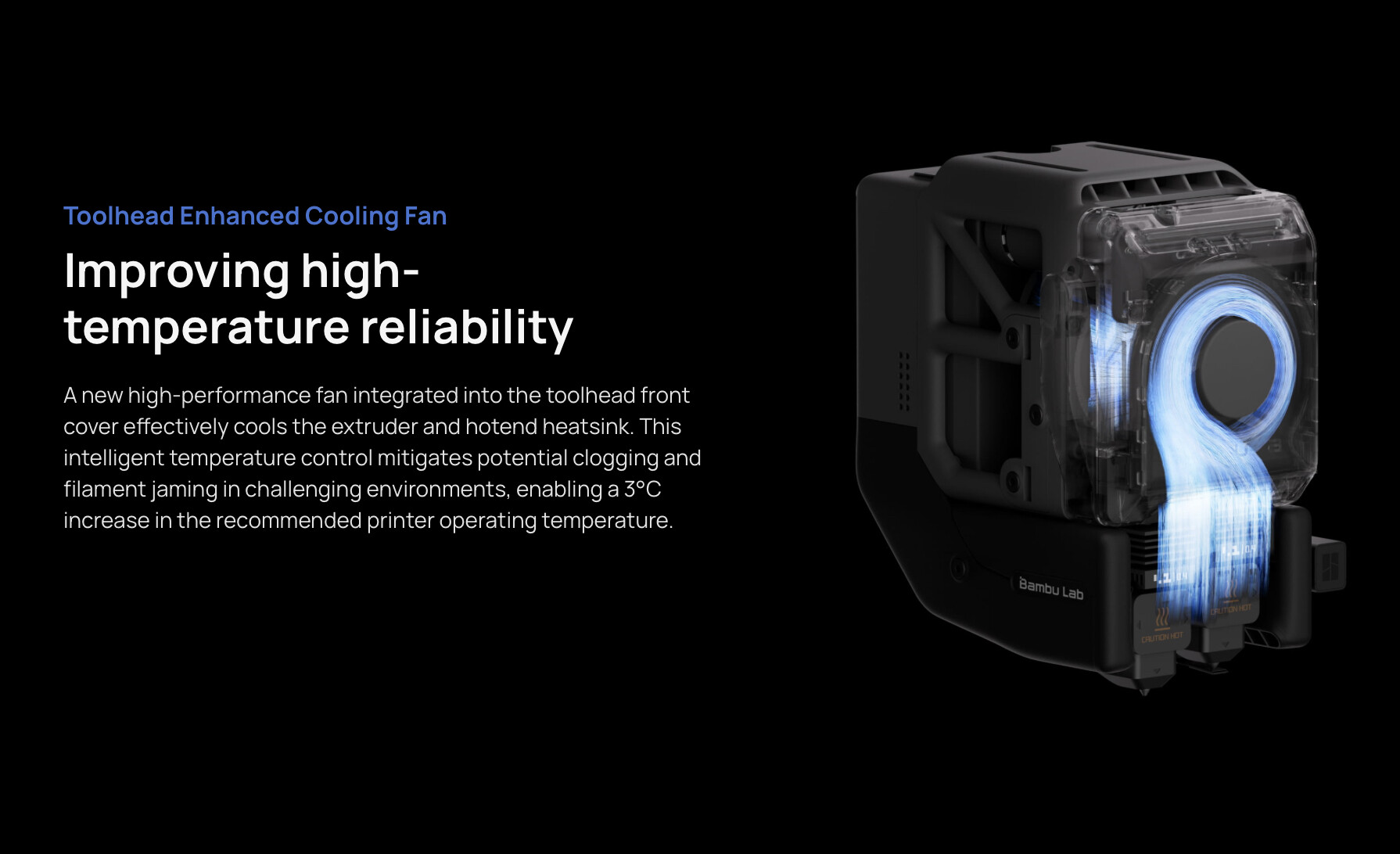

Also this, a new hot end aux cooling fan, but 3c is nothing special though.
We suggest everyone reading the FAQ for more details. :grinning:
Well, thank you for sharing. Is there an official release date for the updated cooling part which you can install from the H2D Pro onto the regular H2d ?
Is called: H2D Toolhead Enhanced Cooling Fan
Looks like it will be sold separately and easy to install as it just plugs into the aux laser port:
“Yes, that’s correct — that’s where I got it from. I’m curious to know when it will go live and when you’ll actually be able to get it.”
The H2D is fully compatible with the Toolhead Enhanced Cooling Fan and Tungsten Carbide Nozzle from the H2D Pro.
After the necessary firmware updates and production rollout, both accessories are expected to be available in the official store in Q4 2025.

Thanks for the info. There is some inconsistency between the temps, on the H2D Pro page it says 3c but on the wiki it says 5c.
good to know both can be purchased and installed on H2D.
Based on the wording, the cover plate fan (Toolhead Enhanced Cooling Fan) is just there to help alleviating heat creep related problems (esp. PLA) when the room is too hot. H2D did a pretty good jobs for me but I suppose some really do leave it in 40C garage heh. Not a fan of the grey looks.
Or does anyone think it will provide any additional benefits?
The information was corrected.
The difference is 3°C

No pun intended right? Im not a fan of the grey fan either. LOL
It will help with heat creep with all filaments as the nozzle cooling fan is always running. Will improve things with high temp PPS/PPA most likely although I have not had problems thus far. I only had an extruder clog once when switching from high temp to low temp material without sufficient cooldown time. Perhaps with this new aux fan that would not have happened.

We were talking about the new aux hot end cooling fan (not the H2D Pro itself), does not look as cool as the translucent smoke H2D cover! LOL
