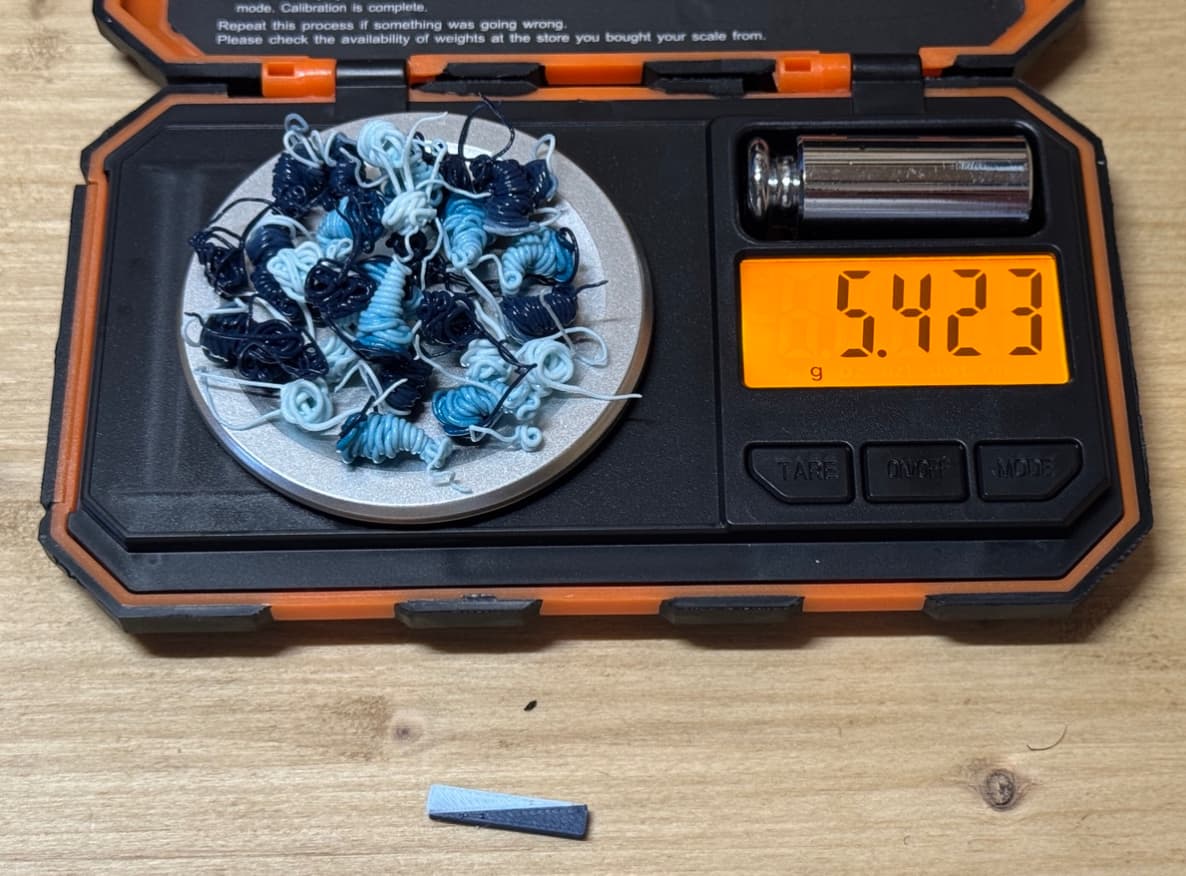

Hi,
I’ve just made a test today with a small sample and it still does not take into account the purge multiplier in BS…
This is the purge waste
While in the slicer with purge multipler to .3 on both nozzles
It does say 5.4g when purge multiplier is set to 1.
Let’s see what their support has to say.
Last time they confirmed it was a bug, but it appears it still is
