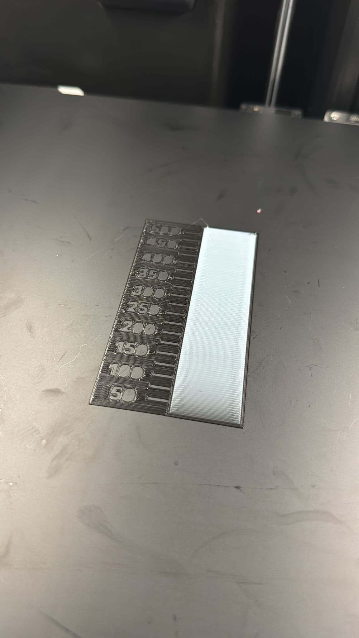

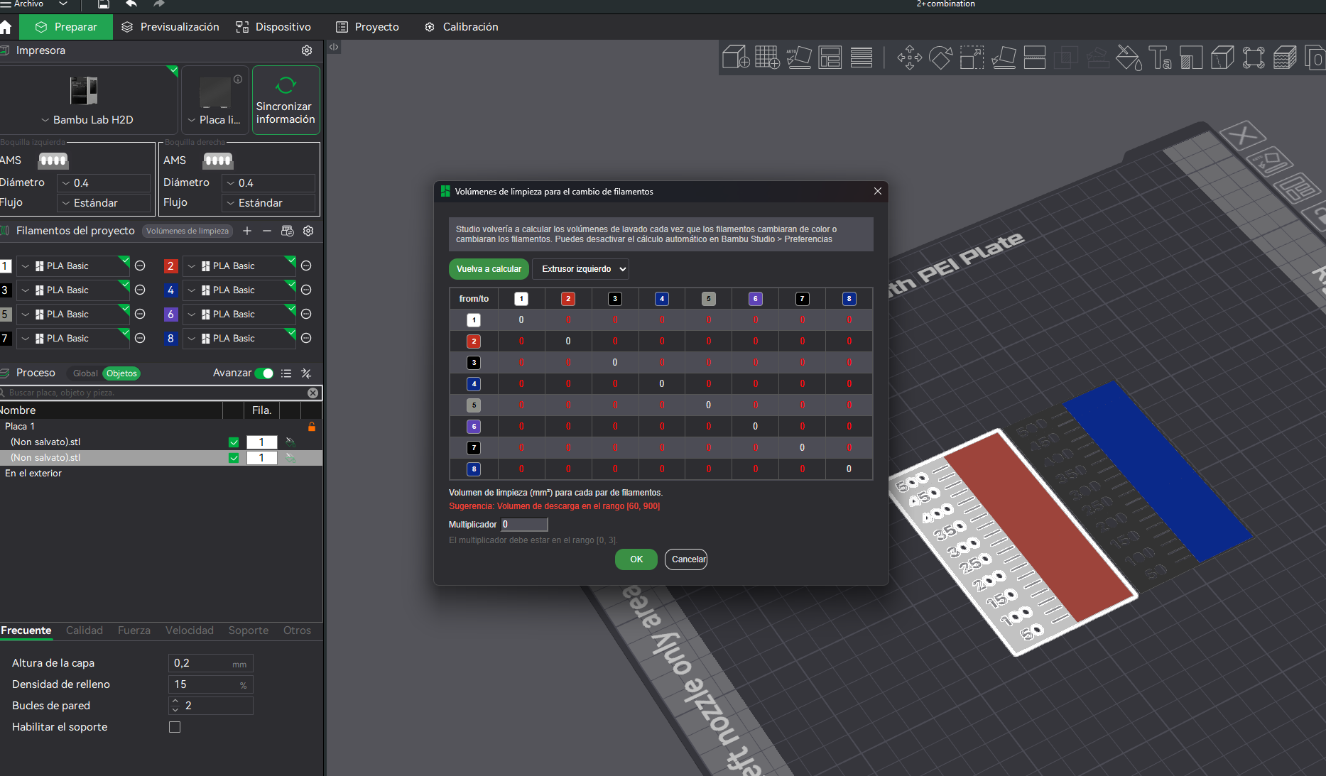

Yeah in my case i can agree, i was 1 day trying to figure out why my color calibration prints where not working when i changed the flushing volumes, its ignoring the slicer settings 100%

i have everything set to 0 and the printer stills purguing a lot and i cancelled the print directly.

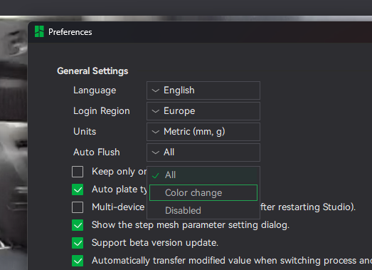

If you want a “fix” i discovered today making some tests if you put the slicer languaje to english plus
in preferences you put on color change, is when your flushing volumes are starting to work, tell me if this works for you guys.
nevermind stills the same
