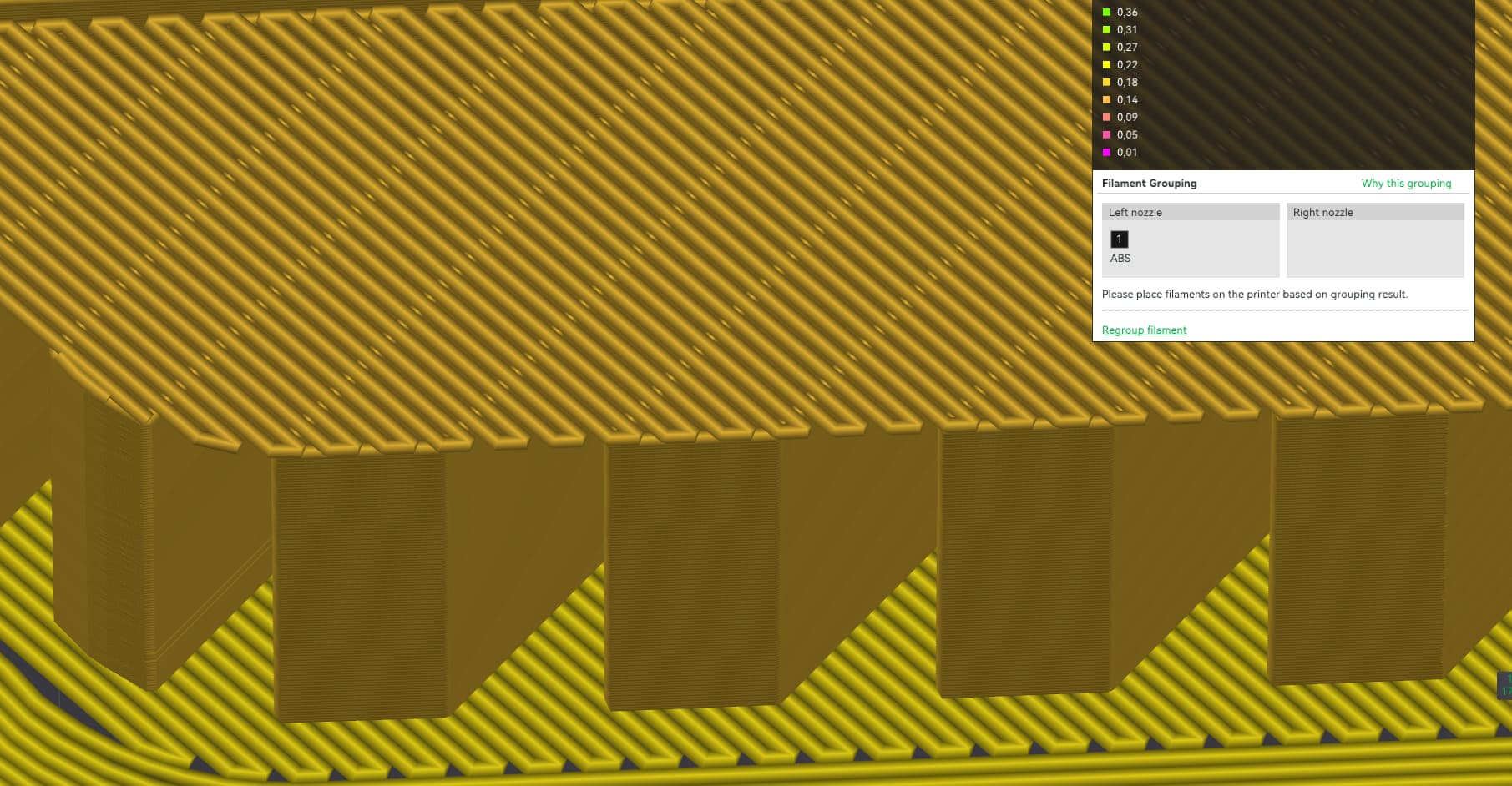

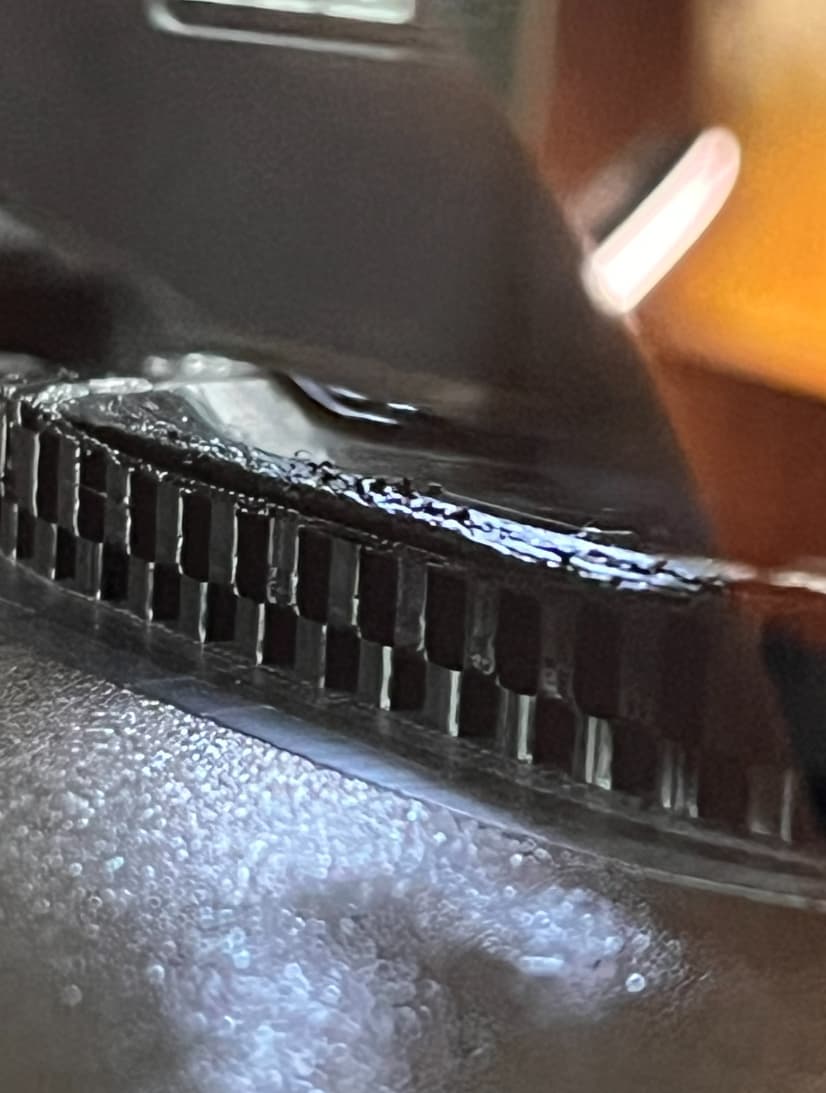

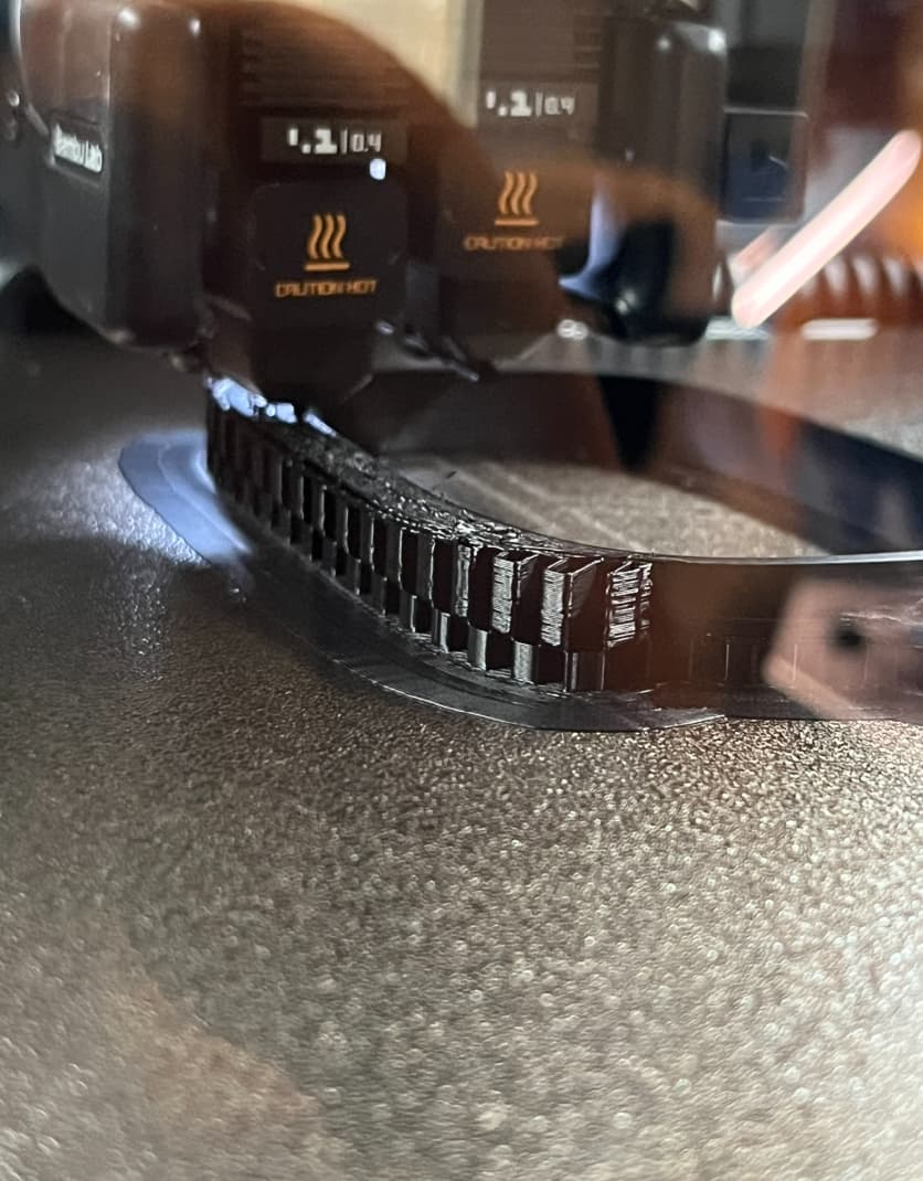

H2D Support Failure
Interesting

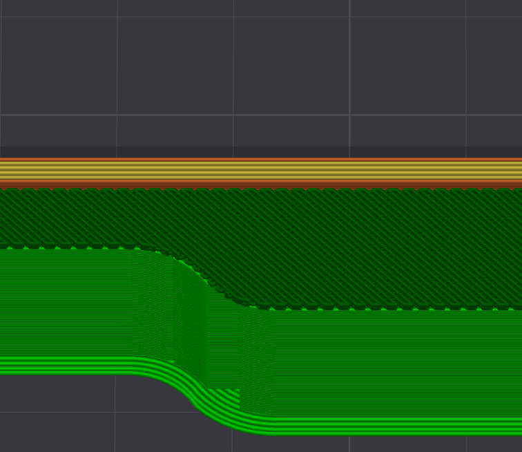

If you inspect it in the slicer preview, is the “support transition” the topmost interface layer, or the bottommost one? What is its layer height? Does it run at a different speed/fan?
its the darkest of the greens, the “bottom” of the interface sandwich
Layer height appears to be .16 with independent support layer height off
and 0.30something with ISLH turned on

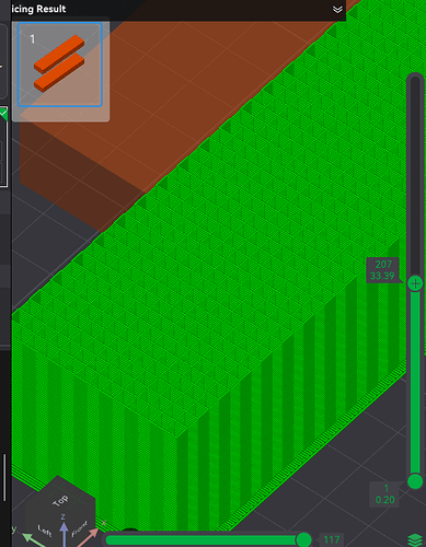

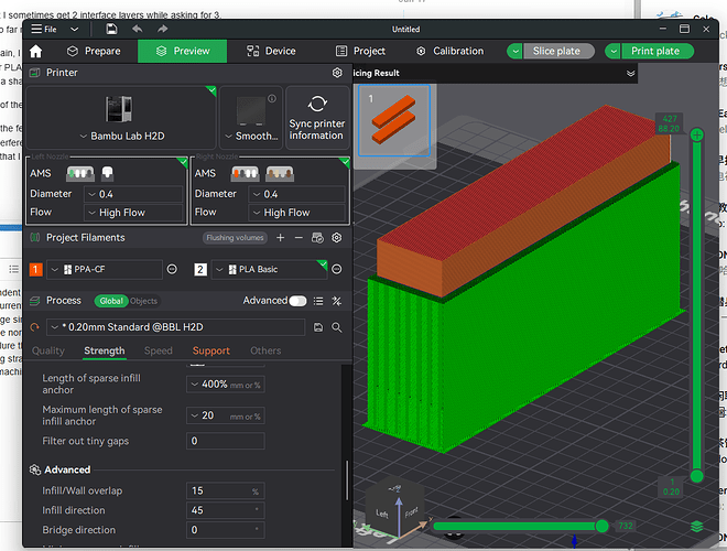

Additionally the support interface seems to ALWAYS be vertical to the support structure lines, in these screenshots i set pattern angle to 45 degrees, expecting only the base pattern to rotate, but all of them did.
The interface does rotate with the pattern in Orca
But it stays under angle to the structure
I suspect thats what cause the support structure to collapse under its own weight?

However, we have to admit that the current status of support generation is a hot mess. It has went completely garbage since 2.1.0 as default tree supports would now grow into the model. The normal support would also be generated very unreliably causing the kind of failure that OP is having, unless you tune the support settings carefully to avoid long straight single layer lines. It’s not only just bugging H2D, but also other bambu machines.
E.g., for this print this support would highly likely to fail because it’s basically printing 1 single layer of support line that is weak, and potentially get not enough cooling or too much cooling at the same time!

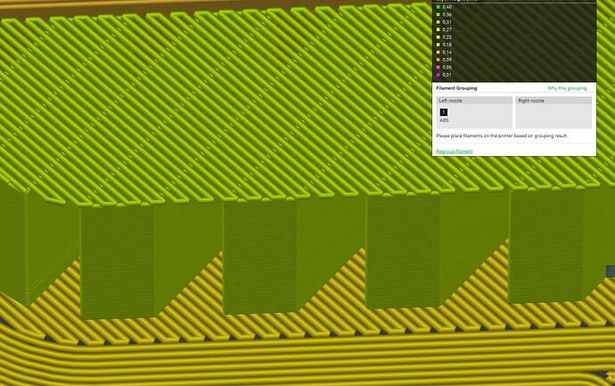

My current solution for this particular issue is to either adjust pattern angle for a specific part, or change the base pattern type to either Rectilinear Grid or Honeycomb. Honeycomb is a bit too slow and using too much filament, so most of the time I just use rectilinear grid instead.
This is what rectilinear grid looks like. Much less likely to cause that issue.

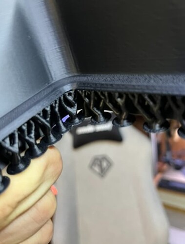

Update:

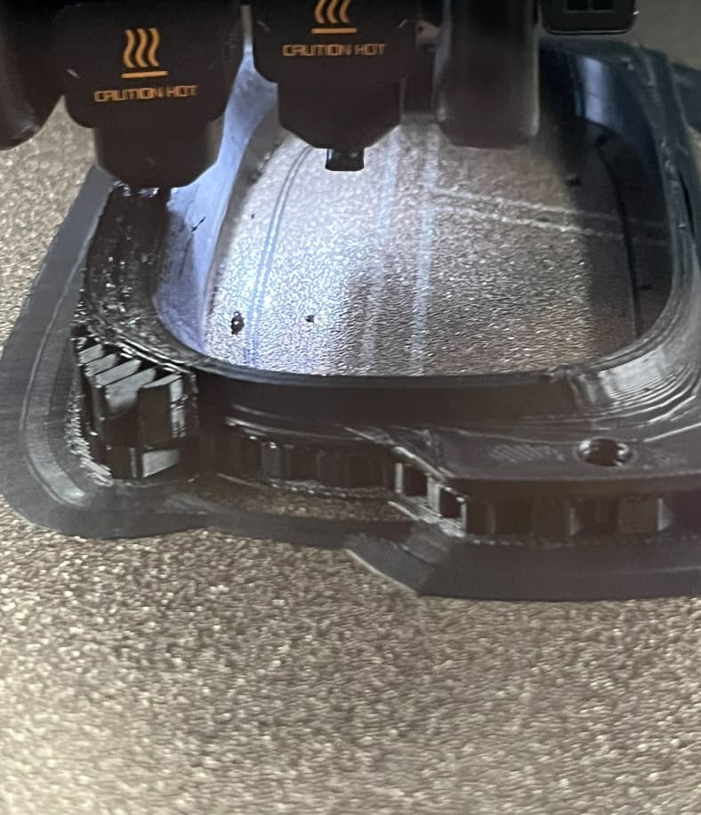

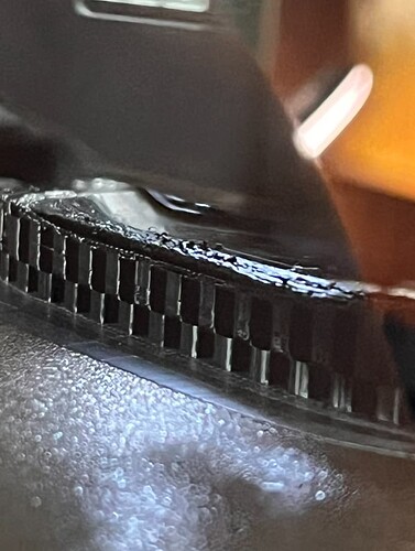

Tree supports worked better but still not perfect. Again where in other machines the job is done perfectly everytime, here the supports failed to 100% support the bridge and thats visible on the failing ironing on top (ironing normally gives me a nearly seamless surface that you cant say is printed)
Moreover, another attempt , using snugg normal supports under 45 degree pattern angle.
The pictures speak for themselves.
Also this is without indepedent support layer height.

Answering the question as to why it fails on the H2D and not the other machines is going to require diagnosing exactly why the failure is happening in the first place. That seems to be the question you want answered more than how to workaround the problem and move on. Maybe if you could watch the failure happen in slow motion it might help determine exactly how the failure happened? The camera records every frame to your USB drive, assuming you have one installed. If you move the part of the model where the failure is happening close to the camera, you could step through each frame on playback to watch it happen (28 frames per second). You have to load your usb drive into a computer to do this kind of playback, as the Bambulab interface doesn’t support it directly. However, they are ordinary video files, so playback on the computer won’t pose any challenges.
Τhats exactly what I do , but real time, I just watch and note. Remember, im 100% of my time here, so thats not unfeasible. Its exactly what it sounds like, the trees either are coming out of sync as to what Z the nozzle expects, so it just pushes them down, BUT this is not the case, as there is not nozzle drag, no scrapping, and no fusing.
Instead its the opposite, so I conclude its a heat issue. The structure either does not get enough cooling , probably due to speed in combination with heated chamber. I tried dropping the plate to 90 from 100-105, no change. I actually more and more suspect that extra layer of interface that Bambu Studio Insists on adding, will try to set it to 1 and test again after i get a bit of slack from the bottleneck in the line.
