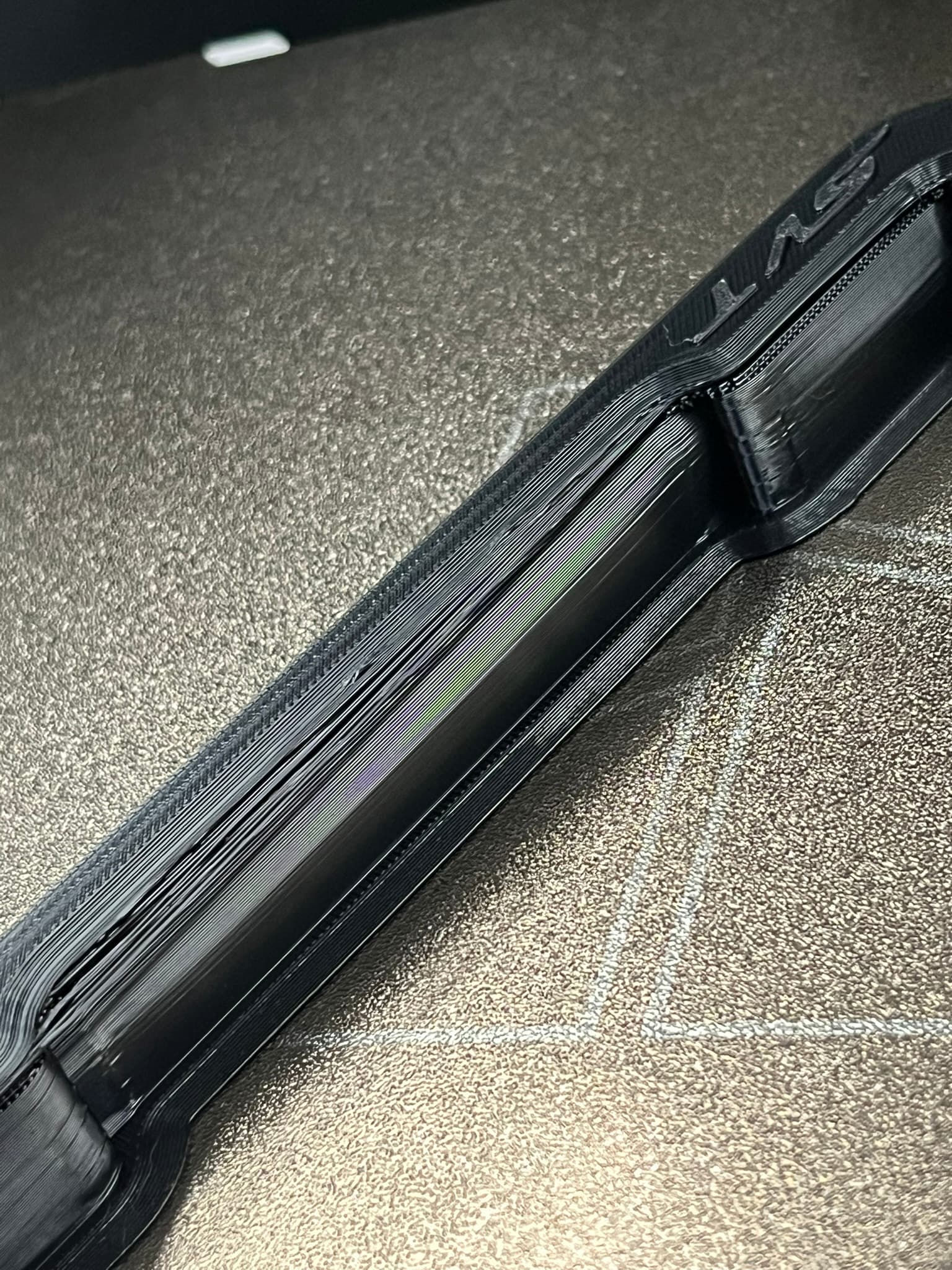

so while i was trying to reupload the last print finished, and the issue became a bit more apparent. Apparently the supports shagg…
Too heavy? Too fast? Too hot? I would guess its the fan actually since I run these the same speed I run them on my P1p and this has never happened. Gonna try to lower speed on supports and see if that changes anything
IMG_9530
Change the support type to tree or change the direction of your support base pattern. a long single wall of support does become more fragile and easy to bow. This is the easy way but yeah maybe you want to adjust your fan as well. But I wouldn’t bother too much with the fan settings as it’s a deeeep hole.

actually the issue is clearer in the last photos i posted. The whole support structure seems to be melting down. Maybe Ill set the chamber temp at 55 this time and try again

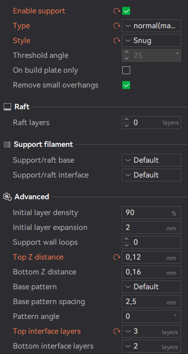

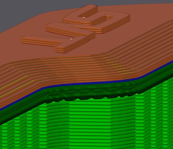

Update:

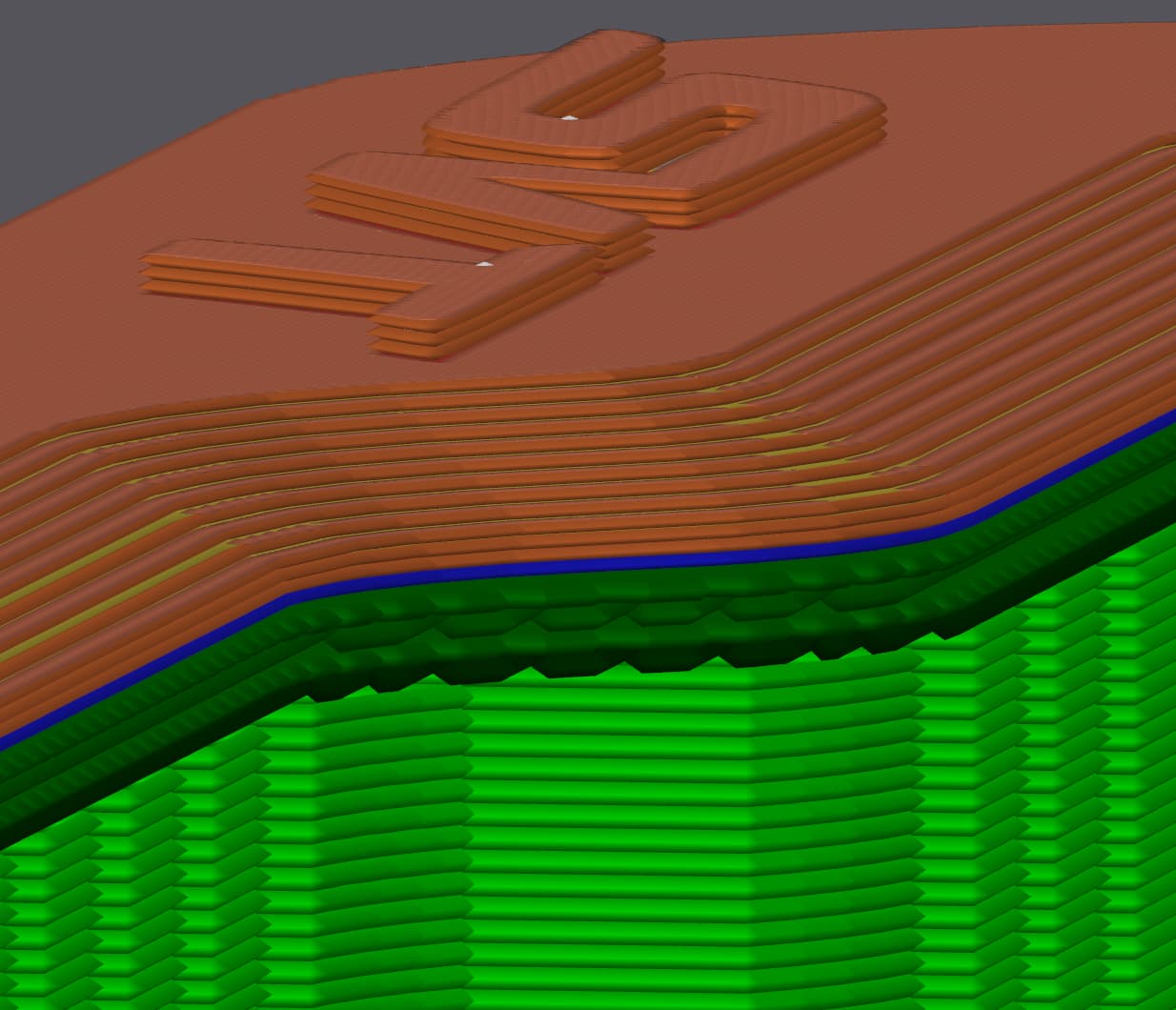

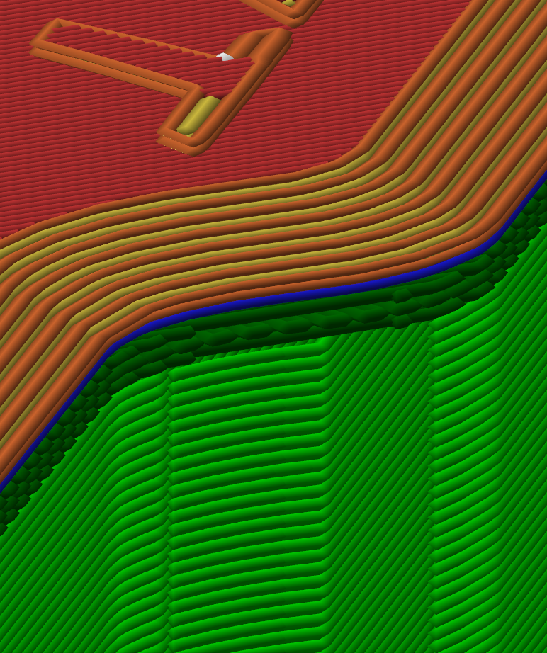

Bambu Studio seems to ignore the 3 Top interface layers set, and generates 4
Bambu Studio
{58093311-6AC3-4692-95C8-822E02ADF920}
{A75C8B01-2703-4C2C-893D-A481C8AF7095}

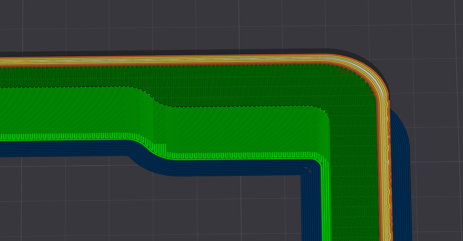

Orca
{A6CAD30D-0AA7-4902-8E24-8732F9ED5B66}
{85AB7421-82FB-44D7-A52A-FBD1260B0C39}
Yes for some reason Bambu Studio adds another layer it calls Support transition
Update,

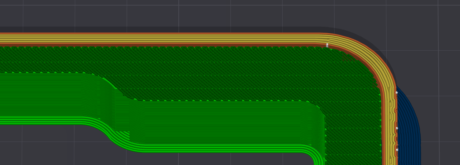

Orca has Default as Rectilinear,but it appears at an angle of about 45 degrees
Orca
{48B9E361-96CA-4391-88A6-E44DEFACAA79}
Bambu
{3CA23F39-D9B2-4229-81E0-13BCAA5D17A3}
Moreover Bambu seems to have Rectilinear and Rectilinear Interlaced Reversed (or the other way around)
But what is really different is that support transition extra layer
