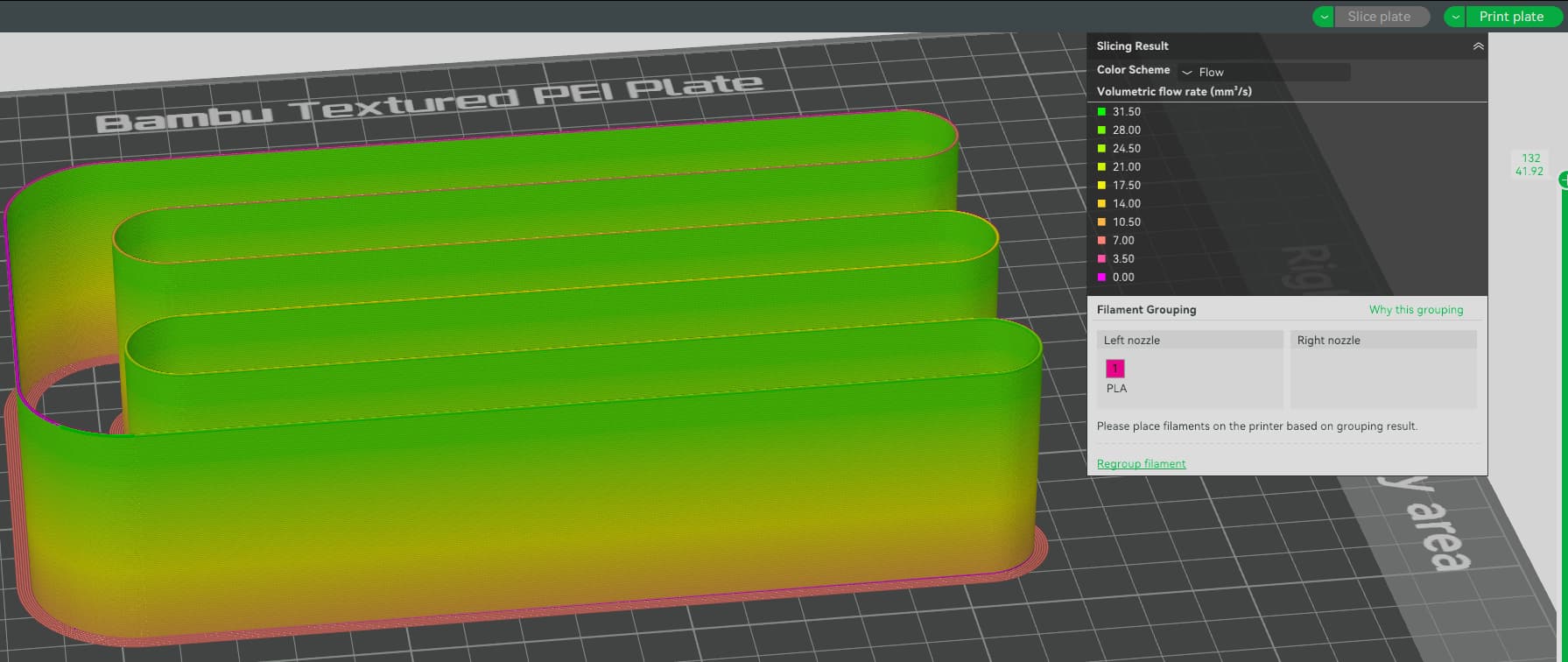

You may have to increase the outer wall speed after switching back to the H2D profile for the test to go up to its set max.
Yes, that part I’m aware. I normally just increase the layer height to make sure I’m not crossing any speed limitation.
Where should it be set? I mean where and to what value? New to Studio, and excited to find this hack. Anything else need to be tweaked? Would it matter what printer is selected before the swap back to Bambu? I’d think whatever printer is selected in the first place, it will pickup that printers settings.
Under the speed tab, you should see a selection for outer wall speed. Just need to set it higher if needed. You’ll have to judge this by what the speed and flow previews look like after slicing.

You can verify if this trick is working by slicing the racetrack model, and then selecting “flow” in the slicing result dropdown visual menu:
If done correctly, you should see volumetric flow rate increase as the layers go up.
Check the speed preview too. Make sure it’s not topping out half way through
