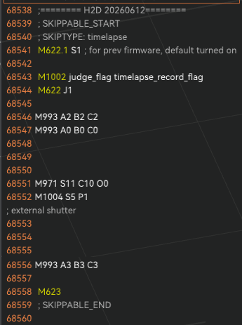

I’m seeing the same issue I think.
Right at the position where this section of code runs, at every layer, there is a pseudo-seam
Small chance it’s going to help, but you can try commenting out the M1004 command, you probably don’t have one of those.
