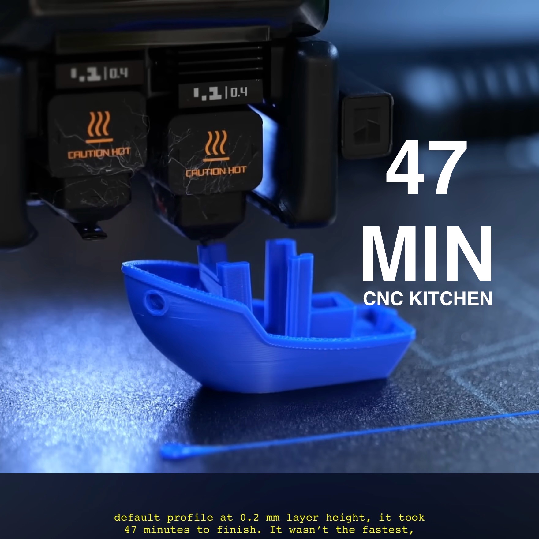

CNC Kitchen did had the h2d do the .2 benchy and it came out to exactly 47m.
CNC Kitchen did had the h2d do the speed benchie and it came to a poor quality at 23m.
Others also did the benchie on the h2d and regardless of exact numbers it takes over 40 min!

Not sure what you are looking at on your screen, but Im talking about stock 0.20mm profiles on both machines. Its a bit faster with Bambu PLA Basic but still around 40 min. Im sure you can push the A1M to faster speeds as its got a lighter moving mass, but thats not what I was referring to.

Thats an official #3DBenchy, feel free to go to creative tools and download it and slice it yourself. FYI the one on the SD card is a super optimized pre-sliced one with a bunch of shortcuts, wider extrusion lines etc (would not qualify for the speed boat race either). Again you have to compare apples to apples :apple: if we talking speed comparisons. Bottom line is all of the Bambu printers in the lineup print at a very similar speed to each other.
The crux of it is this, my mini Prints a good looking benchie at 20min. It’s not missing any parts. It’s beautiful. The H2D takes 47m to print something that looks the same. The h2d speed benchy prints at 23m and its ugly.

The H2D is a little slower, than the P1 and X1 series for some things, but not 20 mins slower for a benchy. Maxmit is right, you are comparing apples to oranges. You have to compare the normal benchy to normal benchy or pre-sliced-hotrod cheating benchies to each other.
The H2D hot-rod benchy is also 20mins (from the preloaded file). But if you slice it normally, with normal layer heights and normal line widths at modest 100% consistent speeds, you’re gonna find it and most printers still take 40+ minutes.
Even the VzBot 235mm (with 50,000mm/s2 acceleration and 2000mm/sec speeds) still takes 39 minutes for a basic profile “real” benchy. But make no mistake, that can be done much faster too if you tweak the line widths, walls, floors, speeds, and layer heights. I’ve seen sub 8 minutes benchies from that machine when tweaked. You simply can’t compare speed benchy settings to default profile benchies.
