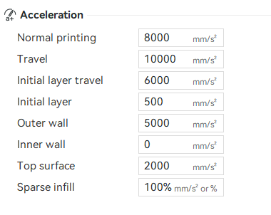

I question of what practical use either the 16,000mm/sec^2 or the 20,000/sec^2 numbers are in reality when none of the default slicer profiles exceed the following numbers anyway:
Screenshot 2025-04-15 234735
That’s a snapshot of the 0.24mm layer height profile, which exhibits the highest default slicer accelerations. The smallest are in the 0.08mm layer height, as you would expect, and some of those those are dialed down considerably even more:
Screenshot 2025-04-15 235540
Has anyone here found satisfaction in using higher accelerations than what is in these Bambulab slicer defaults? Are both the 16k and 20k accelerations kinda meaingless or untrustworthy, similar to most of the advertised lumens on most of amazon’s LED flashlights or like the advertised wattage on a lot of the aliexpress solar panels? i.e. inflated beyond belief for advertising purposes and, meh, nobody ever seems to check what the truth is anyway? Well, I doubt it’s really that bad, since I doubt even one of the “million lumen” flashlights gets anywhere near their advertised number even in principle, whereas maybe these printer accelerations are achievable, even if totally unpractical at generating even partially decent print quality. I only pose the question. I’ve not yet looked into finding the true answer, but maybe some among us already have done their own discovery process and can comment.
I have not used faster accelerations on my H2D yet, but i frequently printed on Ludicrous mode on my X1 and P1 with high flow hot ends and dual AUX fans. The quality is not as good as 10k standard but not too far off.

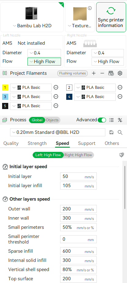

Like the rest of you, I’m looking for the silver lining. Maybe one area where (perhaps unfairly) the H2D could beat the speed of an X1C would be where an H2D with a 0.4mm High Flow nozzle is printing a large model with lots and lots of sparse infill:
In such a case, the H2D could, at least in theory, reach a speed of 600mm/s while printing the sparse infill, as compared to an X1C with 0.4mm standard nozzle:
I couldn’t find any slicer profiles for an X1C running an Obxidian high flow hotend, so maybe that would make it a wash, and if so, it is the the reason I mentioned it might be an unfair comparison. I just don’t know, as I don’t own an X1C 0.4mm Obxidian high flow hotend, nor do I have any other data in that regard.
Also, this is just comparing default slicer profiles, and so maybe if the profiles were fully optimized before test prints were run, then maybe that too could affect the comparison’s ultimate outcome.
Anyhow, irrespective of how the two Bambu printer models might compare under the harsh glare of their respective popularity, it seems like both printers would likely enjoy a popular reception if put on display in local venues in order for the public to inspect and perhaps run test prints. Maybe someday someone with all the right parts to outfit a proper apples-to-apples comparison after outfitting both H2D and X1C with Bambulab High Flow 0.4mm nozzles, will then run the test and report back here how it went, and which one won the race, and by how much. :sunglasses:

Given enough room to accelerate, the H2D will reach higher top speeds than the X1/P1/A1 printers. It has a significant travel speed advantage. As well, the sparse infill will print quicker (given enough room to accelerate and decelerate). However, back to the acceleration, its no secret acceleration number are probably more important to print time, because top speed is capped by how quick it can get up to speed.
But like you elude to, IMO, its not really important. At least to me. The fact they could put significantly more weight on the toolhead and gantry, add a second print head/nozzle and only lose a little acceleration all while largely improving print quality for a larger area… I’m OK with that. Keeping the old limits would have cost a fortune.
