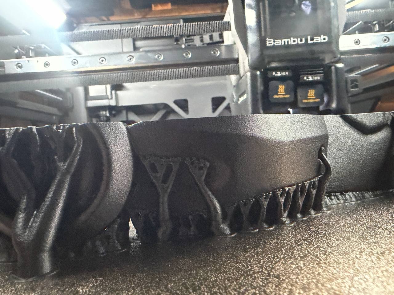

I really wish the amazing people at bambu labs would just sit the heck down and actually tune their filament profiles properly, I’ve burned an entire 1kg roll of petg-cf trying to make it print without a nozzle clump or beard effects, i am now to the point where I need to get rid of the nozzle clump and need g-code to run the nozzle wipe every 10 layers or so. its g150.3. to move to wiper and g150.1 to wipe on the x1 but I don’t know if its the same on the h2. Also any tips on petg-cf would be greatly appreciated, I’ve raised temps, turned down cooling and run flow calibration all to relatively little progress on making petg-cf run right, its been drying for days at 80c just to be sure and still my supports turn to spaghetti midway thru a 18hr print with complex geometries(which prints perfect in asa-cf).

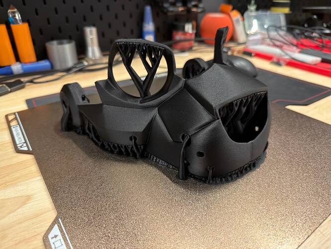

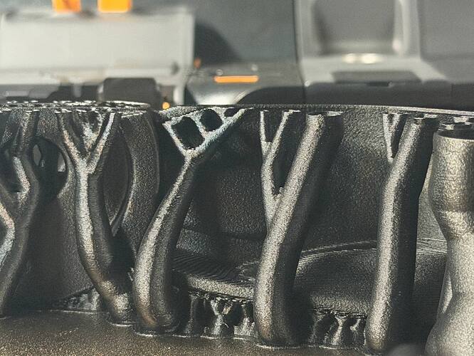

my petg-cf printed perfect at 263c 50% speed(silent mode) volumetric speed 8mm/s instead of 11mm/s
There’s like 1000 lines just in startup macros the h2d does, I had my llm go through the extracted gcode and figure out what the exact macros were. I just tested this on an 18hr print and no nozzle clump :slight_smile:
wow that looks super good, so it was just wiping more? is that texture fuzzy skin too?

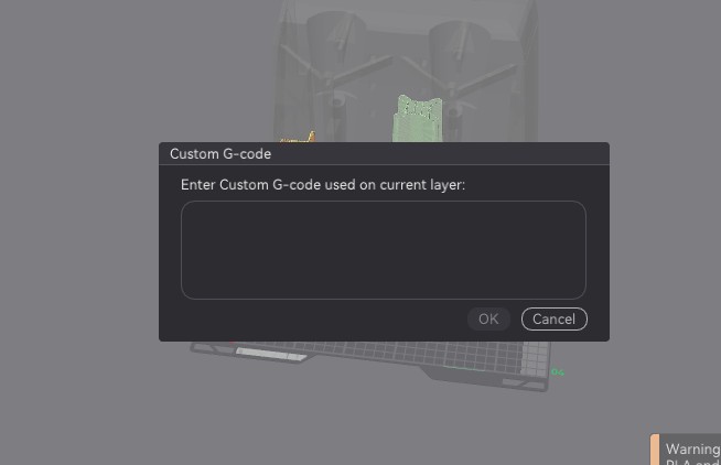

That looks excellent, be it a little much wiping for my use case. What part of that gcode would I enter in the “Add Custom Gcode”-section when I use the progress bar of a sliced file like every 200 layers?
