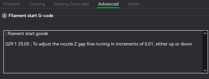

My H2D has produced good single layer prints with both nozzles and PLA. The front lower bed screw was already backed off enough. The HF PETG required a slight Z-offset adjustment, which I added to the filament’s start G-code.
Refer to the revised method a few row down if you currently need to adjust your Z-offset
The newly released Beta firmware V01.01.02.07 mentions Optimizing first-layer quality , so they may have improved it specifically for the type of filament being used.
  • This was with the smooth PEI plate.
  • If you notice small PETG ripples or waves, with the stock settings you need to adjust the Z-offset with this code.
  • Mine turned out perfectly with a 0.05
My initial method.
G29.1 Z0.05 ; To adjust the nozzle Z gap fine-tuning in increments of 0.01, either up or down

Revised method for utilizing both plates with necessary Z offsets applied as needed, while retaining the settings.
Save the current machine (Save Icon), then modify the Machine Start G-code and save the updated changes.
This Z-offset is set for my HF-PETG; you may need to adjust yours for optimal results.
;===== for PEI Plates , lower the nozzle as the nozzle was touching topmost of the texture when homing ==
   {if curr_bed_type=="Textured PEI Plate"}
        G29.1 Z{0.02} ; for Textured PEI Plate = Bambu Lab default -0.02
   {else}
        G29.1 Z{0.05} ; for Smooth PEI Plate = Bambu Lab default 0.00
    {endif}

This is all nice but can someone tell me with certainty if a negative number value on the G29.1 squishes more (nozzle closer to bed) or less (nozzle farther to the bed) on the build plate ? it is not clear anywhere.
Thank you.
Yes, using G29.1 Z-0.02 will decrease the distance between the nozzle and the bedplate, resulting in more squish on the H2D.
