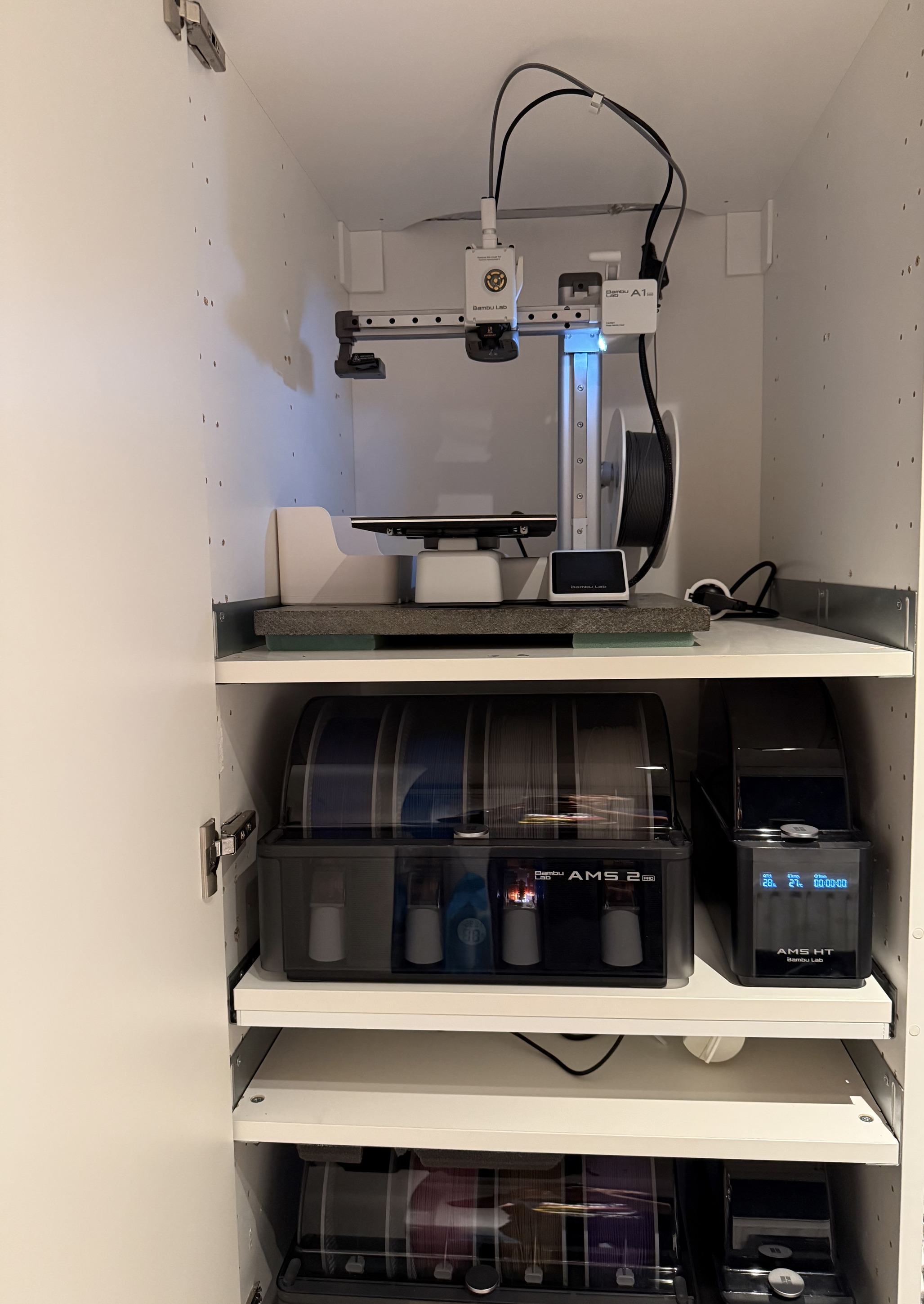

H2S/H2D minimum required space . fit in tight space
Actually I have my P1S in a cabinet sized inside (560x560mm).
It is a Ikea Metod cabinet and I do not have an alternative space.
The two AMS I have on a shelf above. Electricity and fresh air
I have from the backside. I thought for the poopchute I could make
a tube to the level below.
I doubt if a H2S/H2D would fit? Any input is welcome.
Also the wobbly rubber feet do also make me concerns.

i place my H2D on a 500mm deep desk (IKEA Micke). It fits just nicely. But you need some sort of clearance on the backside for the poop chute, cables and tubes. 60mm is a bit tight, but perhaps it would work. I think i have a clearance of about ~70mm to the wall.
Maybe you can punch a hole on the backwall of the cabinet if you need more clearance. The backwalls of IKEA furnirtures are usually just thin plywood.
Sometimes you also have to clear up the poop in the poop chute (sometimes they clump together and get clogged) so make sure you can access the backside of the printer or think of another option.

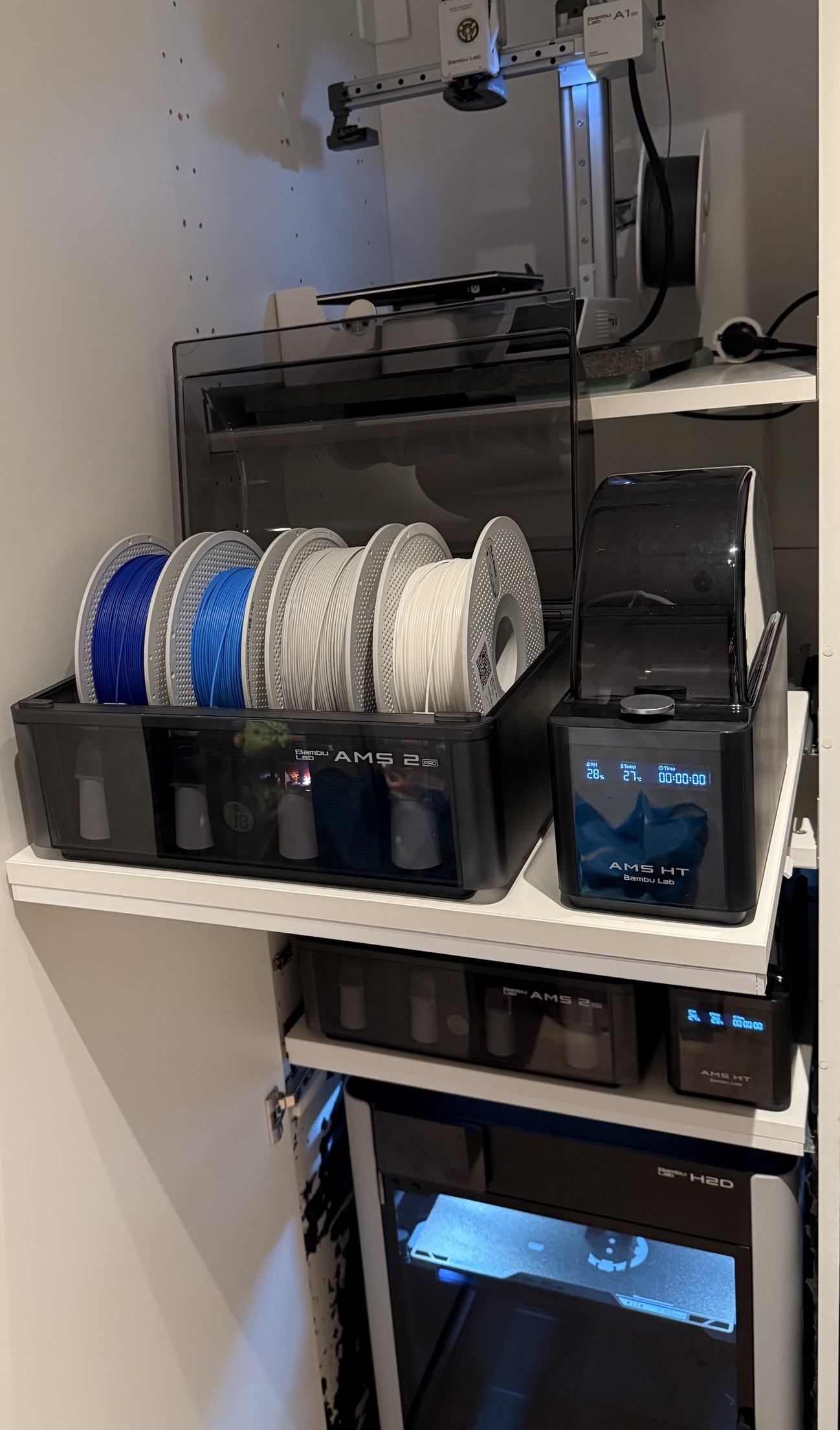

The actual printer is already on a sliding shelf ( UTRUSTA). But it is only rated to 18kg. For the P1S it was optimal.
I will look for a more stable version of sliding shelf.
Sliding rails for some server racks can hold much more weight, will look on this
area to get some.
My H2D also sits on IKEA furniture with a 60x60cm footprint, which fits perfectly. The waste chute is behind the printer and goes into a small, removable trash can attached to the cabinet (nothing I printed myself, in this case).
I banished the AMS to the drawers under the printer, but I had to reinforce the bottoms; the thin drawer bottoms wouldn’t have held up for long given the footprint.
(Although I have to say, I haven’t found the ideal solution; access to the AMS isn’t very good.)
But you can see that the weight of the H2D is already limiting the IKEA cabinets.
Sure everything has it’s limits. I already selected a 19" sliding shelf which can handle 150kg. I will mount it with brackets, an metal angle bracket and but an Ikea UTRUSTA shelf on top as 19inch stuff is more narrow. I will try it as I have it for free on hand (19" stuff). Unless I find something better matching. The whole stuff is mounted to a steel concrete wall. Everything is very solid, no plasterboardwall. No rattle, no vibration.
