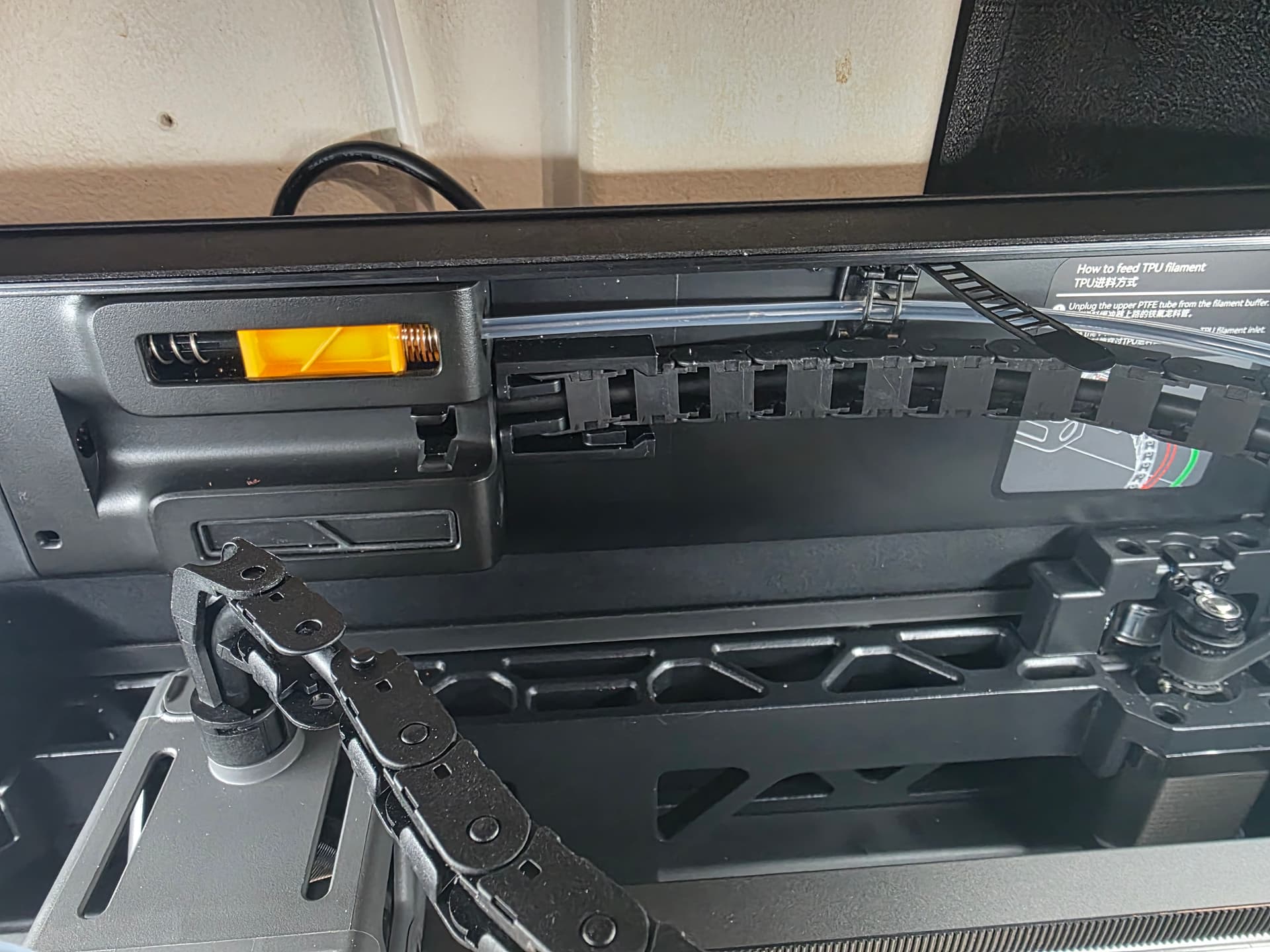

From day one I was getting AMS motor overload errors, and on top of that I was dealing with a poop-clog issue. I think I’ve finally solved both problems with help from Bambu support and the community. Hopefully this helps someone else diagnose their issues.
AMS Motor Overload Issue

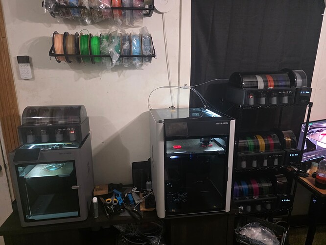

As you can see in the pictures, my setup isn’t great, and I plan to fix it soon.
The cause of the AMS motor overload error was that the pre-installed PTFE tube from the buffer to the toolhead was too short. When printing at max bed size while using a 4-way hub, it created too much friction and triggered the overload error. After I replaced the tubing from the buffer to the toolhead, the issue got better but didn’t fully disappear. I then added a nylon cable tie (shown in the pictures), and now I can’t reproduce the problem at all.

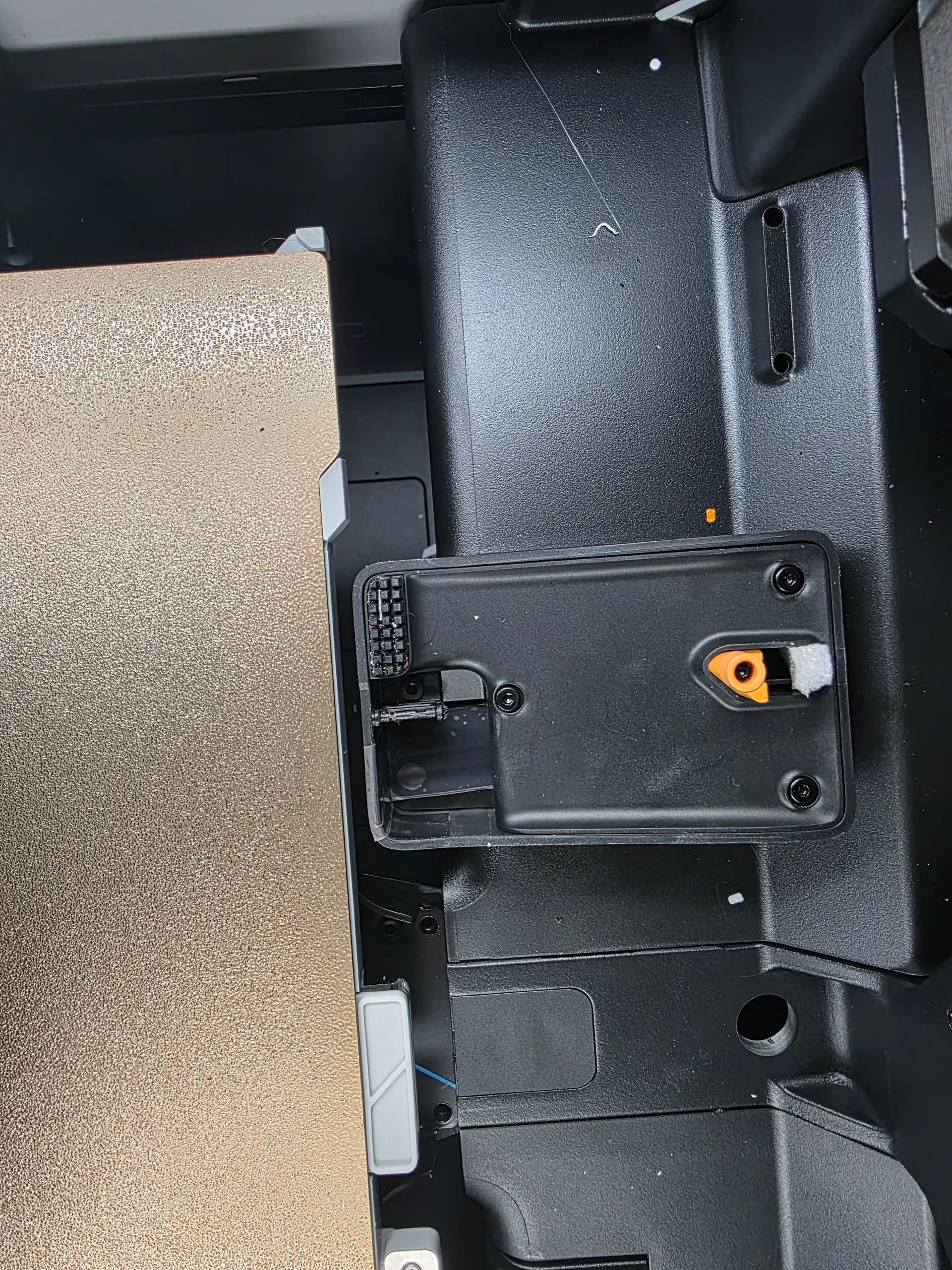

I also noticed that the poop chute would get clogged and back up. After some testing, I found that the printer’s poop door is spring-loaded, and sometimes it would stay open. That caused the printer to purge filament down the chute, creating long strings that eventually clogged it.
To fix this, I applied a bit of Teflon tape to the lip of the chute and the door. I also placed a small piece of foam behind the door trigger (or whatever you want to call it). I haven’t had a single clog since.
Yeah, the internal ptfe tubes are often cut too short, I don’t know how and why it happens but they really should give them at least 1 extra centimeter of tube length.
Me personally, I like the really clear tubing so I can see what’s inside and if there are any breaks. I replaced the stock smoked gray one with clear tubing but kept the same length.
Have you considered to position the AMS’s to the left side of the printer?
That would optimize the PTFE tube’s path a lot.

I am going to try the trick of lining the internal poop chute with aluminum foil tape.

I don’t have room on the left side with all the AMS units I have. However, I did test it on the left side while troubleshooting and still got the AMS motor error. I even tried placing it on top of the printer, and the issue still occurred.

Foil tape will work very well, and I’d definitely suggest using it. I used Teflon tape on mine only because I already had some lying around.
I have both, should I use the Telfon tape then?
That’s up to you. I think the tape is more forgiving when it comes to wrinkles and seems to apply cleaner. But both options work and help keep the waste from sticking. I would also put it on the slide on the printer as well — I found that helped a great deal for me.
