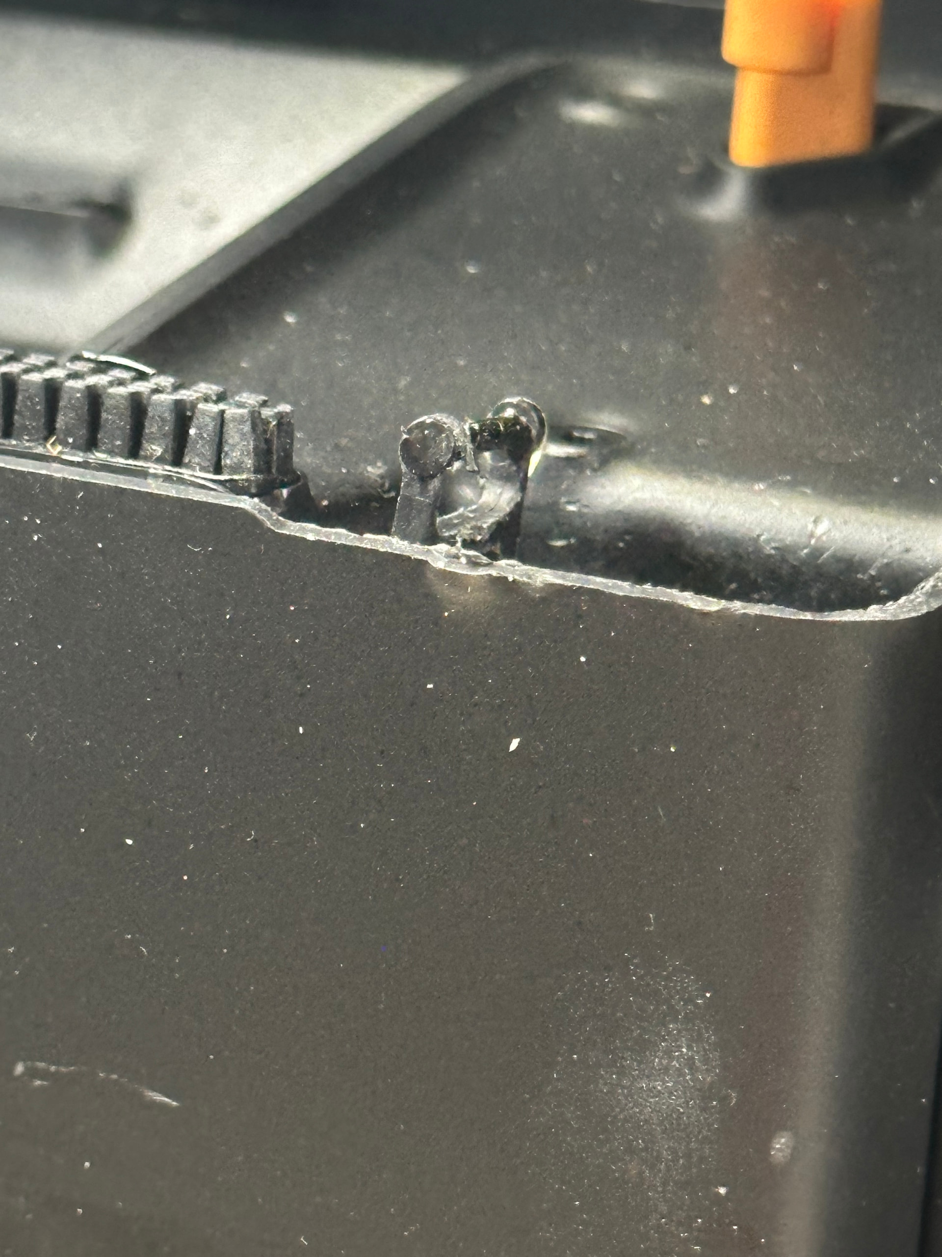

H2S Nozzle Wiper is just "Gone"
The little roller and the plastic that supports it is just totally “gone”.
I have ABS clumping and didn’t notice it. I had cleared some nice globs of ABS and it must have been in one of them. There is no putting on a new roller.

BTW, here is a pic, I pulled it from inside the poop chute area. It is broken in the middle and mangled.
Sorry, I was in a bit of a panic. When I first saw it mangled, I was thinking it was part of the chute mechanism. Then I remember it used to have a nozzle wiper looking thing like the X1 does.
From what I see in your picture, I’d inclined to order one of these:
H2S Purge Wiper
It’s just a screw. You can find other wipers on MW, I’ve used just a piece of silicone on mine. Works well. It’s not the best wiper design. The scrubber works fine. The part that’s damaged on yours is really just there to knock larger bits and strings off before it hits the actual wiper.
You can buy the whole thing, little more expensive. Really just 2 screws to remove it and put the new wiping pad on.

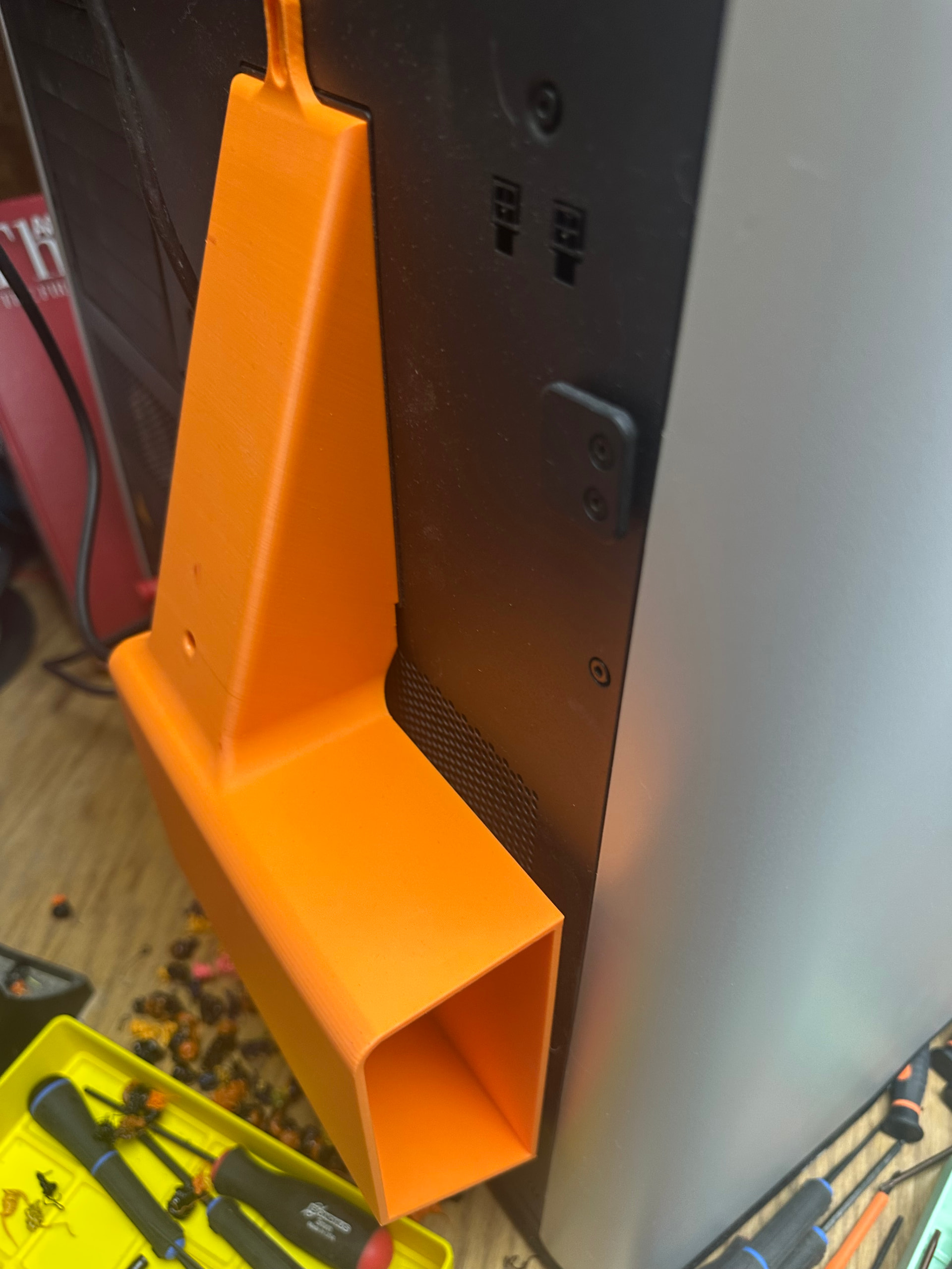

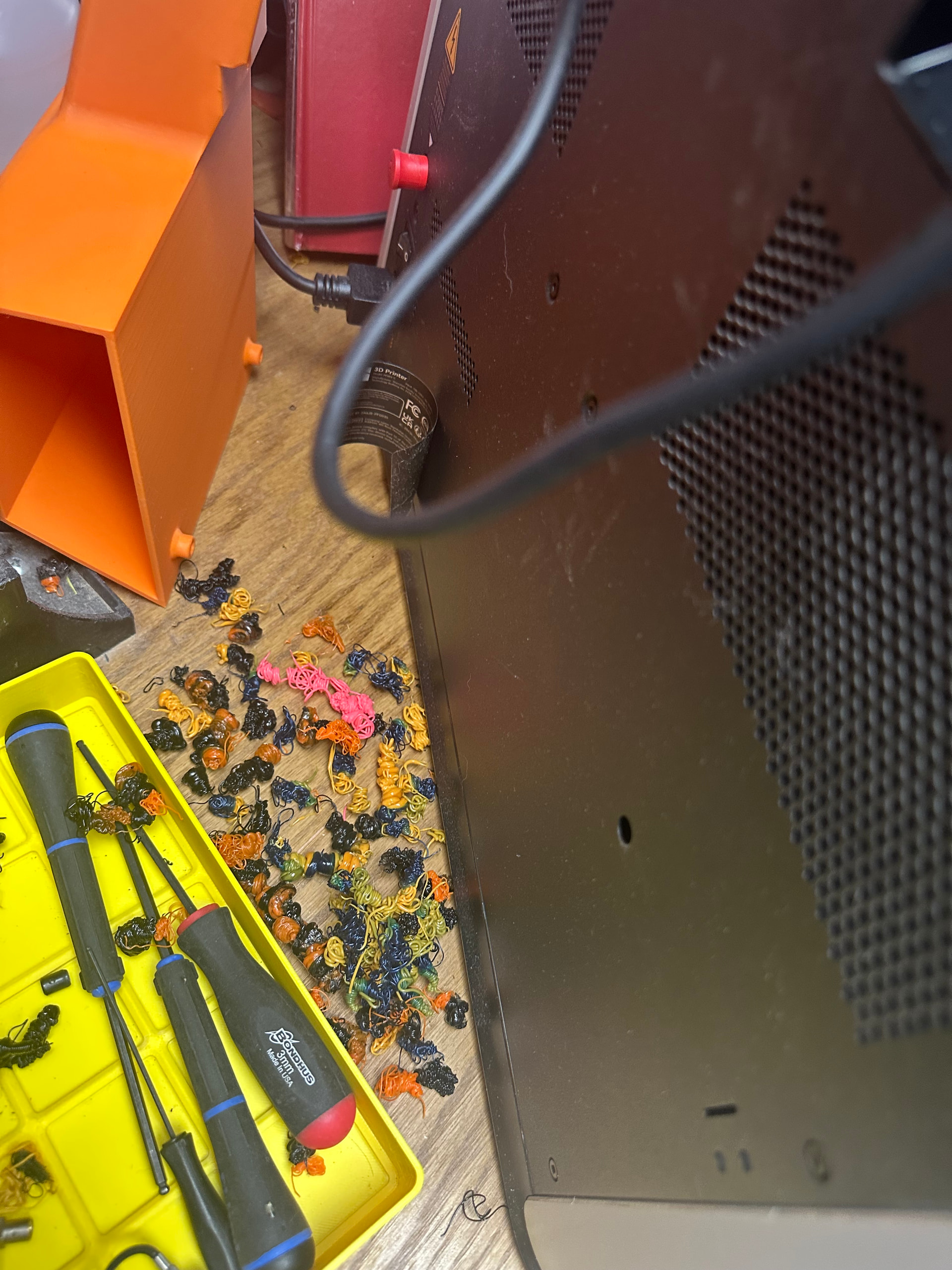

Okay guys, thanks for all the help! I figured out what caused this. Look at the mess that came out of the poop shoot what I removed my poop chute bucket/guide thingy:
It must have been really jammed up and I did not know it. The bucket/drawer is not full, only about half. This design is beautiful, but does not work, I guess. Shxt.

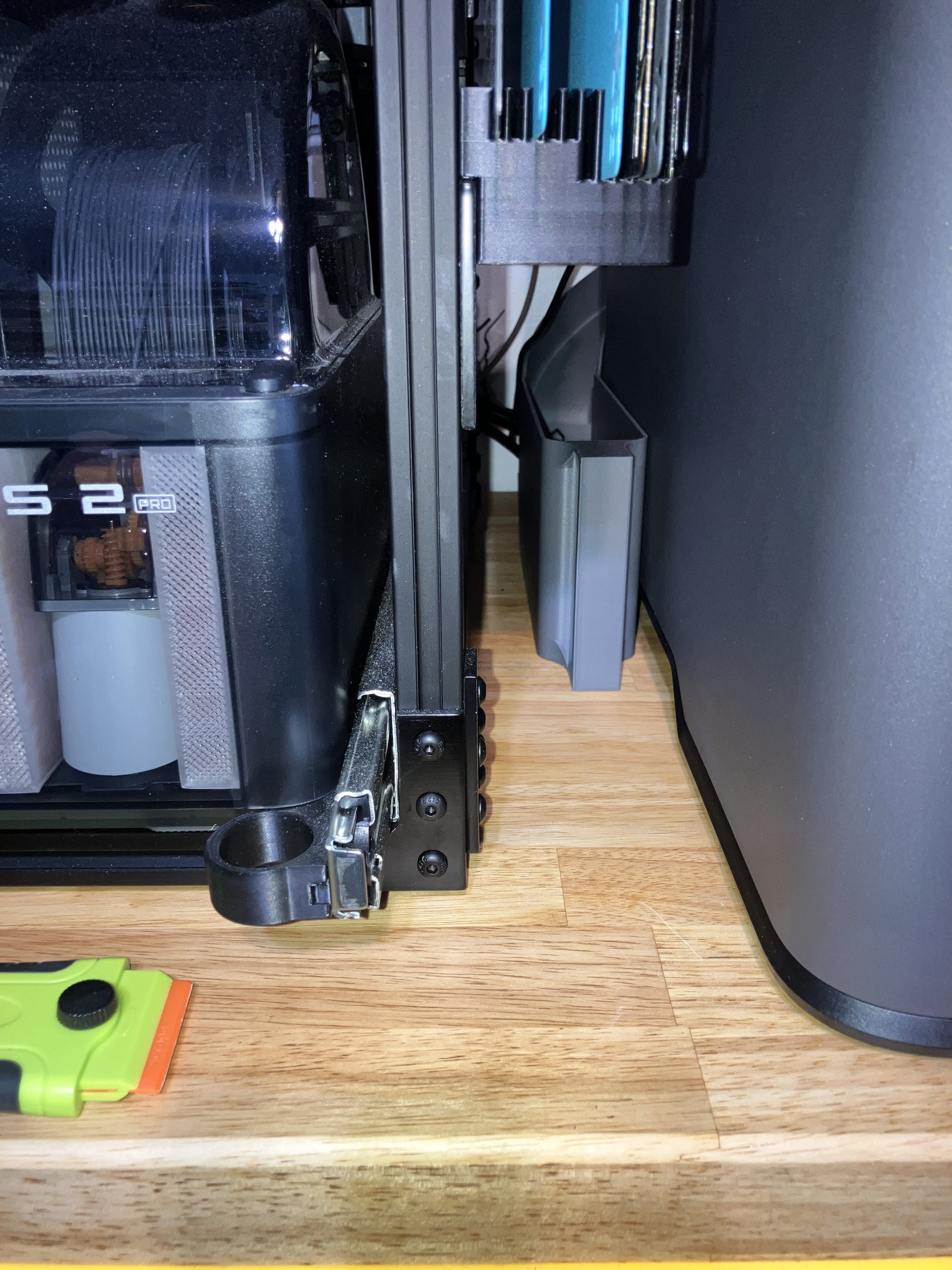

I’ve never been a fan of the chutes that completely cover the chute on the back of the printer. I recently printed this H2 Low Profile Poop Chute for my setup.
I have my AMS rack stacked on the left side of my printer for best PTFE routing and this fits in between them and allows me to monitor and empty the bucket very easily.
I printed mine with PETG and so far I haven’t had any pile ups.
Here’s a pic of my setup:
