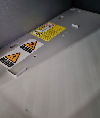

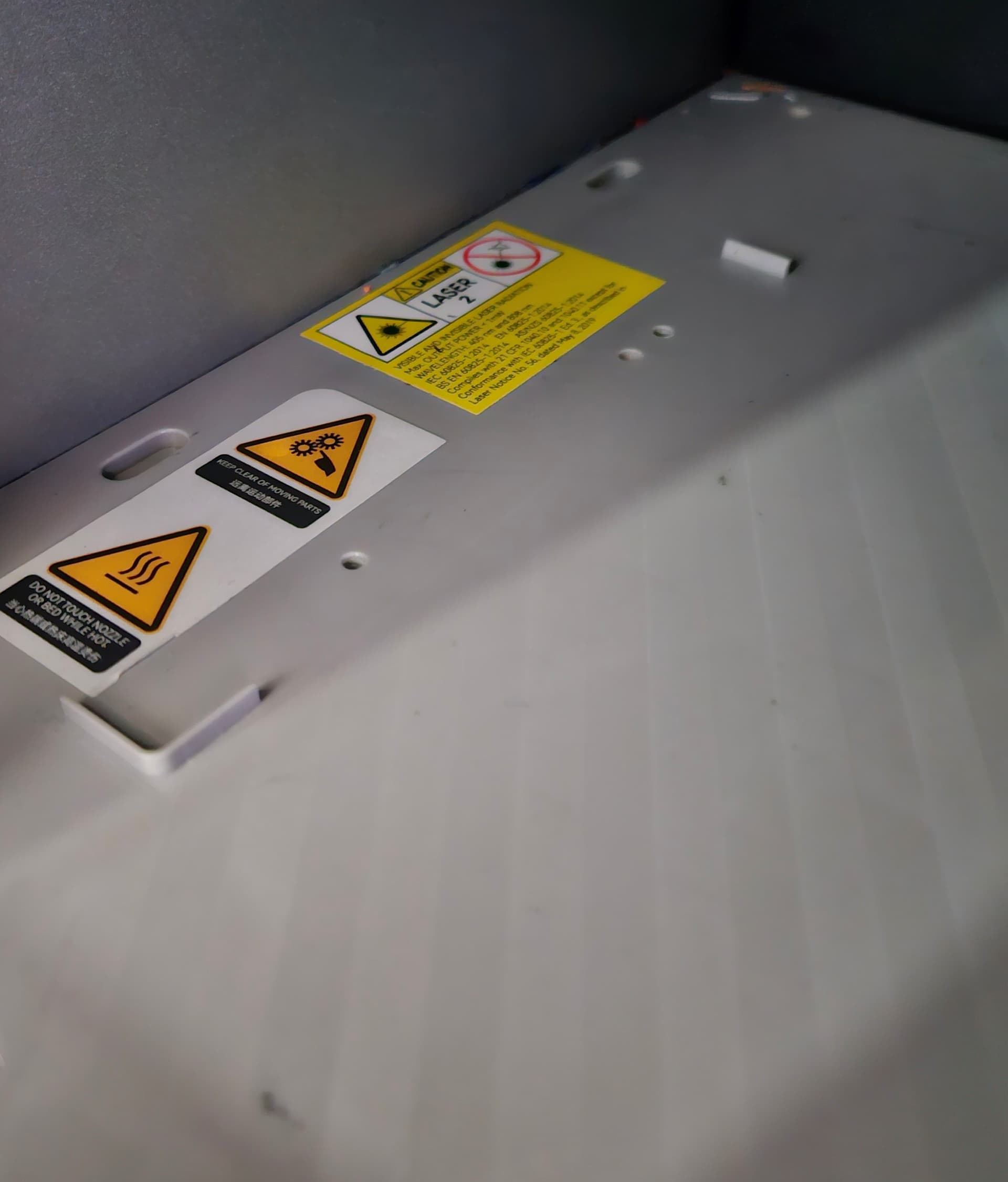

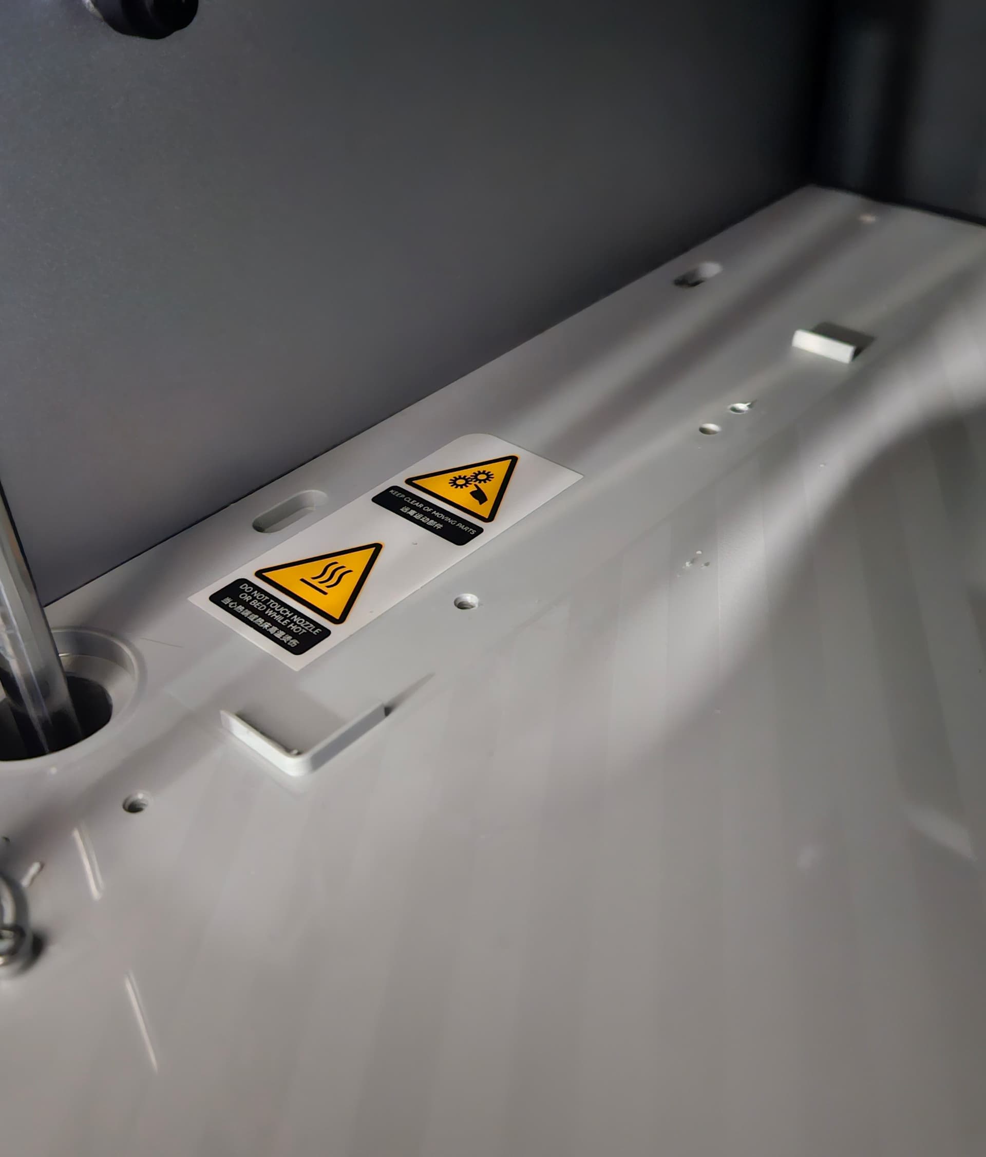

Not sure if this counts but the only difference I can see so far of my two printers is a Laser Caution Label on the bottom of the printer…
PRINTER PURCHASED IN FEBRUARY 2023
PRINTER PURCHASED IN APRIL 2023
