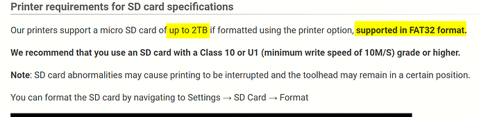

I made this print with a brand new SD card. I have another one on the way that I’ll try later with the timelapse feature turned off, but I’m not very optimistic :disappointed:. Hopefully, I’ll be proven wrong!
Just be aware that if you use an SD Card with a capacity greater than 32GB, only the first 32GB will be recognized. In fact, the printer may not recognize the card at first unless you format it in the printer.
