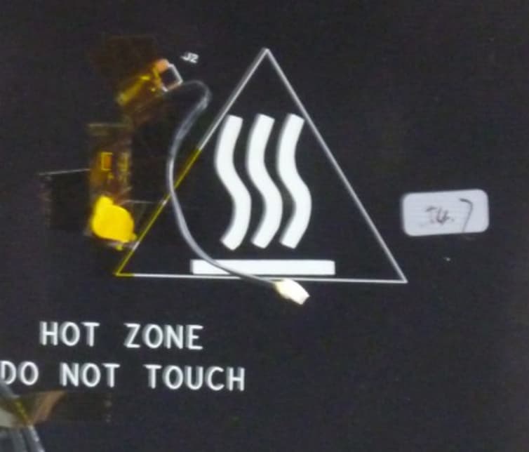

i see its been awhile since anyone posted on the tread. but i have a question. The thermistor (tin single black wire) where did that connect to on the heatbed. mine came loose and can figure where it goes. Thanks
Is this what you are looking for?
Thanks for replying. Turns out what i thought was a wire was in fact some filament. A poop got down where the lead screw and the channel for the wiring for the heatbed. It fooled me into thinking it was a temperature wire that came loose.
But on the bright side. I know how to take a P1S mostly apart.
Thanks again for replying.
