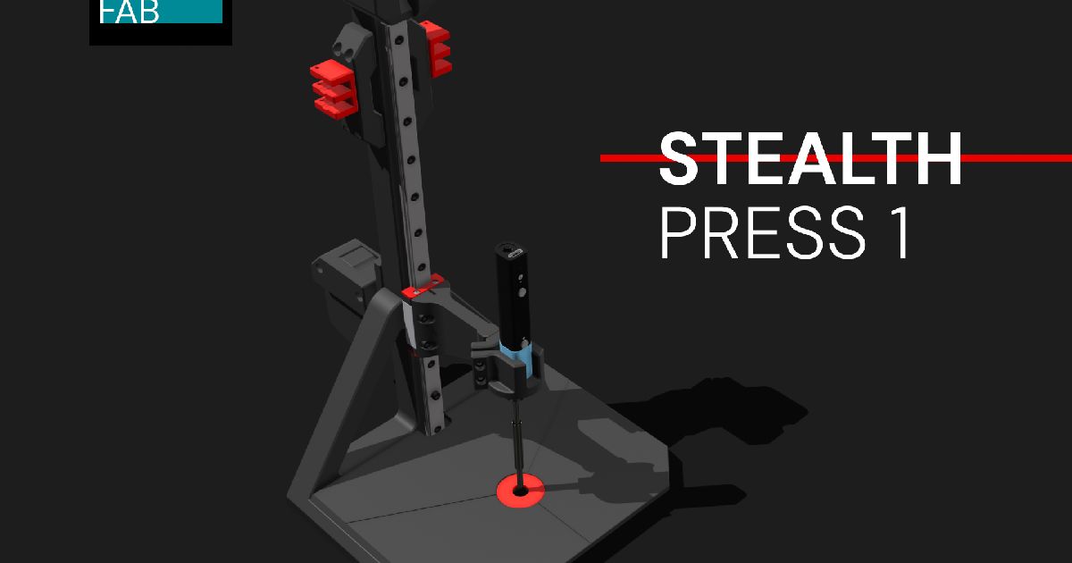

Well, you could buy one (Amazon, Aliexpress, local shops) or you could make yourself one. There are plenty of models to choose from on Printables (Printables). Personally, I’ve opted for the Stealth Press (Printables), which I made from PETG and ABS, and have been using it on a regular basis for more than a year now, without any issues.

I’m going to give the Stealth Press a try.
Good choice. However, be advised that it does require a number of inserts, which you’ll have to do by hand. Nothing fancy or too demanding, just a steady hand and a bit of pressure, and you’re done. Share some pics of your build if you can.

I too went with the Stealth Press. And because I’m lazy, I picked up a kit of parts from DFH. Sadly they no longer stock it. They do have a kit for the Stealth Press Zero. Might seem spendy at $39 but it was one and done. As I get even older, that has a certain appeal.
