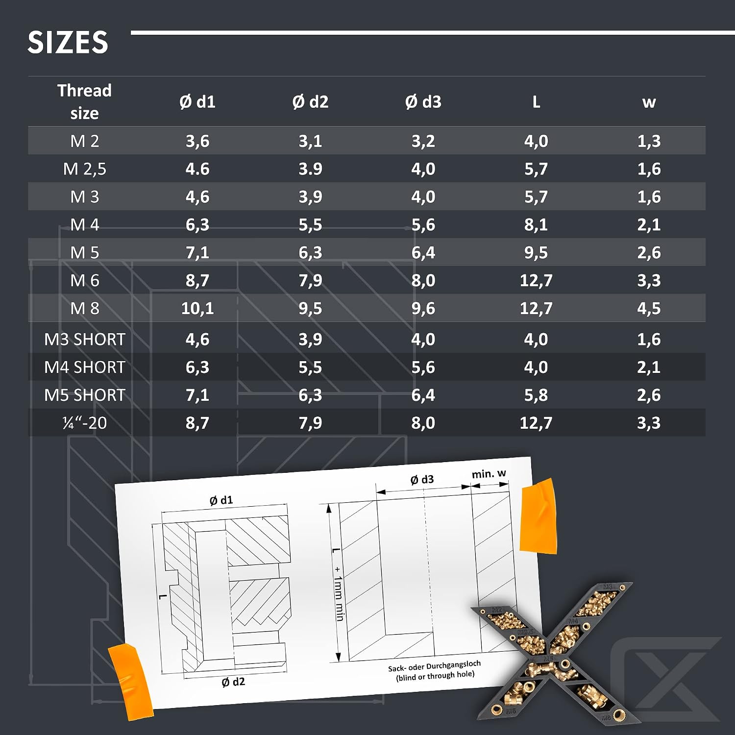

I have been trying to use the attached heat set inserts. When I print the holes (d3 in the diagram) with the specified diameter, the inserts are too loose and they start spinning when I try to tighten my bolts. But when I reduce the diameter, I get melted plastic coming up into the threads when I insert them and the bolt won’t screw in when it cools.

As well as getting the hole diameter correct as previous poster said - that is the actual hole being printed, not the hole your CAD file says is to be printed - you can also make the hole deeper to help with finding a space to push plastic into. If you cannot calibrate the printer, one tip is to print the hole small and use a drill bit to widen it to the required diameter.

When you design the model make the holes parametric with a parameter for clearance. So you can just adjust that 1 number and all the insert holes are re-computed.
