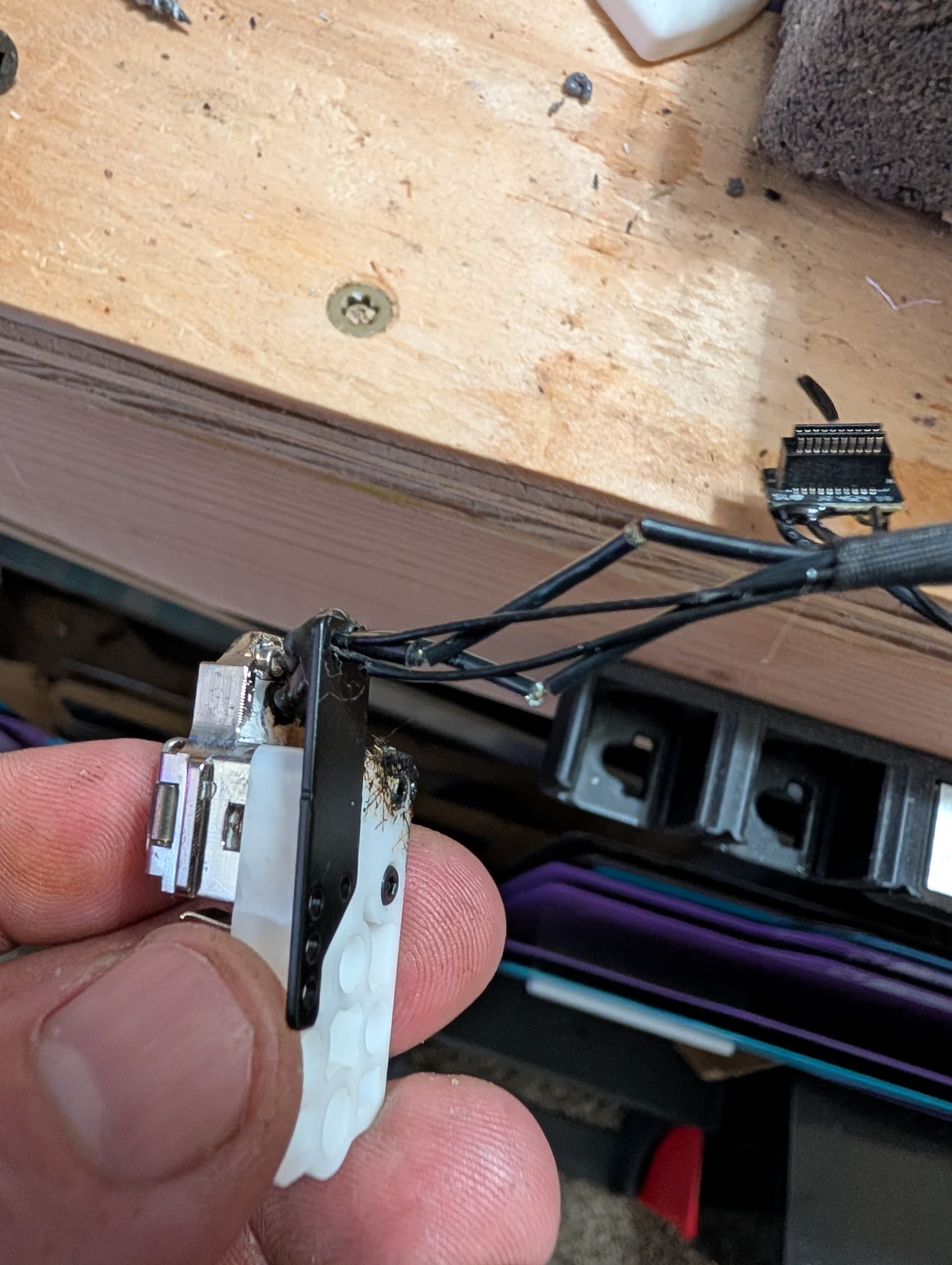

Anyone else seeing any issues with the heating assembly wires behind the plate, the coating seems to have lost flexibility and started cracking over time causing wire splitting. This is the left nozzle, original.
I didn’t issue a ticket for this, I just replaced myself. I do consider this a wear item, so I’m not so-concerned about reimbursement, just wanting to know if this is something to be expected due to the movement and heat, or if others seen this with the original, or maybe this is a known issue? The replacement seems better fyi…

Hm for me the two power wires are “open” at two positions. Since for both wires the insulation is broken at exactly the same positions, I thought this is normal. And was curious that on my H2C head from the upgrade kit, these insulations are not broken. But there is as well a rubber piece at the location were the cables are “clamped” into the print head. So the H2C definitely has a newer revision of the heater cable.
But this means that my wire are broken 4 times (2 positions each) after 1000h.

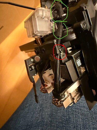

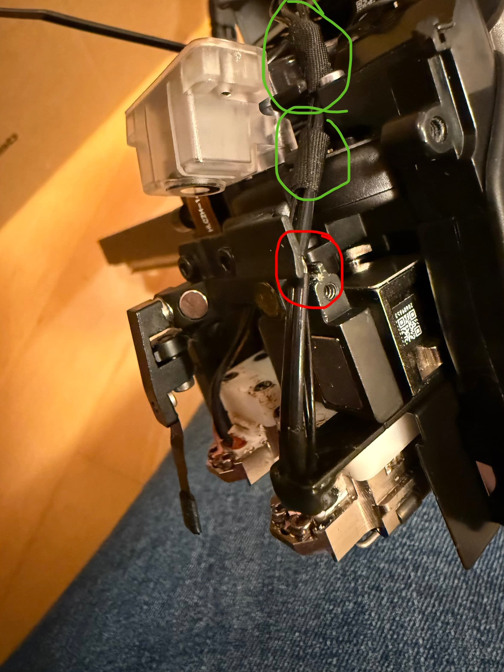

The one from my 6 month old H2D looks like this:
At the red circle both the heater wires have no insulation. And at the green circles they have just used some tape to protect the wires and bind them together.

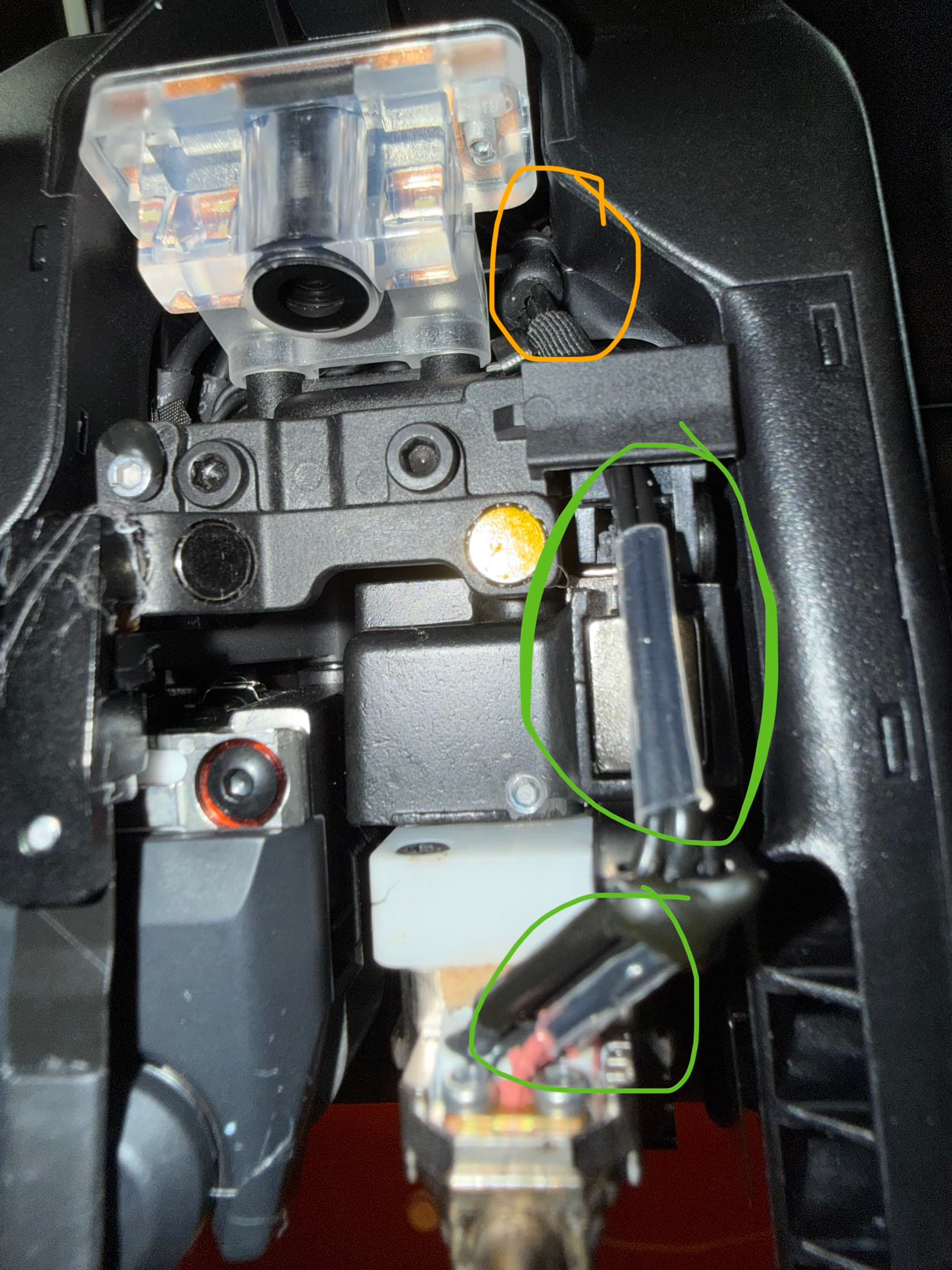

However the cable protection on my H2C heater looks completely different.
Green circles much more protection and binding. Organe circle a specially formed rubber piece for the clamping location.
So how does yours look like?
Note: since I had major issues with H2C toolheads Eddy sensor, I switched the complete heater assembly, lifting mechanism and eddy sensor from my H2D head to the H2C head. I did as well run all possible combinations of these parts. Everything is 100% compatible even if it looks different (heater assembly and lifting bracket).

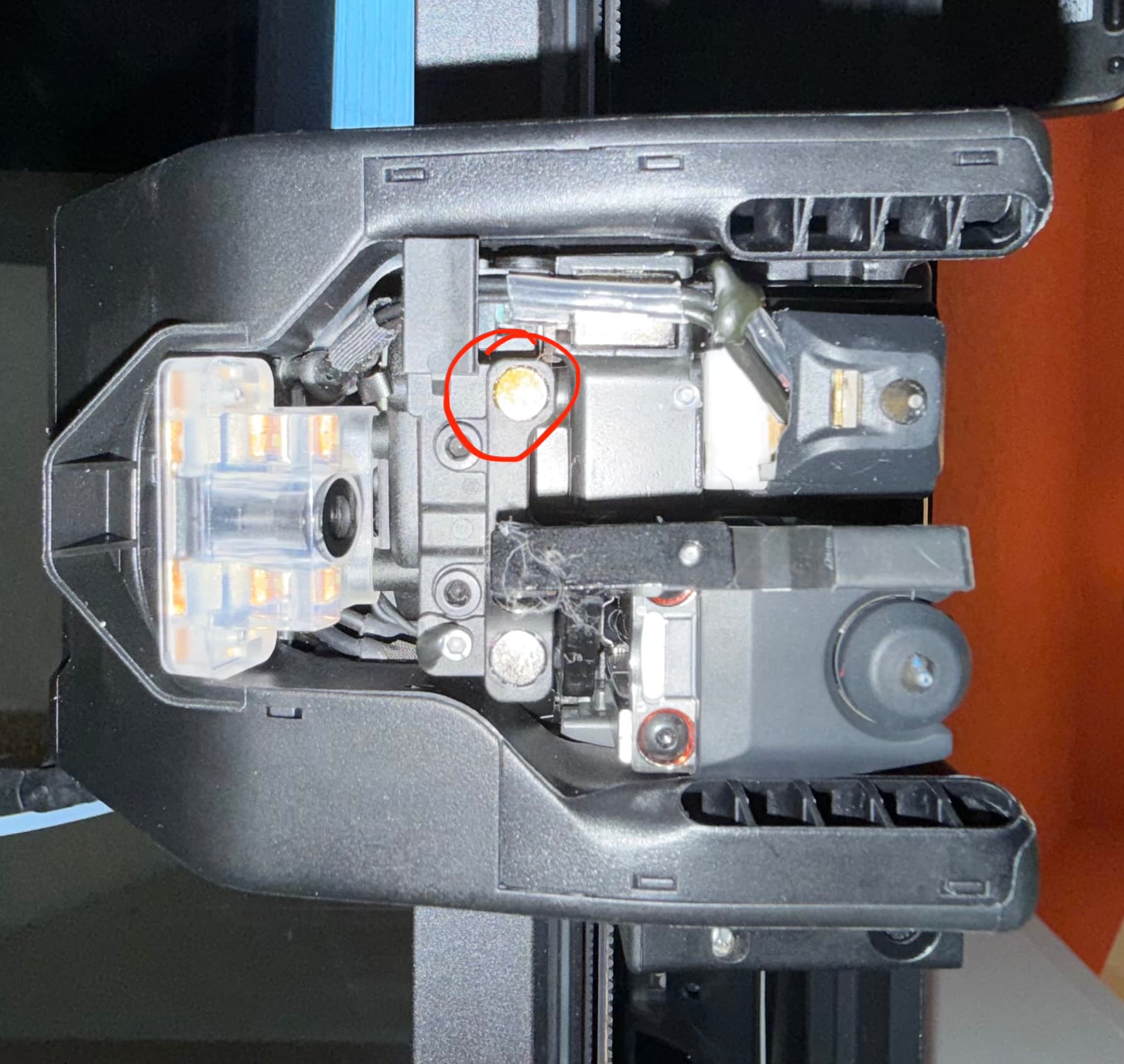

The tiny dampening sticker on the nozzle blocker magnet seems either missing or like everyone else experiences > it magically disappeared. :winking_face_with_tongue: Honest question: was there no tiny translucent red colo(u)red noise dampening rounded sticker to reduce the “click” noise level when switching the nozzle blocker or did it change entirely since the H2 Vortek nozzles are slightly different? Just wondering.. mine fell off of the thing
I have not seen any sticker on my 1000h old H2D head as I installed the H2C Vortek upgrade to my H2D. But on the photo it looks like there is some red/orange color/glue on the left position magnet.
I cannot tell if it was lost on the H2D.
H2D was bought end of April 2025.

There is definitely something on the magnet on my H2C head in the red circle. But it does not look that red and it is the opposite side magnet as on your linked picture.
