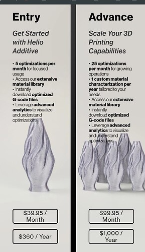

One of the highlights is a thermal simulation tool comming from a company called Helio Additive. Looking deeper into it, it seems this is not to be a free service, but willl be cherged.
Is this assumption correct? Perhaps an official statement from BL could clarify this matter.

  • I notice their privacy statement, but soon discard it as I realised that I may do some tests, but I’m certain the tool isn’t for me because of their pricing:
    When I think about $ 40$ per month, and get five optimisations, it adds $ 8$ to a print. It could be worth it in precise prints, and with filaments they still do not support, but not as a subscription. Maybe BL will come up with a discount subscription…

$8 to optimize relatively easy to print filaments… that does not sound like a good deal. Plus they harvest and promise to re sell all the data you supply. They should be paying users who are naive enough/ want to use their „optimalisation”
Is this meant for a company that cranks out the same part over and over so they would just have to optimize it once?
Yes, this software appears to be targeted at commercial users of 3D printers. I doubt it’ll be more than another source of frustration for non-commercial users.

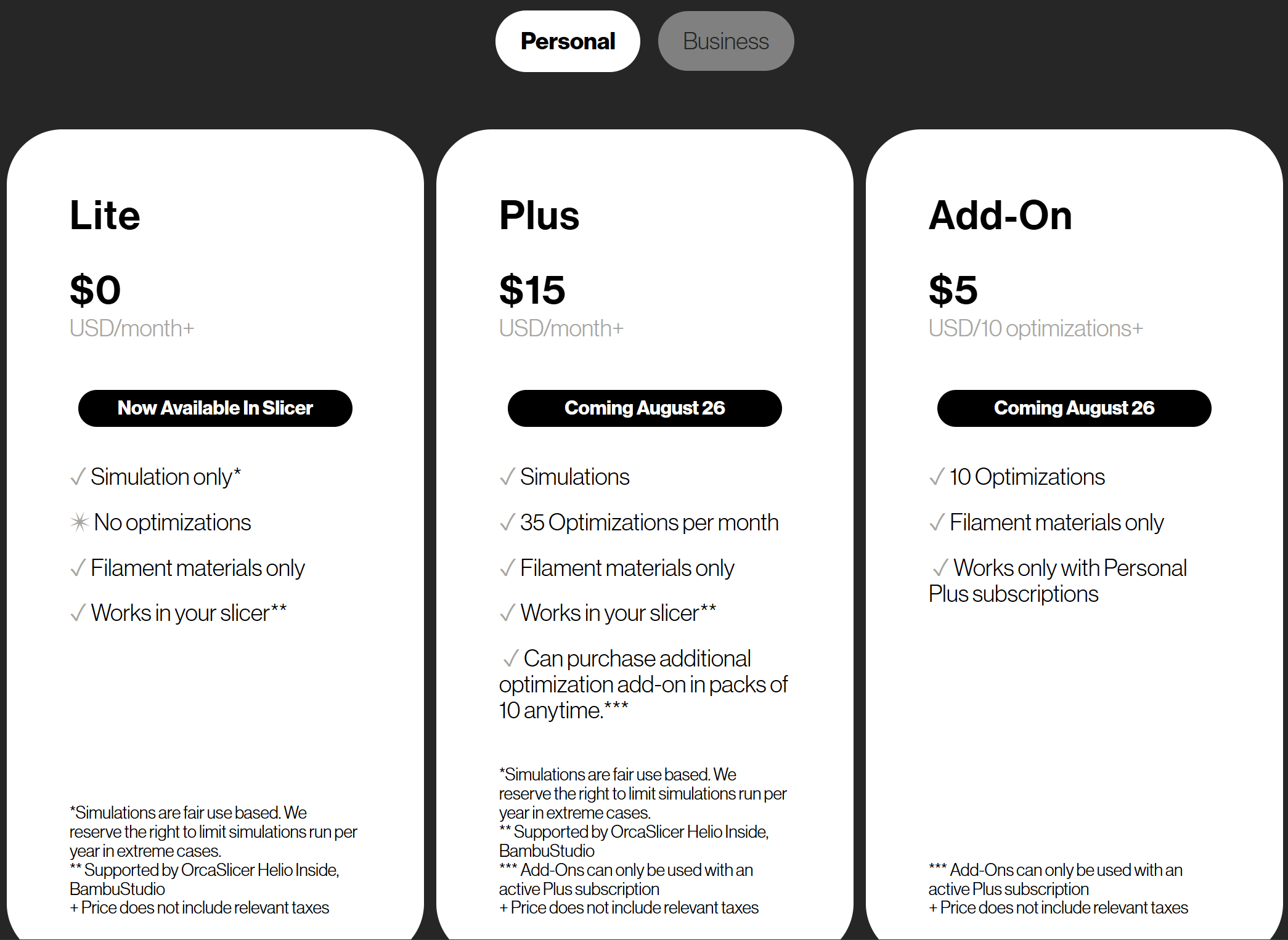

Seems the pricing has changed:
So simulations in the Slicer seem to be free, as soon as you want optimizations (not available yet in Bambu Studio) you would need to pay.
Those prices look fair if you really can have benefit from them.

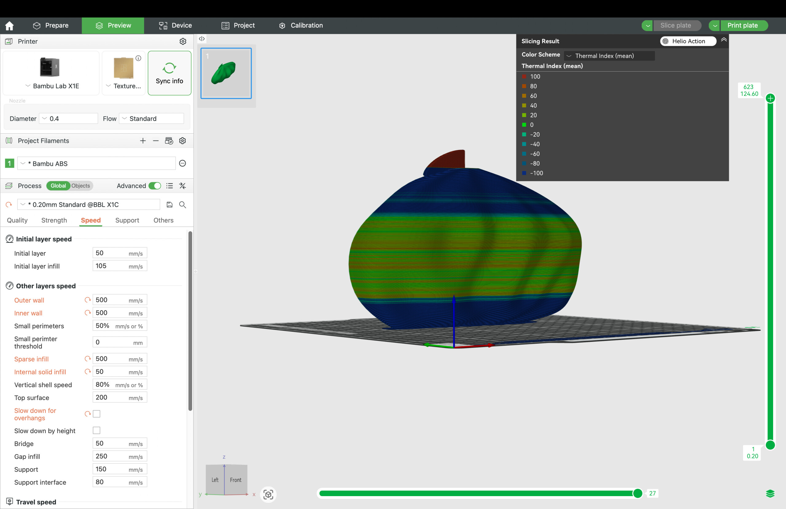

I assumed it was only available in the Beta Studio, but it looks like the new version of Studio was released and its on it so download the update, enable Helio in the preferences, and give it a shot. Basically, green is ideal temps and blue and red means its too cold or too hot for good bonding (too cold) and good esthetics (too hot). I’m trying to figure out what value it has for determining warping ahead of time.
