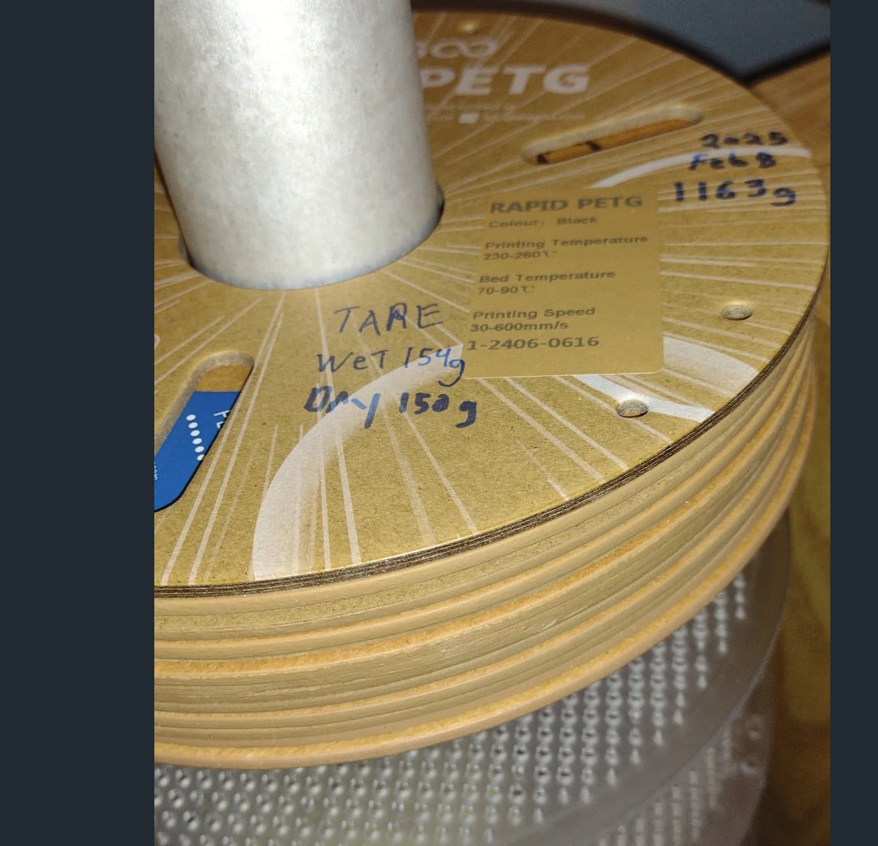

While that’s true for paper spools, it doesn’t change the underlying fact: without specialized equipment, the only way to estimate moisture—whether in the filament or the cardboard spool - is by tracking weight.
Side note: for every filament brand I use, I dry the spool and record the before-and-after weights directly on it, along with the open date and initial weight. I then tear off one side of the cardboard spool for recordkeeping. These samples are stored in a stacked column for tare weight comparisons and serve as an archive. While this doesn’t distinguish between moisture loss in the spool versus the filament, it remains the only practical method for estimating moisture removal. If no weight is lost at proper drying temperature, you can be reasonably confident that neither the spool nor the filament contained moisture - which is valuable data in itself.

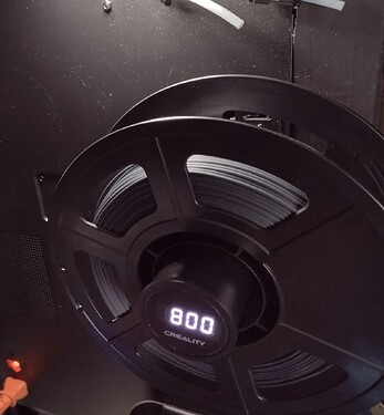

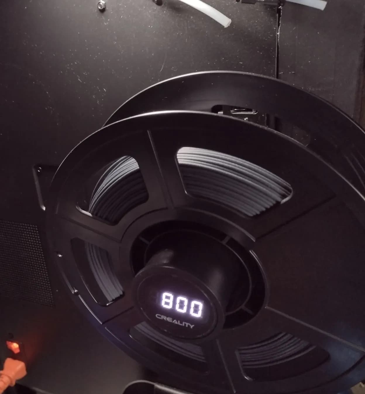

I have a supply of complete empty spools also that I use to zero out by Creality spool scale too which I adapted to the P1 spool holder socket.

That is my standard procedure. When I unseal a bag, I write the gross weight on the spool. If I have empty spools from the same vendor, I compare their tare weight to the gross weight of the new spool - less to verify 1KG and more to track moisture.
For hygroscopic filaments, I always put them in the dryer and note the gross weight on a sticky note placed on the dryer. I recheck after about four hours if it’s during the day, or overnight if I start it in the evening. If there’s no weight loss, I can be reasonably confident the spool was moisture-free when sealed.
To answer your question, if memory serves, only Bambu Lab Silk and Matte PLA and Kaaber PETG were out-of-the-bag culprits with wet filament. Drying remedied all issues.

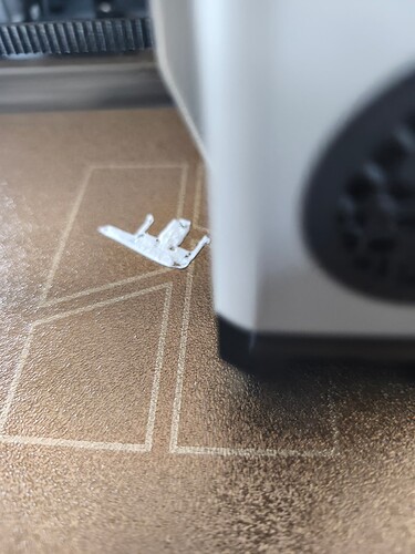

Thanks everyone for all your responses! After a few problem-free tests with Recreus TPU, I switched back to PLA, and now I’m not sure what I’m doing wrong. It’s impossible to get a correct layer with PLA…
My wild guess, cross plastic contamination. Like, your plate now has a very thin layer of TPE and you are printing PLA on top of that.
Omg, thank you! I cleaned my plate with isopropanol and now everything looks cleaner. It’s not perfect, but it’s much better.
Get a nylon scrub brush to use on the build plate.
