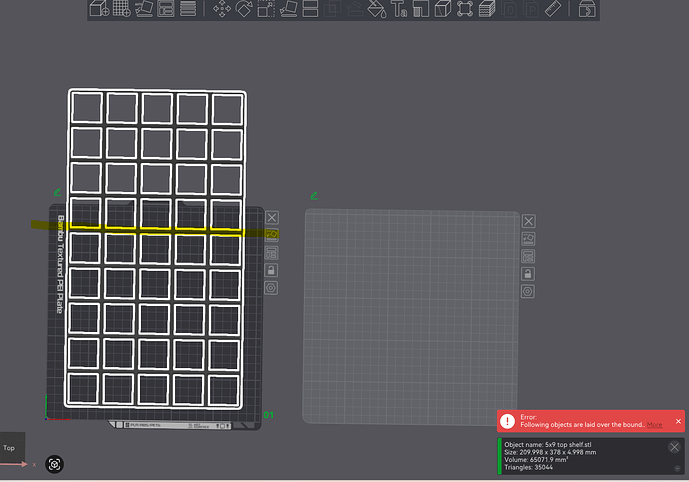

New to the software, But I have been playing with Gridfinity, I’ve made a base, but I cannot figure out how to cut it so that I can print. I am trying to seperate where I have the yellow high light, but not having much luck. Could someone explain, or lead me to a video that might help out. I’ve tried youtube, but obvisouly I am missing somthing.

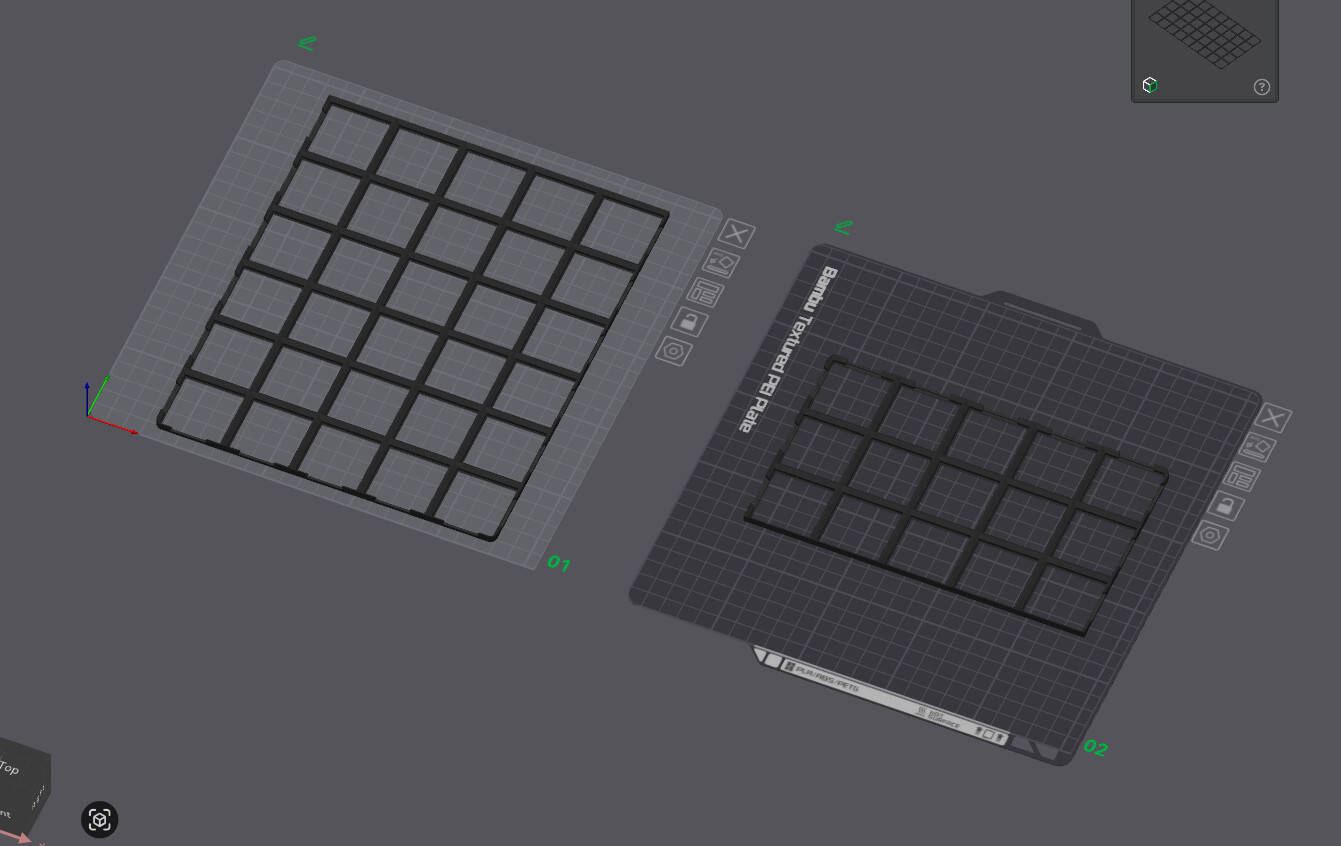

All the cut options:

I was trying this but it seems to slit the base plate into a upper and a lower. When I clicked on perform cut, it seems to dublicate the base plate, this is where I’m getting a little confused on how to cut
Sounds like you need to rotate your cut plane. The video posted above walls you thought each step. If you uploaded your .3mf file it will be easier to show you.
JonRaymond, BINGO that was excatly what it took, Figure out how to rotate the plane.
Thanks Everyone for the feedback…
