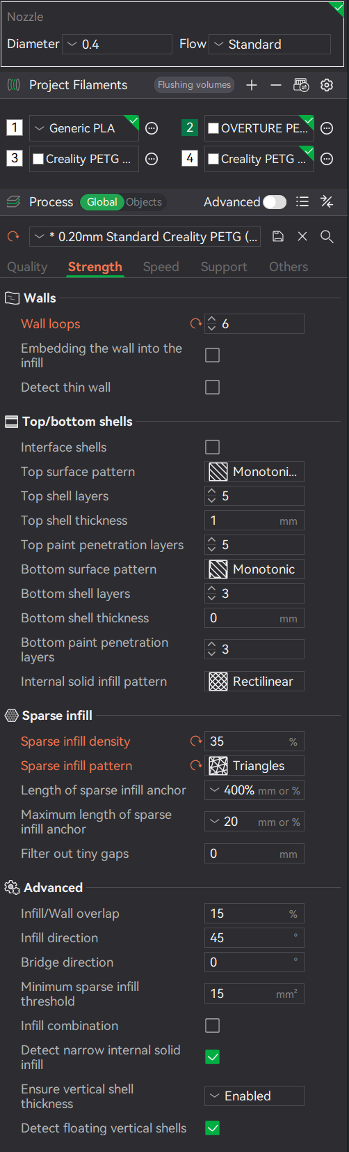

Ive veen trying to calibrate PETG for prints in my X1C. The sad thing is I had my settings dialed in which I pulled from various postings around the interwebs.
I was finally able to get my items to print to satisfactory levels (functional prints for my grow tent/hydroponics).
But i loaded a new project and like an idiot chose not to save my settings.
So yesterday i started over.
Ive done everything from flow dynamics, line calibration, temperture towers etc etc and had that dialed in.
I ended up with my best print yet (Barinna t8 light clips) akd everything went perfect. My previous prints had one side slightly warped but was god enough to use. Today i printed that same part and to my surprise i told myself wow ok, weve got this thing dialed in.

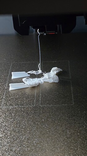

I went to print a different part and ended up with spaghetti printing - i was so confident it was going to work - but it didnt. So now im back asking for help.
Ive posted photos of my settinfs etc hoping to get some direction.

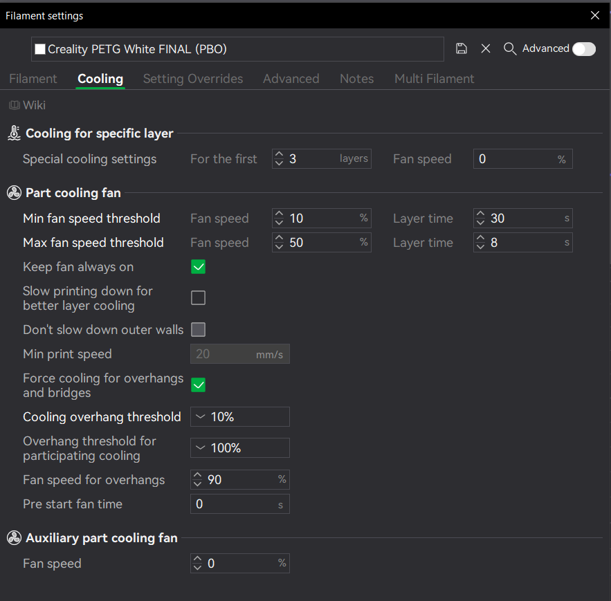

Things ive messed with - nozzle temp, bed temp, setting the k value, adjusting cooling settings (this is the hardest for me), set flow to 10mm3/ms, settings over ride.
Based on my settings can someone give me some guidance?

IMO this is “uncommanded extrusion”. Filament oozes out in a wavy, irregular noodle because the pressure that’s driving it is low and variable. The drive motor isn’t running. The pressure that’s driving filament out is moisture in the filament. You listed all the things you tried, and none of them included “drying the filament”. I would speculate that this is the problem.
I print a lot of PETG. Getting good clean prints depends on doing a good calibration for flow and PA (run the manual cals, not the automated ones), and making sure it’s nice and dry. If it’s not nice and dry, you won’t be able to do a good flow and PA cal.
With PETG, any excess flow tends to build up on the nozzle. After a while (depending on how badly calibrated the flow is), a nice big blob gets left behind on the print. It cools off and solidifies and the next time the nozzle comes around and hits it, it rips up what’s been printed (if it’s the first few layers) or knocks it over (if it’s tall already).
Give drying a shot, and then do the manual cals for flow and PA, before you start working on the substantially more comprehensive reply that’s above mine in this thread. :slight_smile:

The reason I started to deep dive settings is that I dried my filament and the results were horrible haha. If you see on the left side of the photo you can see the support tabs end up printing really well, and then when it comes time to print the actual item it starts to spaghetti.

It sure looks like wet PETG to me…
Do you live someplace with high ambient humidity? A typical heated dryer can only get the filament as dry as the ambient air.
If the nozzle just sits there, heat on, does filament slowly ooze out? If so, your drying was ineffective.
Thanks for the response. No its quiet dry where i am at the moment. The basement is around 35% the AMS is 10% consistantly.
The nozzle does not ooze unless there is left over filament dried to it which i pick off. I did a temperture tower which resulted in 245 degrees as the best result.
The long droop line you see is because i stopped the print when i checked the camera, thats all.

I then attempted to print the model I linked, and had a failure. So I went back to change my settings and slowed down the print speed and also reduced cooling a little bit as well as changing the temp plate up a little bit.

  1. After Calibration, I finally attempted to print multiple things by layer rather than by object. This was done with the settings shown in the photos. These are basically light hangers for my grow lights (T8 LED lights) for my hydroponic lettuce. It came out great I was super surprised. No slight warping as last time printed perfectly. No stringing blobs or anything.
Time lapse of the print
So now that everything has been going well I thought I’d move onto the big challenge i’ve been having (The link above). I’m assuming its because it has overhangs and is printed at a 45 degree angle, on top of me not having speed and cooling dialed in (something I still find confusing)
  1. I start the print with the settings show in the photos and it starts off well, and then I noticed part of the piece gets knocked over and starts stringing so I stop the print.

    Cooling:
    Min - 20 layer 20
    Max - 40 layer 10
    Aux: off
    Slowdown Print for better layer cooling off
  3. So with these new settings I printed again and here is a video of the print going wrong

Here is the piece getting knocked over and stringing

If anyone finds this thread.
I found what did it for me.
Slowing prints down alot (under 150ms)
Printer Cooling set to 0% min to 20% max
100% Aux fan and 100% chamber fan by adding this gcode to the starting gcode
“M106 P3 S255”
First time ive been able to have perfect (almost) PETG prints printing multiple objects.
