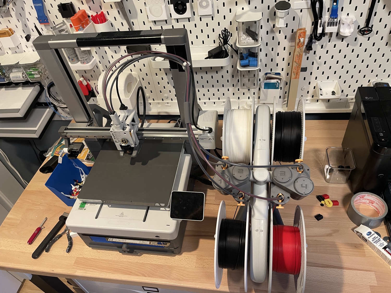

Is anyone else having the issue of the AMS tubes getting stuck behind their A-1 printer? My AMS sits next to the printer and every few prints has the tubes moving behind the printer and getting stuck when the printer head makes a big move. I’m trying to find a way to prevent this. I’ve had the filament hub ripped off a few times from this.
I’m hoping someone has ideas how to stop this from happening.
Here’s my setup. Hope the tubes are visible enough. For some reason they have a bend in them that makes them quick to jump behind the printer when given the chance.

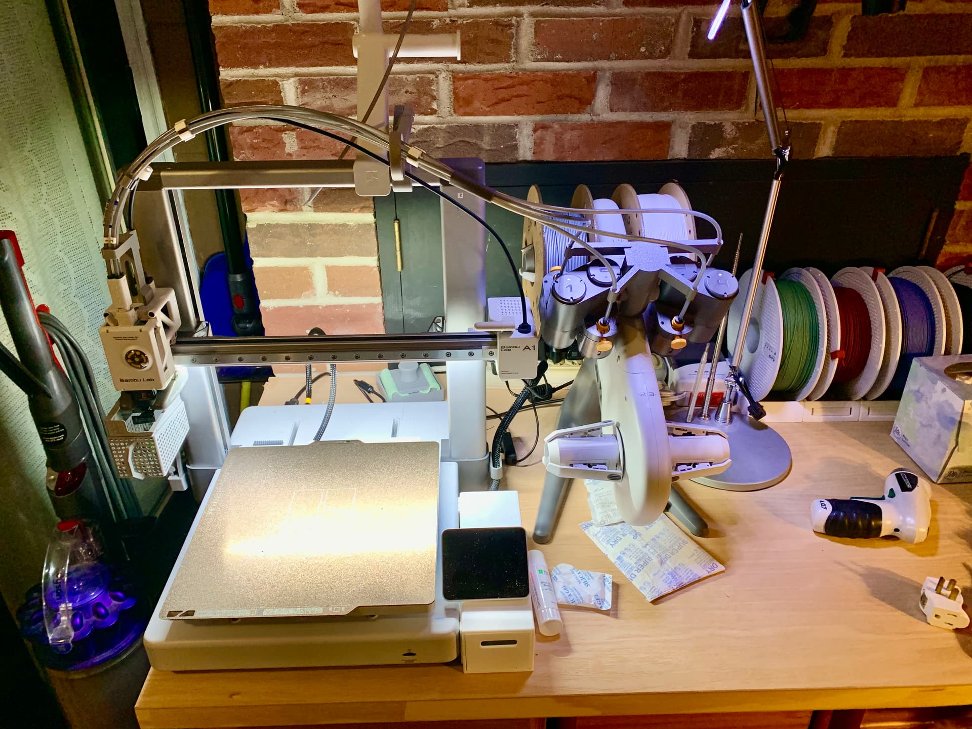

Back when I had mine (sent back during the recall), my tubes were more like the photo I provided.
This can party be achieved by better placement of the PTFE holder. Moving it closer to the print head gives it a more upward direction.
The aim is to have it projected upwards so the top bar does conflict and it can’t droop down between the top bar and the x-axis.
You will also notice the product shot doesn’t have the sleeve-like wrap you have close to the AMS lite. That is some to consider as it frees pressure on the cables that having it installed can cause.
If your PTFE tubes have a now permanent droop, you consider purchasing a length of it and cutting it up to swap out for the ones on your machine.
Thanks! I will try to get the tubes into that position. I have some extra tubing so might replace them. Unfortunate for me now I have to troubleshoot a communication error to the tool head. Likely caused by the tubes getting caught again and ripping off th top of the 4 to 1 splitter. Thanks again for the tips!
