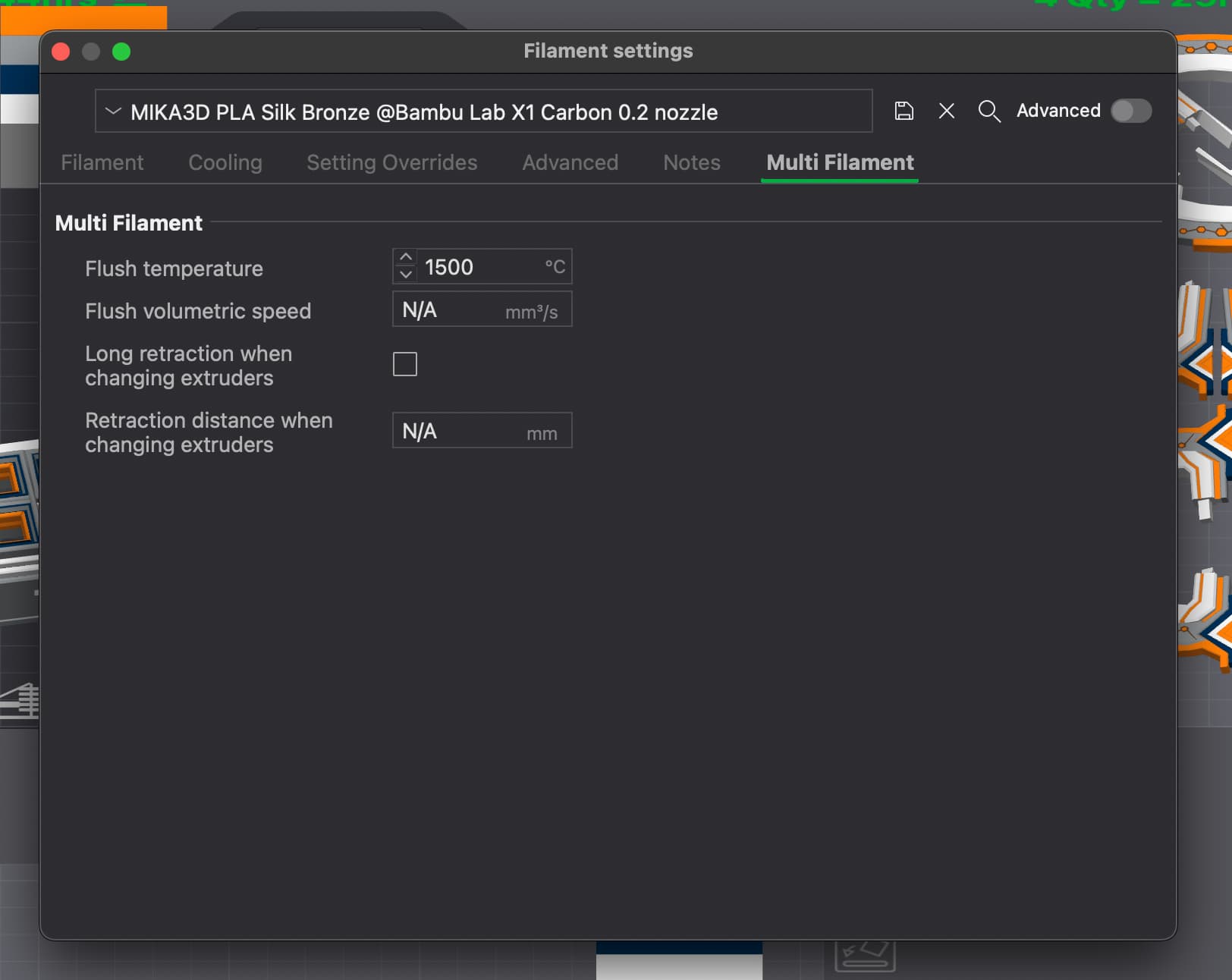

After bringing my STEP model in (just a round coaster with heart), I colored the file (2 colors). When I saved the project and later brought it back in, it gave me the above error with:
"filament_flush_temp: nil,0,0,0,0,0,0,0,0 not in range [0, 1500]
Please correct them in param tabs.
Any reason for this, and how do I fix?

Some additional investigation info: While I am not using it on this print, I have SUNLU PLA High Spped filament and TECBEARS PLA Basic loaded. If I look at their parameters on ‘Multi Filament’ tab, it shows ‘Flush temperature 1500 C’ for both. All my Bambu filamnet has a value of 0 here.
I have not found the ‘nil’ value that shows up in my error message.
I am experiencing this also. I change the ‘flush temp’ to 0 and it goes away. It is very annoying. Hopefully, there will be a bug fix soon.

Setting the Flush temperature (under Multi Filament tab) to 0 seems to fix the error. I checked all of the Bambu filament presets and they are all 0.
I also had the problem and setting the multi filamant options to 0 it went away. But now with the new BambuStudio 2.1.1.52 the error message is back but now you can’t change anything in the Multi Filament tab.

I just updated Bambu Studio and am seeing this error but the option to change it is no longer in the Multi-Filament tab. What is the solution?

What I would do is downgrade to the previous Bambu Studio version, go through each and every one of your custom filament presets, and change the flush temp to 0 (and one right below it, I forgot the name). After you have done all of that, upgrade BS to the latest version 2.1.1.52 and there will be no errors. That’s what I did.
Just edit each filament and save it - that should be enough.
