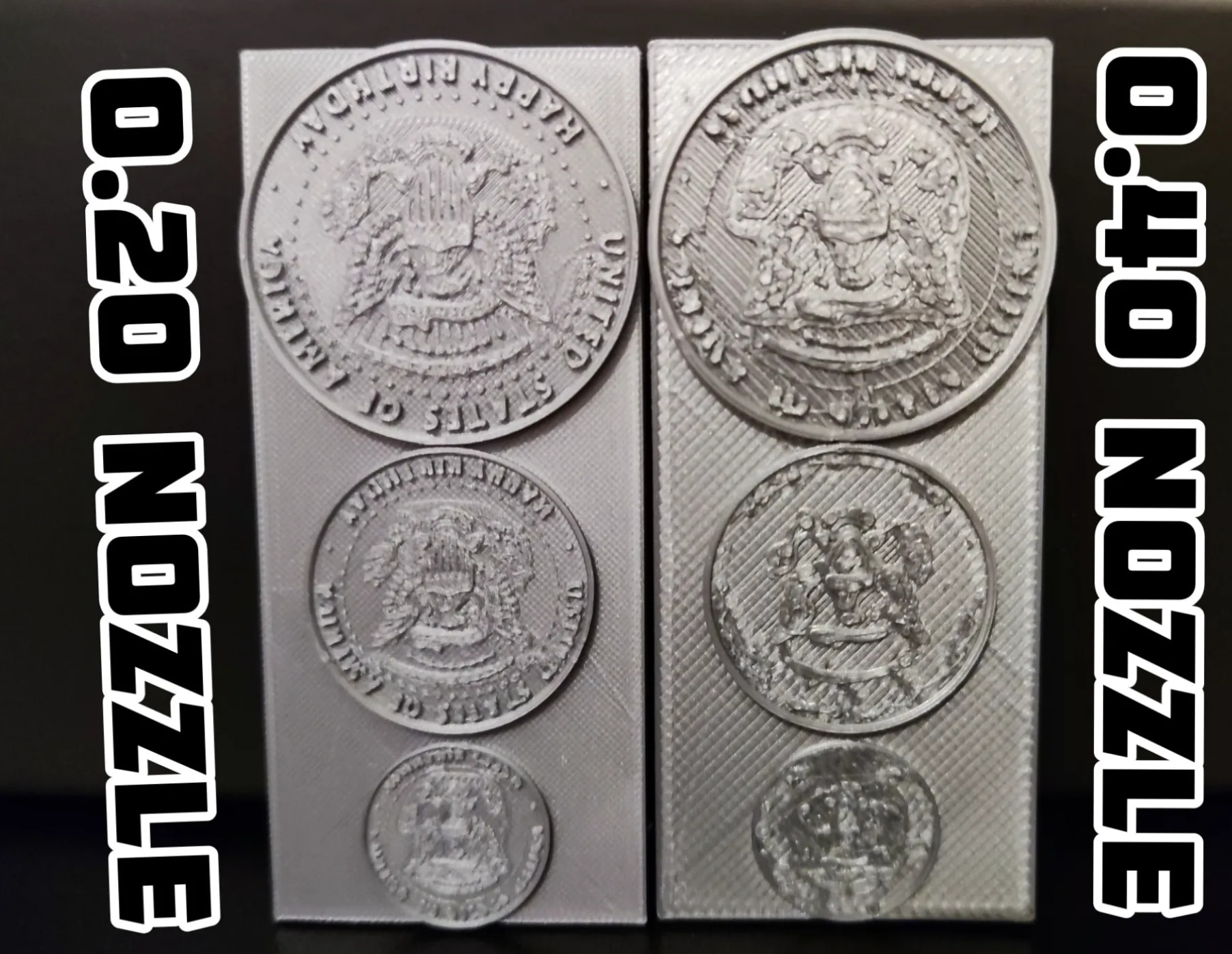

The logo has an extremely high level of detail. You’ll definitely need a 0.2 nozzle.

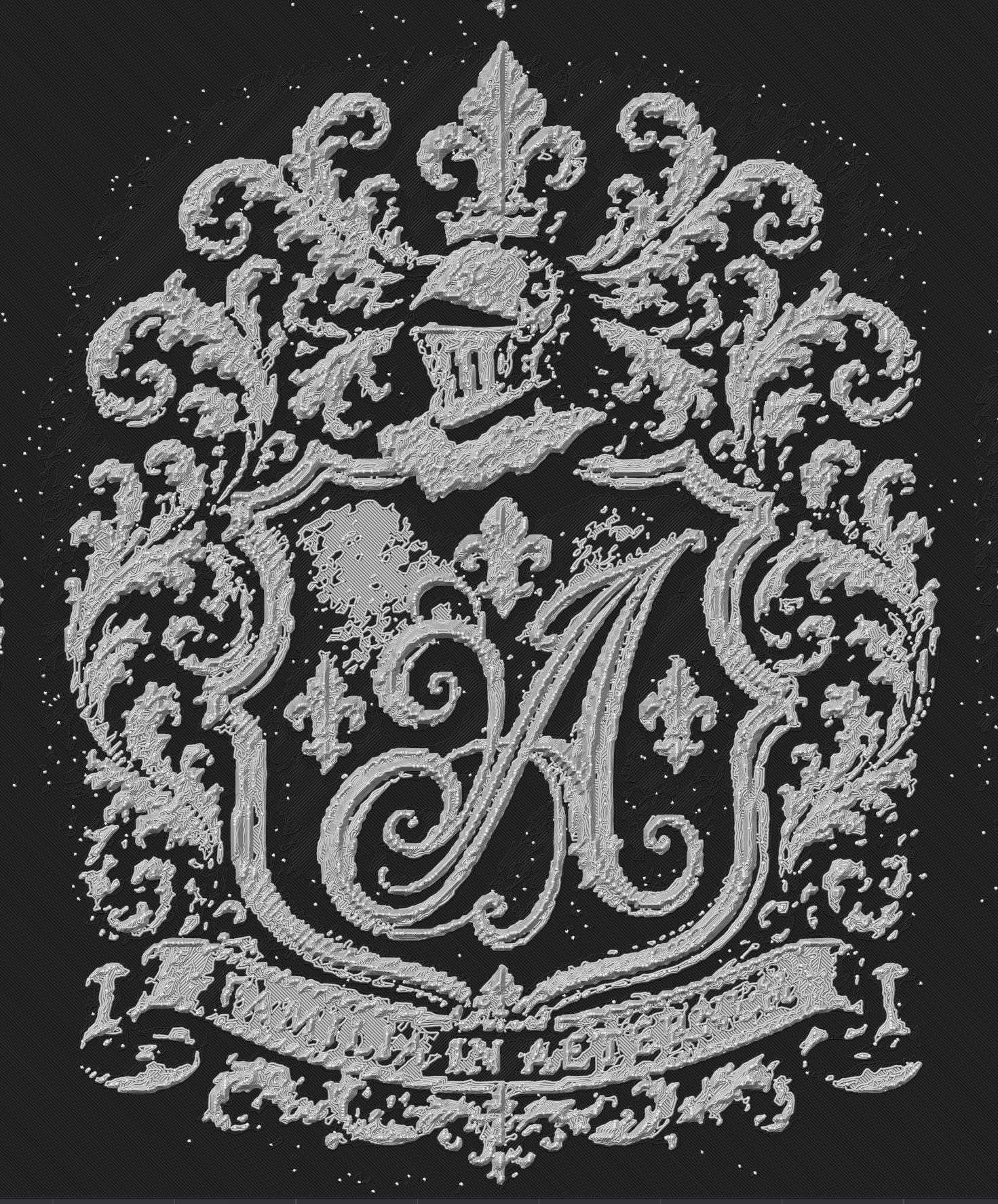

One option is to convert the logo using BumpMesh. But I’m not sure if that’s what you want. If you want a complete 3D logo, it’ll be difficult - you could try AI, but it won’t be able to reproduce the details.

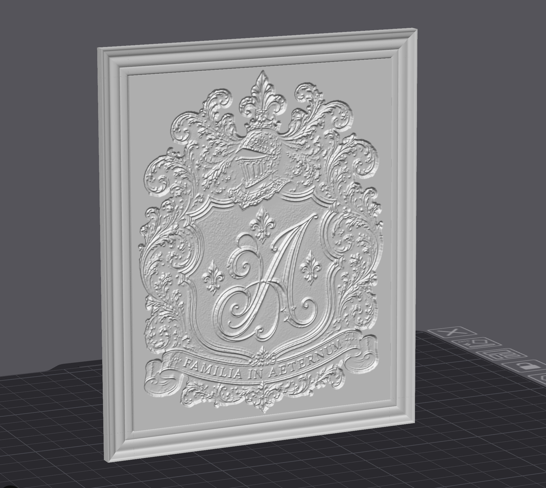

Here’s the result using BumpMesh: Slicing with a 0.2 nozzle. I don’t even need to show you the 0.4 slice - you can hardly recognize anything.
There’s certainly room for improvement, but even a 0.2 nozzle will eventually reach its limit.
If you really fill up the entire print plate, you might be able to reproduce the details. The best thing would actually be to design the whole thing as a vector graphic in the first place.
