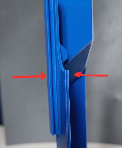

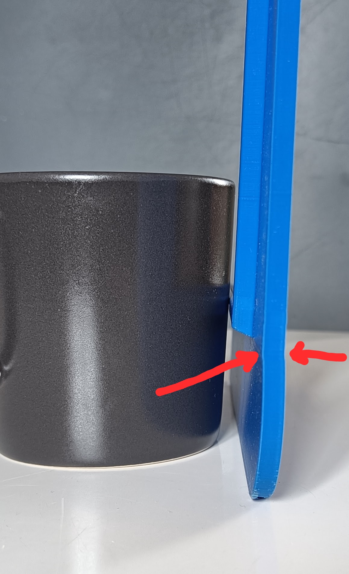

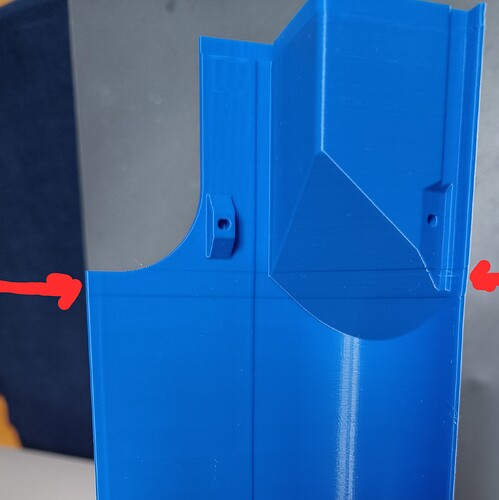

For some reason the last 3 parts has had a strange skewing.
Seems to occur when printing overhangs, the entire section gets skewed and misaligned.
First I thought it happened at a specific height since I saw at 2 different pieces at the same height but then I printed a small test box a bit higher than where I saw the issue on the other 2 parts but it looks perfect.
Third piece, lots of skewing but much higher up in the print.
Could it be a support issue?

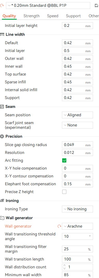

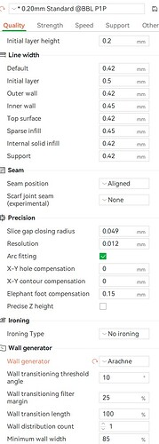

Filament is eSun PLA, Pic 5 shows setting, only change is Arachne.
About the pictures, top and bottom pics are same piece. Pics 2 and 3 are different pieces but same issue. Pic 5, basic settings

It seems that you have lighly shifted layers. Did you check if your belts are well adjusted?
Thanks for feedback!
Do I test them using the Automatic Calibration?
Or should I just do the XY tensioning procedure and then do the automatic calibration?
Check the tension, and if necessary do the XY tension procedure. I use one of these devices to check belt tensioning. It’s cheap and make the process easier.
