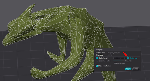

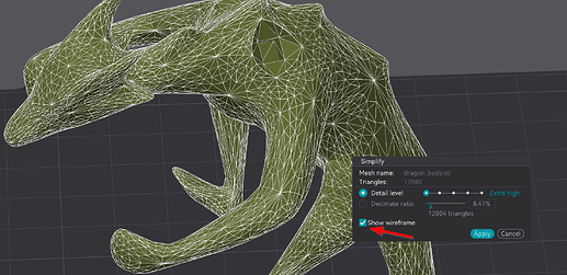

Hi all
so I got this head, part of a larger project. It’s hollow, there will be cables passing through. Bambu studio sees the object right, just like designed and exported in Blender, but refuses to slice / print the hollow tunnel and completely fills it with infill.
Is there a setting I’m missing?
Thanks!

Can’t see it clearly in the first pic but looks like some wall issues at the bottom of the hole, unless this is a spare out area for a snap fitting or such.
