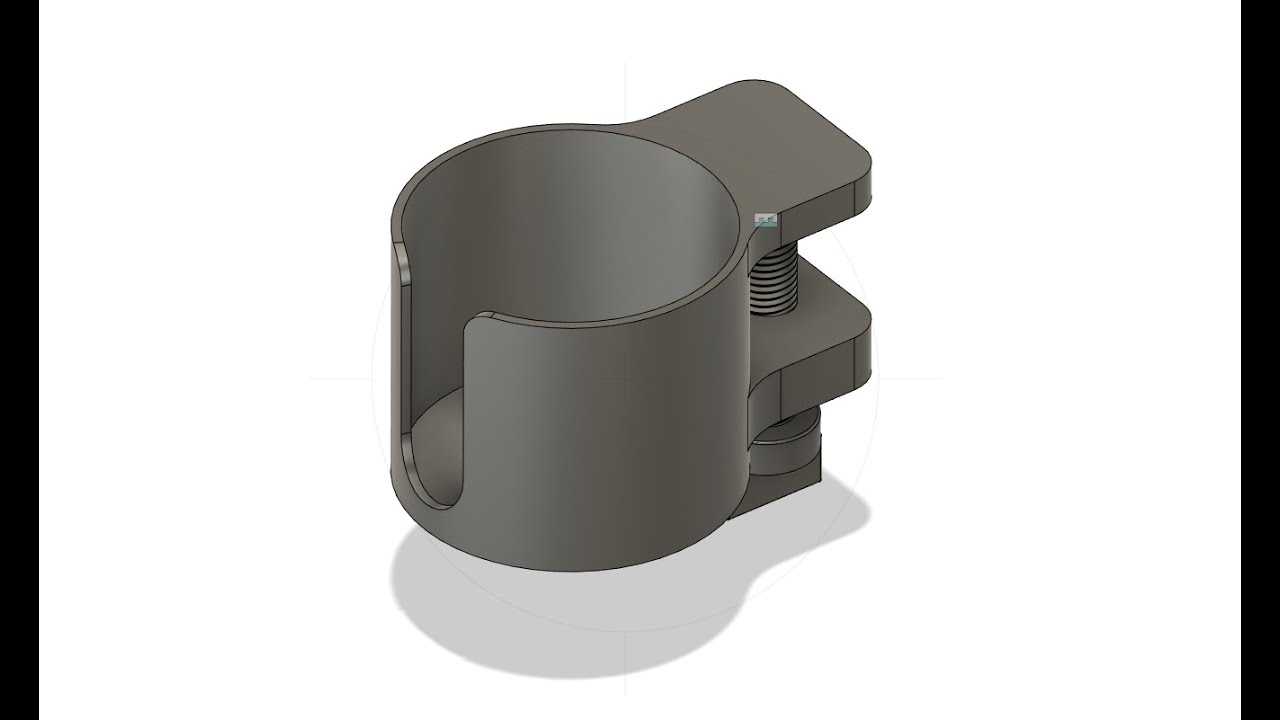

This is the original: Pinball Coffee or Can Holder - Free 3D Print Model - MakerWorld
And this is mine: jazcup - Free 3D Print Model - MakerWorld
The main issue I need to fix is that when I adjusted the size of the original print, it also stretched the mounting holes as well as moved them slightly more apart so now don’t mount as intended nor do they allow the bolt to fit through the holes.
Can some help me please on how to keep the mounting hole section exactly as it is while ensuring my model is achieved. Even if someone on here is smart enough to fix and send to me.

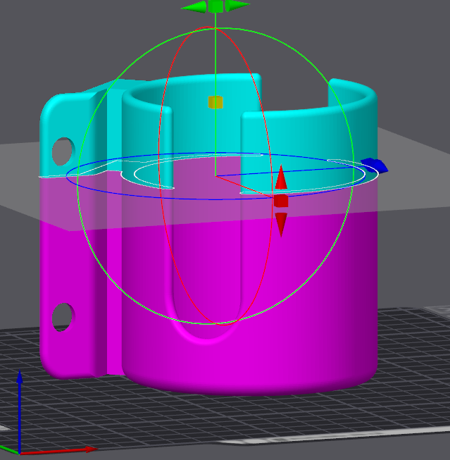

Clever use of the cut to parts tool can usually work. Instead of stretching the entire model vertically make 3 sections with cut-to-parts and stretch only the middle section:

Yeah pretty easy. Just move the top portion up vertically, stretch and move the middle segment, leave bottom segment alone.

moonrakerone has already pointed in the right direction, but I would cut it differently:
On the left is the actual mount, and on the right is your cup holder. Then you can adjust the cup holder to be as big or as small as you want.
Sure, it’s not perfect. If you want to do it right, you’d have to design it in CAD - ideally as a two-piece assembly from the start: a mount and a cup holder that snaps into place.

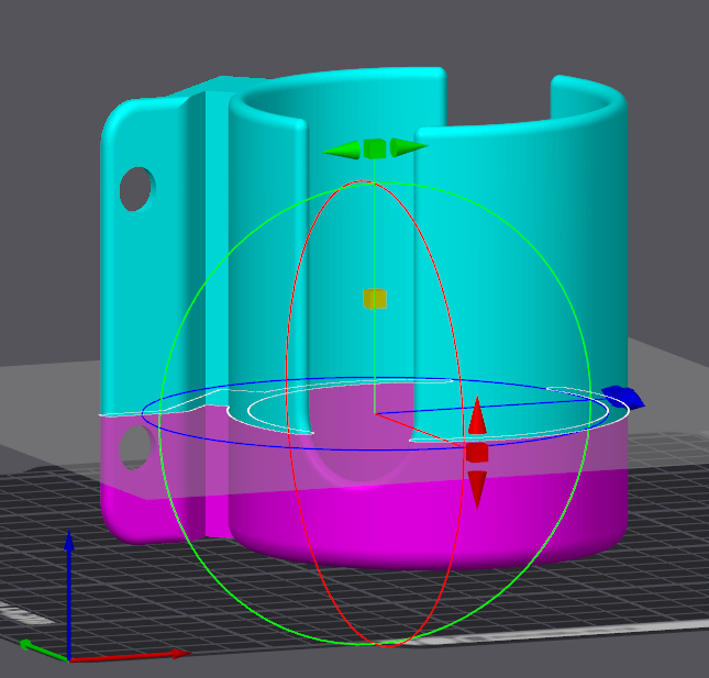

Thanks. I also cut it the way you did. But when extending the cup, I found that a flat section of the handle would remain above the handle. As opposed to being round like the rest of the cup.

So really dumb question. I did the cut down the handle.
Went into slicer and then joined the parts…they still looked to be two separate parts so i merged them? Is that correct?
Presume when slicing the cup it will print as a whole piece that is joined and seamless?
That’s right. :grin: :+1:
