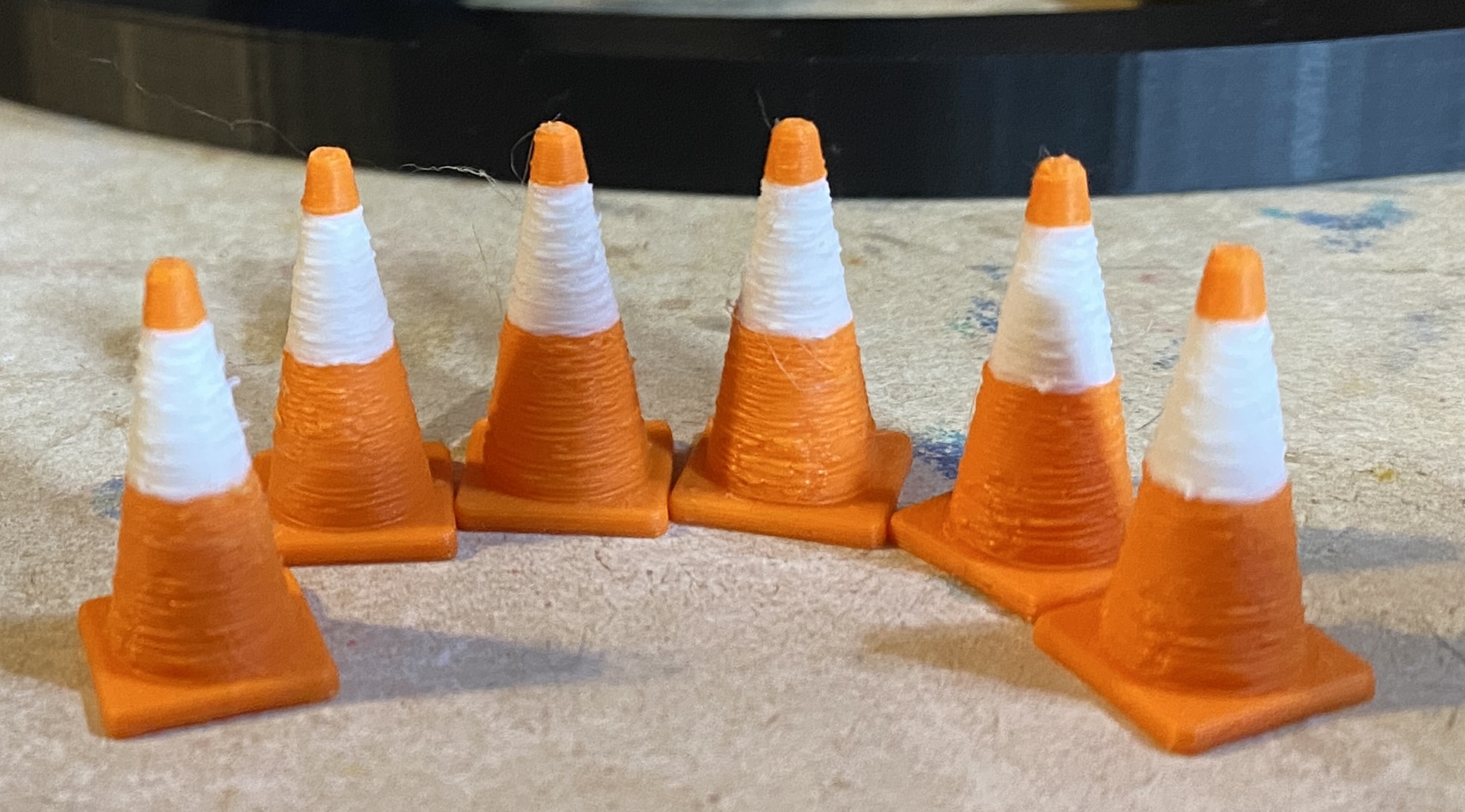

Help refining this tiny print?
I
I am guessing these little bumps are End of Layer issues? The filament wasn’t wet. No hissing or steam present. Z issues? What can I do to smooth them out? They are much worse in the small version (top photo 50%, bottom photo is 100% size from file.)
My printer is P1P upgraded path to P1S.
Seam position aligned. I plan to change it to random.
Seam gap 15%
Seam scarf checked.
Angle threshold 155
Scarf around entire wall unchecked
Scarf steps 10
Scarf joints inner wall checked
Wipe speed 80%
Role-based wipe speed checked
Slice gap closing radius .049
Resolution.012
Arc Fitting checked
X-Y hole compensation 0
X-Y Contour Compensation 0
Elephant foot compensation .15
Precise Z height unchecked
Filament Bambu basic jade white & Anycubic PLA+ Orange. Using Generic PLA filament profile.
The file used is Filament Freak’s traffic cone.
