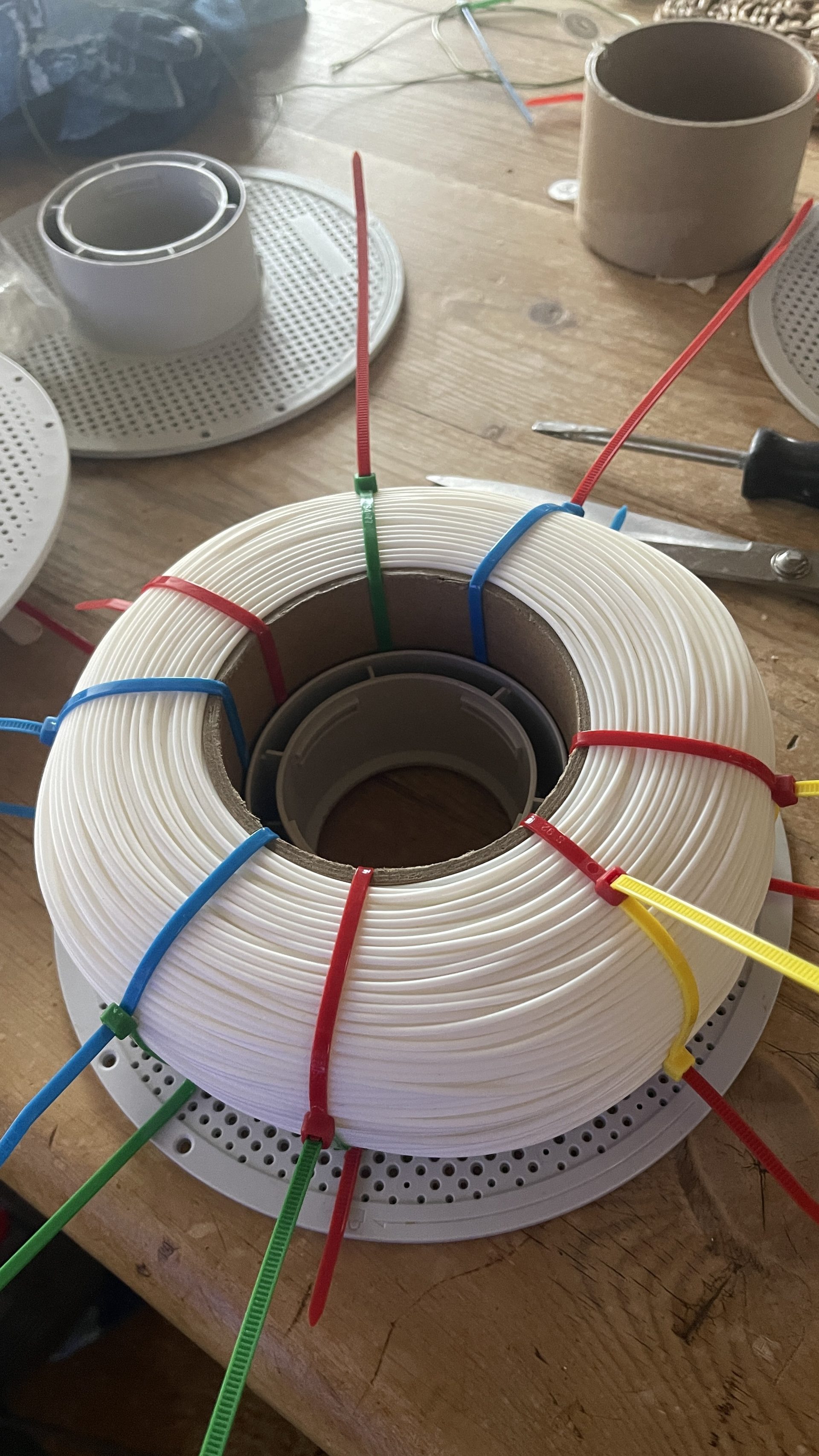

I made the stupid mistake of removing all the retaining straps from a Bambu filament refill before putting it onto the spool. Of course the whole thing immediately sprang out and expanded.
I’ve managed to wrestle it back into shape using some very tight cable ties (photo attached), so the filament is now pretty much contained within the cardboard core again.
The problem is the cable ties have to pass through the centre of the core, which means I can’t get the two halves of the Bambu spool together. If I remove the ties, the whole thing just springs apart again.
I’ve tried manually respooling it, but after a few turns it starts twisting/tangling and keeping tension on the whole thing is a nightmare.
Has anyone done this and found a clever way of rescuing it without respooling the entire roll? I feel like I’m 90% of the way there, but can’t work out that last 10%! :grinning_face_with_smiling_eyes:

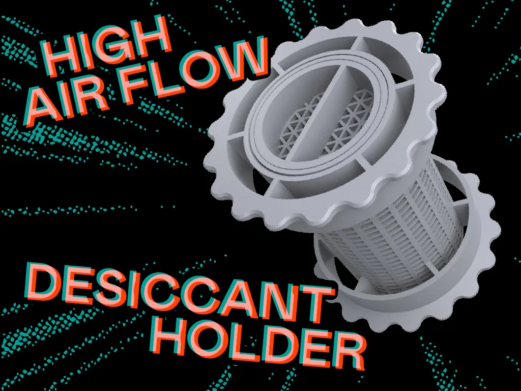

There are desiccant holders on MakerWorld that go in a spool hub that may be able to clamp two spool halves enough to allow respooling.

If the two spool halves aaaaalmost reach each other, you can use something like this with a threaded flange to hold the spool halves together - don’t bother filling it with silica, center spool silica holders are largely BS.
Ahh - yes - nice idea - I’ll give that a go. I dont fancy the respooling route - 350m ish of filament to respool by hand doesn’t seem worth $15 - $20 ish to just dump it and buy more. Lesson learnt :slight_smile:
Thanks both ofr the dessicant holder idea. That may well work as yes, they ALMOST reach - about 5mm off…

What you can do is put the upper half spool in pushing on your refill as much as you can. It won’t connect because of the added thickness of your zip ties but it will prevent the filament to unspool, you then cut the zip ties and remove them while you keep pushing and you should be able to connect both halves and rotate to secure.
